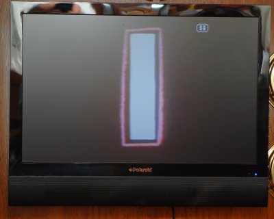

To accomplish this test I used our 19" Polaroid boat TV that runs on either 12 volts or 120 volts (not sold as such). What I really wanted to achieve was less "lab" or "theoretical" numbers and more "real world" on a device that can operate on both DC and AC and one that would give a steady output from which to measure. I could have used a laptop computer but any one who's used one knows that the current draw is highly variable and NOT at all steady. My Macbook Pro uses between 3.1 amps (with the lid closed) to 7+ amps depending on the software and program it's running. So a laptop was not used because I could not get a steady current draw from it.
To make sure my TV was consuming a fixed amperage I loaded a DVD into it and then paused it at exactly the same spot in the "Elmo" disc of my daughters. All other devices and charging sources were turned off including my solar panel. The Xantrex XBM battery monitor read 0.0 amps before turning anything on.
The on screen shot is showing the TV paused and running off of 12 volts DC:
Here is the Amp Load at 12 volts DC:
This photo shows the DVD paused in almost the exact same spot though this time it's running on 120 volts AC through my larger 1200 watt inverter.
And the amp draw! There is no trickery here and the Xantrex battery meter is not lying. Running this same exact TV on 120 volts AC through a 1200 watt inverter uses 5.8 amps per hour vs. 3.9 amps per hour!!
When compared to running this SAME EXACT TV on 12 volts DC the inverter has a 32.8% efficiency loss or a far cry from the 10% inverter inefficiency claimed by most manufacturers using very non-real word, not lab numbers..??
