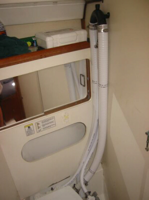

If you're planning to cruise 20 miles offshore, I'd put a y-valve in the head discharge line that provides a choice of flushing the toilet directly overboard instead of going into the tank. Use the tank only when you have to. And if you learn how to use the toilet's dry mode to do more than just remove the last of the water in the bowl, you can double the number of flushes your tank will hold compared to pumping all the way to the tank in the wet mode.
Meanwhile, the attached photo shows you where the vented loops need to be. The smaller hoses are the intake loop, which is nestled under the larger discharge loop.
