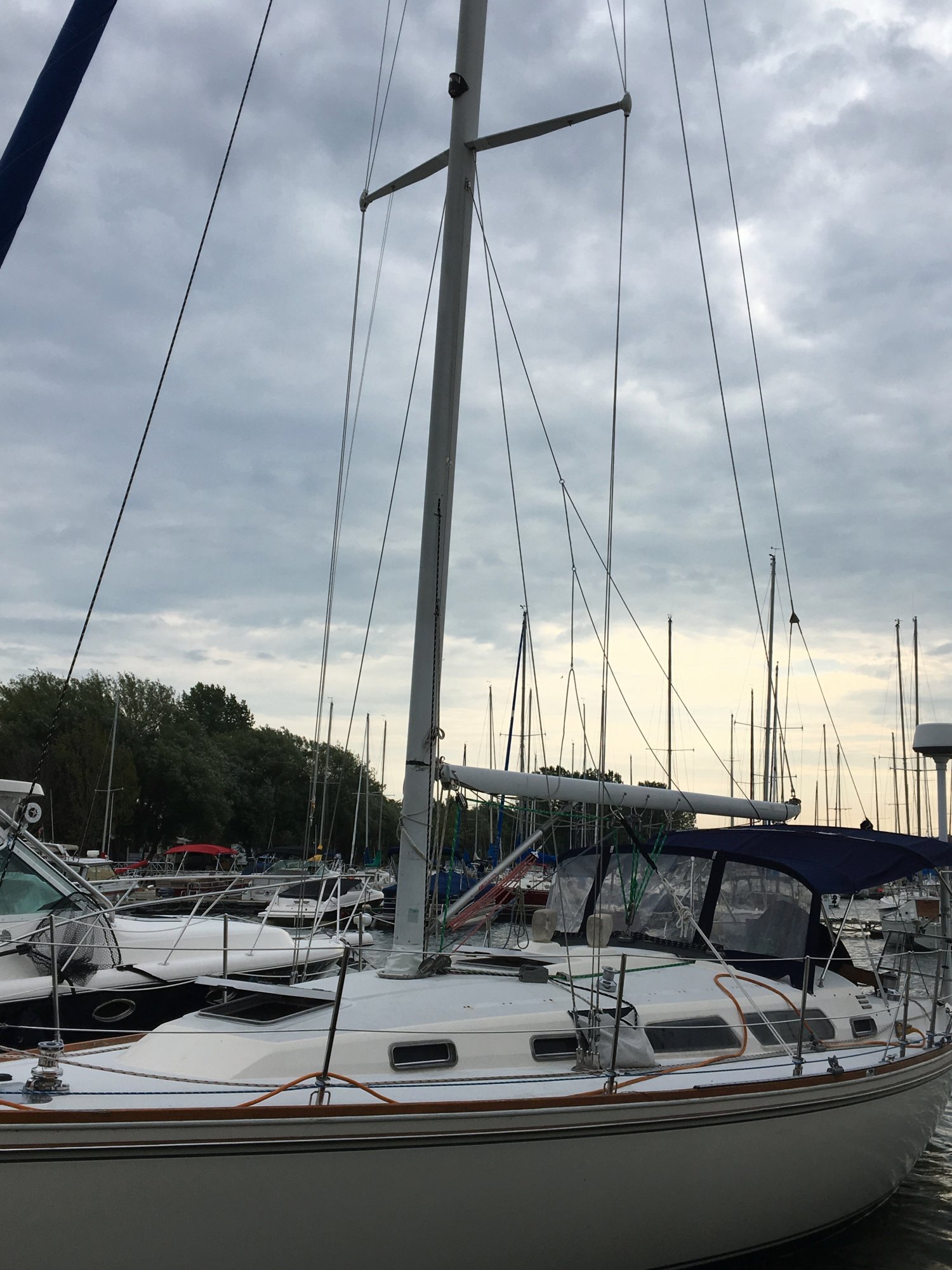

Mine are mounted above the spreaders, but on the mast.
Some people mount them out a way on the spreader to keep the sail from catching on the way up the mast.
4,798
Mine are mounted on the mast just below the lowest spreader. The line comes down to a cleat on the mast to allow the LJs to be pulled back to the mast while sailing.

The further out on the spreaders those blocks are, the more down force bending moment you place on them. The spreaders on my boat have ferrules in them about a foot outboard of the mast and blocks attached to the mast about six feet above the spreaders. The lazy jack lines are threaded through the spreaders, up to the blocks, and down the sides of the mast where the lines are cleated just below the boom. This allows a fairly straight line upward, and a throat opening wide enough to contain the sail.

My lazy jacks are attached to the mast below the spreader and are led to the cockpit. Prior to leaving the slip I remove the sail cover, raise the jacks and remove all the sail ties except that farthest aft. When raising the sail I pull the jacks down, snug against the boom, and then there is no problem of battens catching the jack lines.

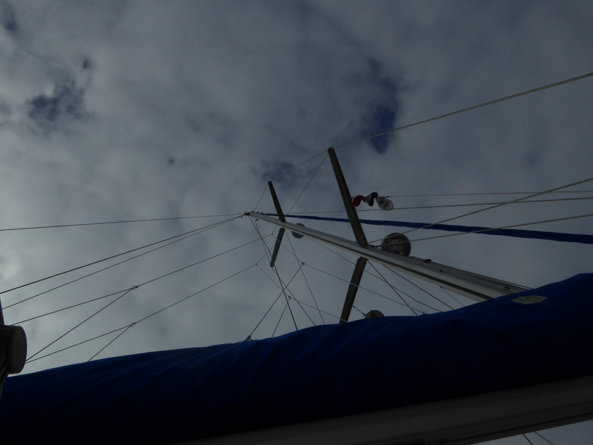

My factory lazy jacks go up inside the mast and exit a few feet above the top spreader. They then route through ferrules in the top spreader about a foot from the the mast to open the lazy jacks wider than they would be just from the mast. On the way down to the cradle cover, they split twice (3 2 inch stainless rings) and attach to the cradle cover in 4 places. There is a separate line for the front of the cradle cover that is all external, just goes from the front corner of the cover through a stainless strap on the mast and down to a cleat. I leave that one looser until the cover is zipped up.
