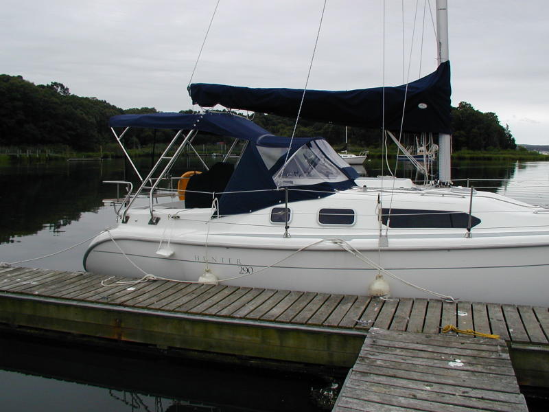

What I did was use shock cord for lazy jack lines which made them easy to remove them from the boom and hook them to sides of mast so when raising the main the battens don;t get hung up on lazy jacks which happens quit often. It lets me put my sail cover on much easier,the picture show's the lazy jacks off the boom and to side of mast,don't know if you can see them. I got the idea from sailboat show . nick
