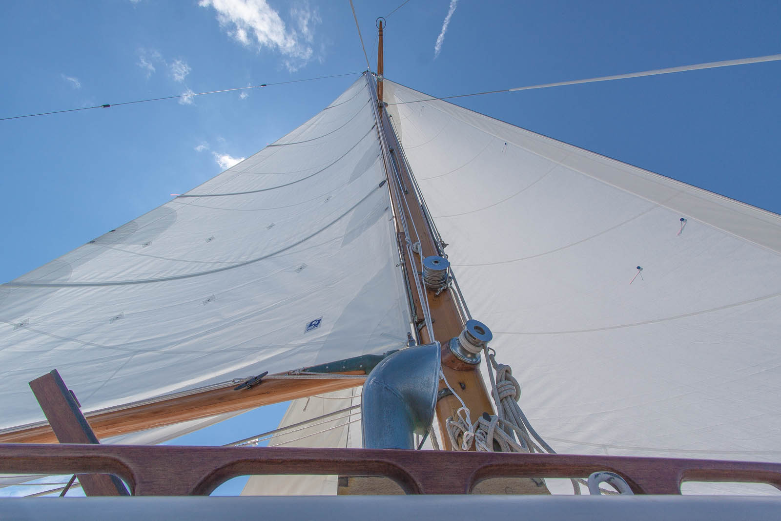

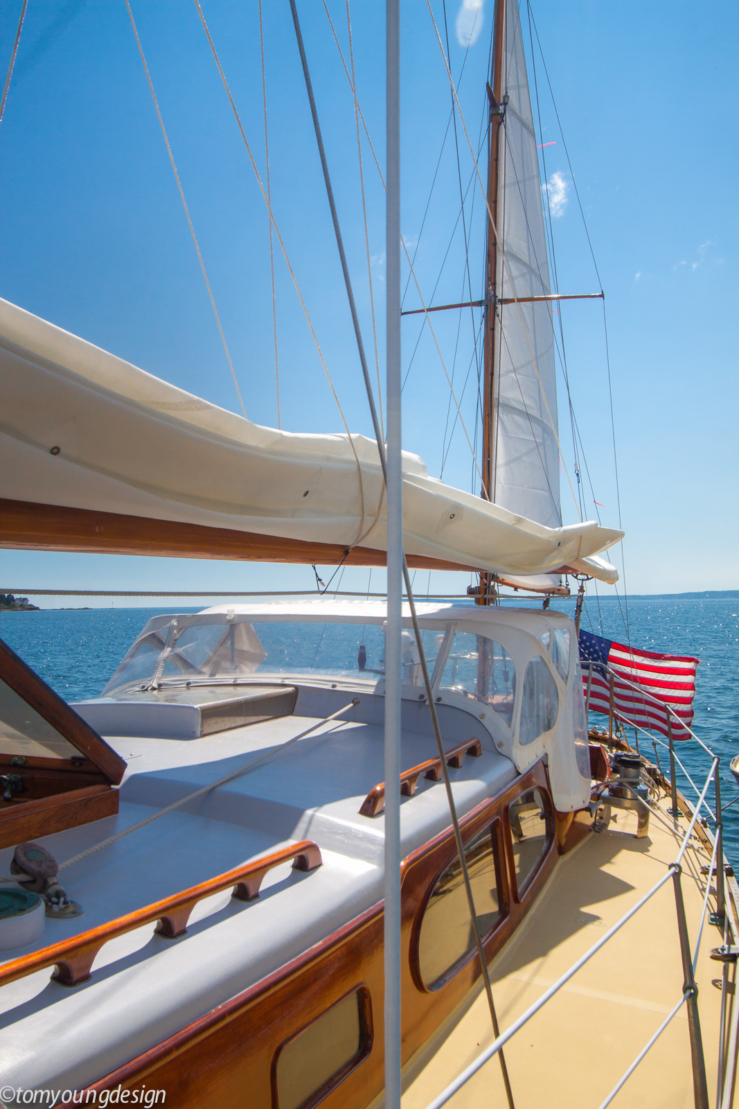

I made lazy jacks for my boat. They are a huge help with a mainsail that is hard to furl, alone, especially.
Pretty simple; a block above the spreaders(more effective than located at spreader height), 3 eye straps per side on the boom and a small cleat on each side of the mast. Deployed, there are 4 legs per side because of the 18' foot of the mainsail.
I can 'usually' get a pretty good flake lowering the sail, solo. However, in any weather the jacks make it easy to drop the main without blocking the helm.
With sail ties loosely containing the sail, the jacks are then thrown off at the mast cleat and gathered, pulled under the cleat, and tightened to the mast. You can leave them up but I find the jacks make it too tedious to raise. Here the jacks are gathered and cleated at the mast.
