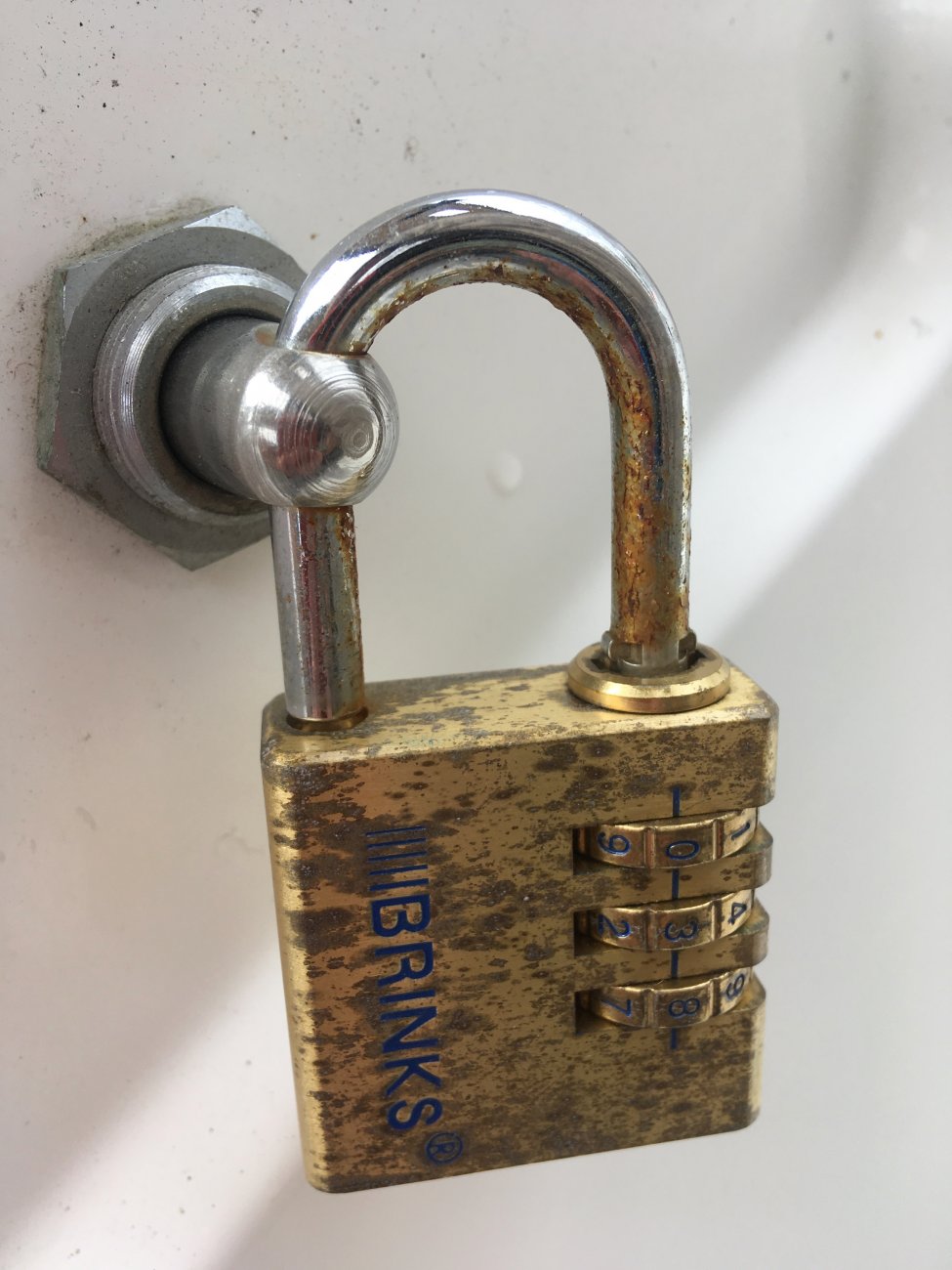

Anyone found a decent padlock that wont rust out after 6 months in the salt air? An ongoing problem for me, as few padlock that seem strong enough will fit the relatively small opening on my Beneteau 373 latches. This one pictured is a Brinks 161-40051-6, supposedly for outdoor use, but the shackle rusts quickly. Also note that the shackle is too thick to hang loosely in the latch.

I use these small totally bronze padlocks. Forget the brand name but they are sold many places. The key (no pun intended) is all bronze. I have them on all my lazarette hatches and they are all fine after 11 years. I give them a squirt of wd-40 once a year or so.

ABUS (or Asus) hard to read the key. 32 years old. A little 3:1 oil every decade or so. :)

I ordered up a six pack of abus all keyed the same. Got one key per lock so we could spread them around. A little bit of lube and they are more than ten years in service

Spray your lock with a good dose of Corrosion Block. I have had a cheap master lock on the boat for over a year. Key slips in and out. No issues. Lock still rust free.

Could a cable style lock be used through that small opening in the pin? The style of closure seems designed to prevent tampering, but unless the pin and its opening were larger the lock will need to be rather small. Maybe that is an idea to pursue......use a larger pin and circle. If you don't want to alter the closure and if you are satisfied with the lock style you are using, perhaps the rust retardant ideas mentioned are a good choice.

+1 on Abus, no issues in salt environ, we lock companionway only, lazarettes secured with carabiners in case of knock down...no theft issues here...

I have a pair of the bronze padlocks (keyed) for the outside lockers. The Bavaria uses the same push-button latch with the small hole near the tip. But, as mentioned above, a thief wishing to get into the lockers would not be deterred long. Even a small bolt cutter would defeat them easily. Locking would guard against a child climbing in there and getting locked in, however.
