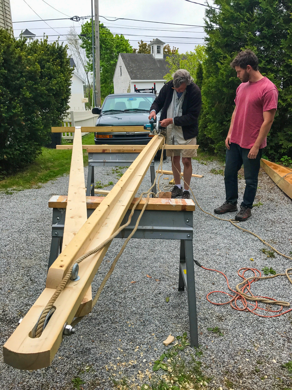

We fabricated a simple crane to mount on our harbor wall. In Maine you can usually do what you want on public lands.
I made sure the crane was fail safe. The wheel at the top (a V-belt pulley with the shoulder cut off), is housed in the 2x4 so even if it breaks, the load is held. The winch (greased and all 4 pawls checked and oiled) and the dock cleat, are through bolted thru 2 2x4s. We added stiffeners to each 16' leg.

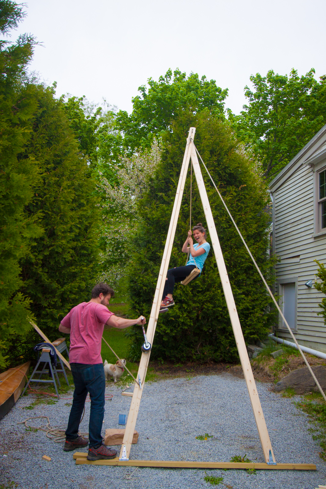

Testing: Tied to the truck bumper, we raised Thomas who weighs about 180. He was a load! But if you were are up to it, the crane showed no signs of failing. For a closer weight match, we hoisted Mary Jane. The dogs loved it!

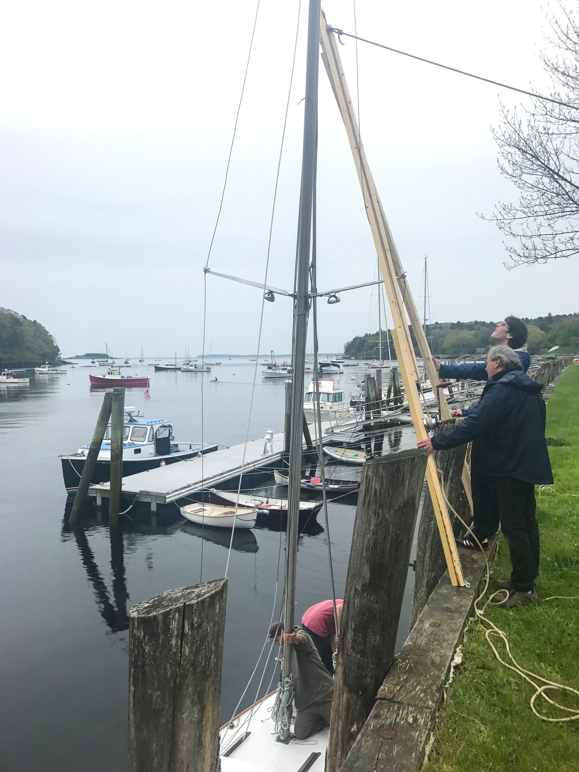

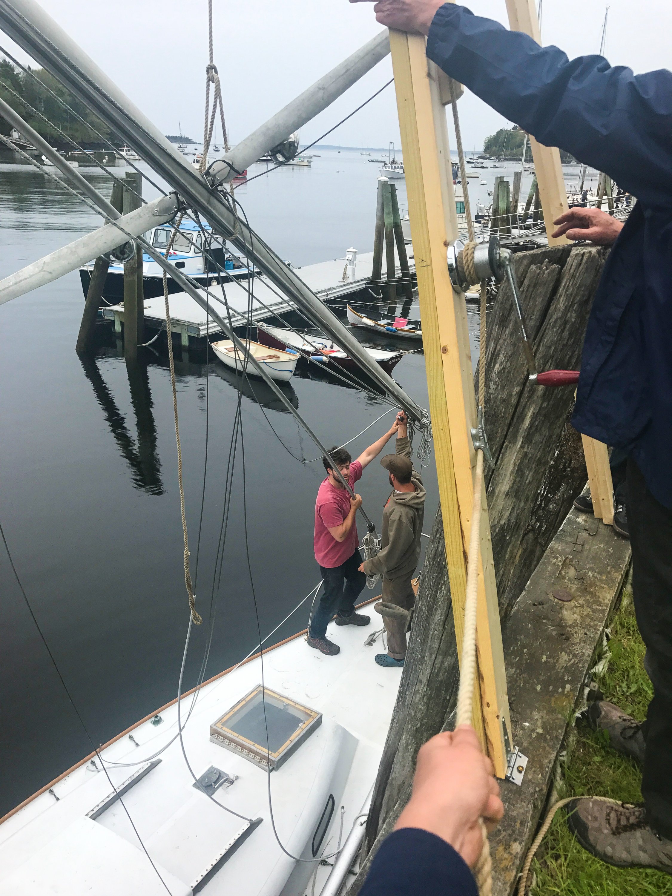

Well tested, we headed to the harbor. It worked! My daughter took this shot while tailing. The kids know the importance of winch work. We kept the guys below out of the fall zone as much as possible, just in case.
Fully hoisted, we had room to spare. But space to spare makes it easier to move the stick.
