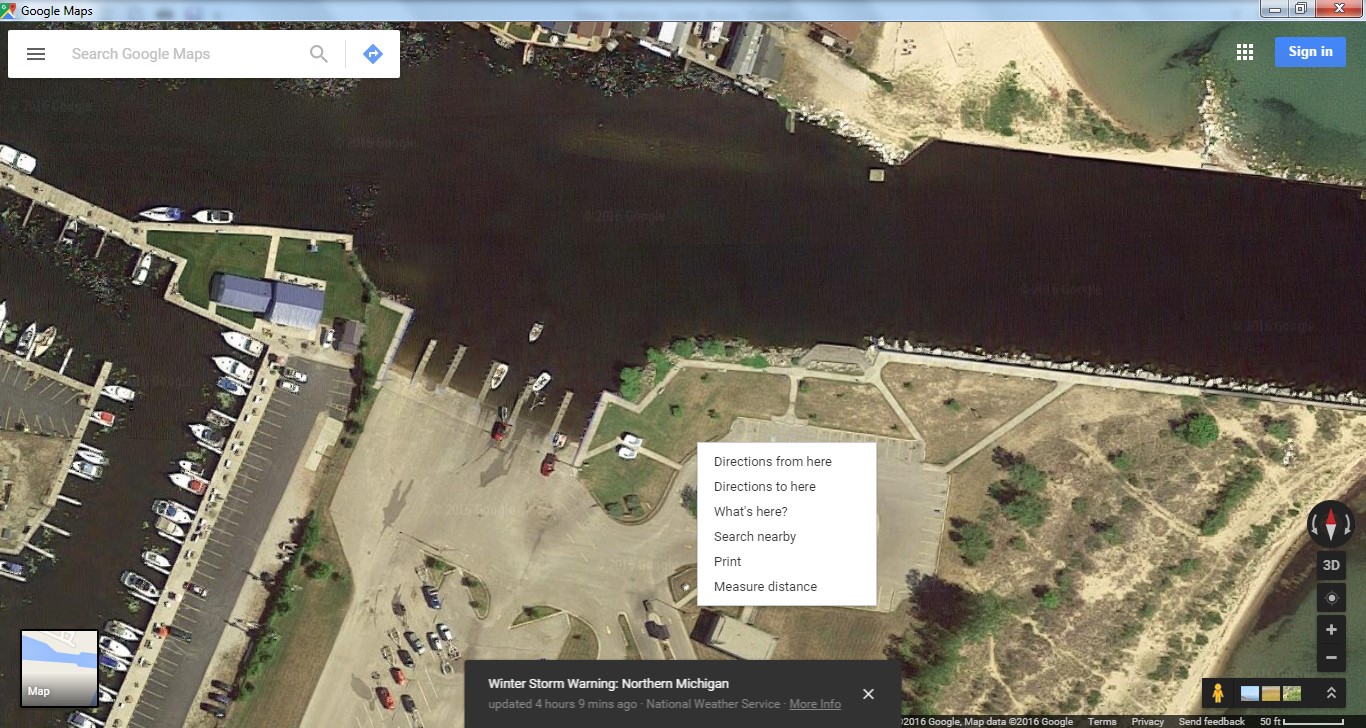

Will launch my new to me 26' this May and it always worries me that the launch might not have enough drop off to handle the boat this size even though it's a swing keel. The launch is a public launch 30 feet from the marina. Even though there are O'Day 23's in the marina that launch from there, I am still concerned. This is my first sailboat and have launched several boats in my life but all fishing boats. Has anybody had an issue with launching where the launch just wasn't big enough OR the trailer wasn't long enough to get the boat out far enough?
May 24, 2004
7,228
CC 30 South Florida
A few things about a ramp. Find out what the paved length is and if there is a drop off at the end of it. Also find out what the inclination or the slope is. In tidal waters the length of the ramp which vary according to the tides. Some sailboat trailers come with an extension (usually fixed keel boats) where the trailer can be pushed farther into the water without getting the tow vehicle underside wet. In a steep ramp the back of the boat will hit the water sooner and allow the boat to float off. In cases where the ramp is not steep enough and the trailer needs to go farther in the water the trailer can be unhooked from the tow vehicle and a line or cable be secured to it allowing the trailer to be hand pushed into the water until the boat floats off then by tying the line or cable to the hitch of the vehicle the trailer can be pulled out. (make sure there is not a drop off). We have never had much problems as we will scout the ramps for length and slope before we launch, always conscious of the tide. We have a number of ramps we regularly use and also have a list of those we stay away from. Just remember that a sailboat is floated on and off the trailer, not winched on nor allowed to slide by hitting the brakes. The winch is just used to help guide the boat into the center of the curved bunks and to secure the bow for trailering. If they launch 23' sailboats out of there I don't think you may have a problem but if the ramp is not acceptable find another one.

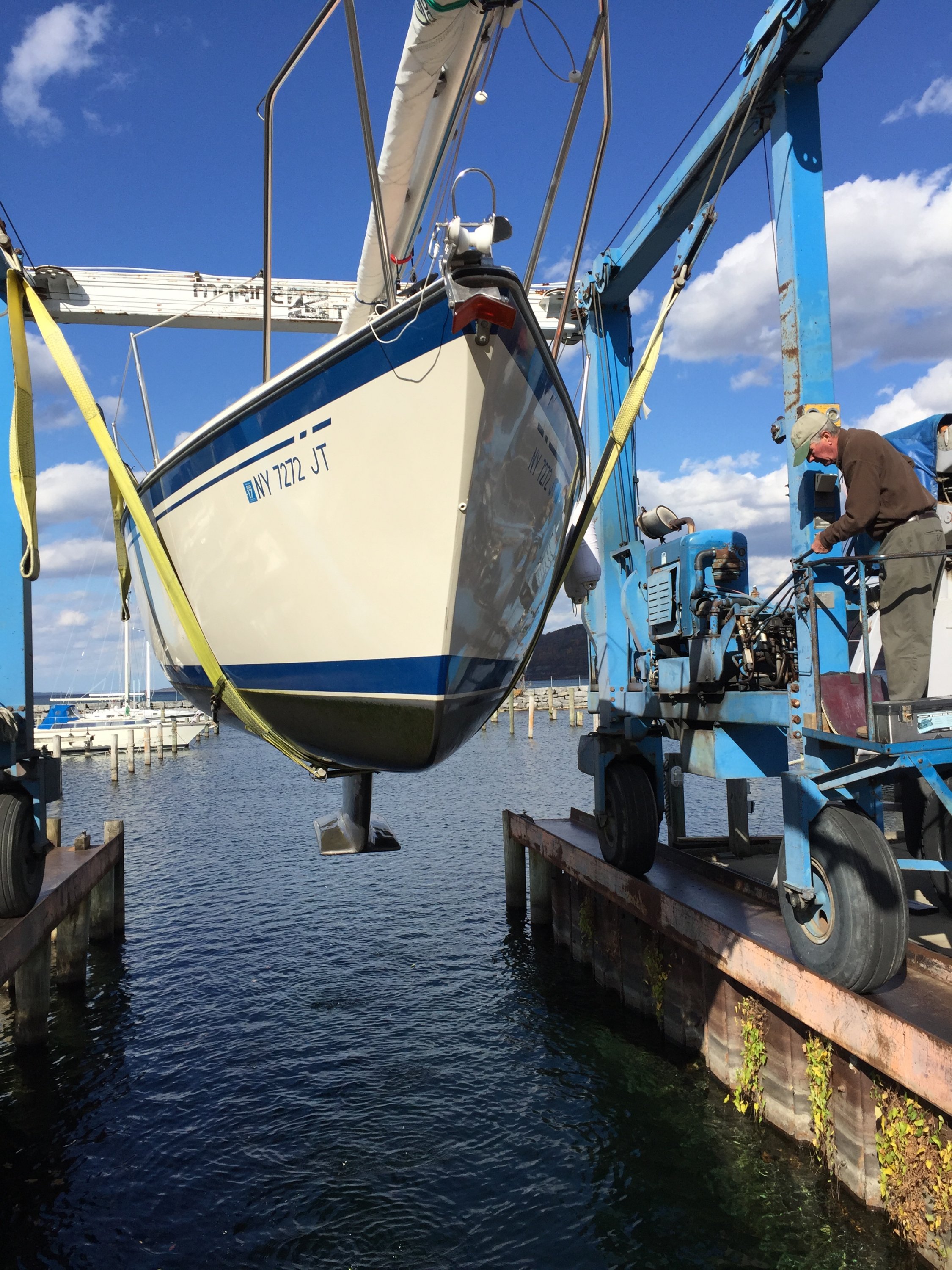

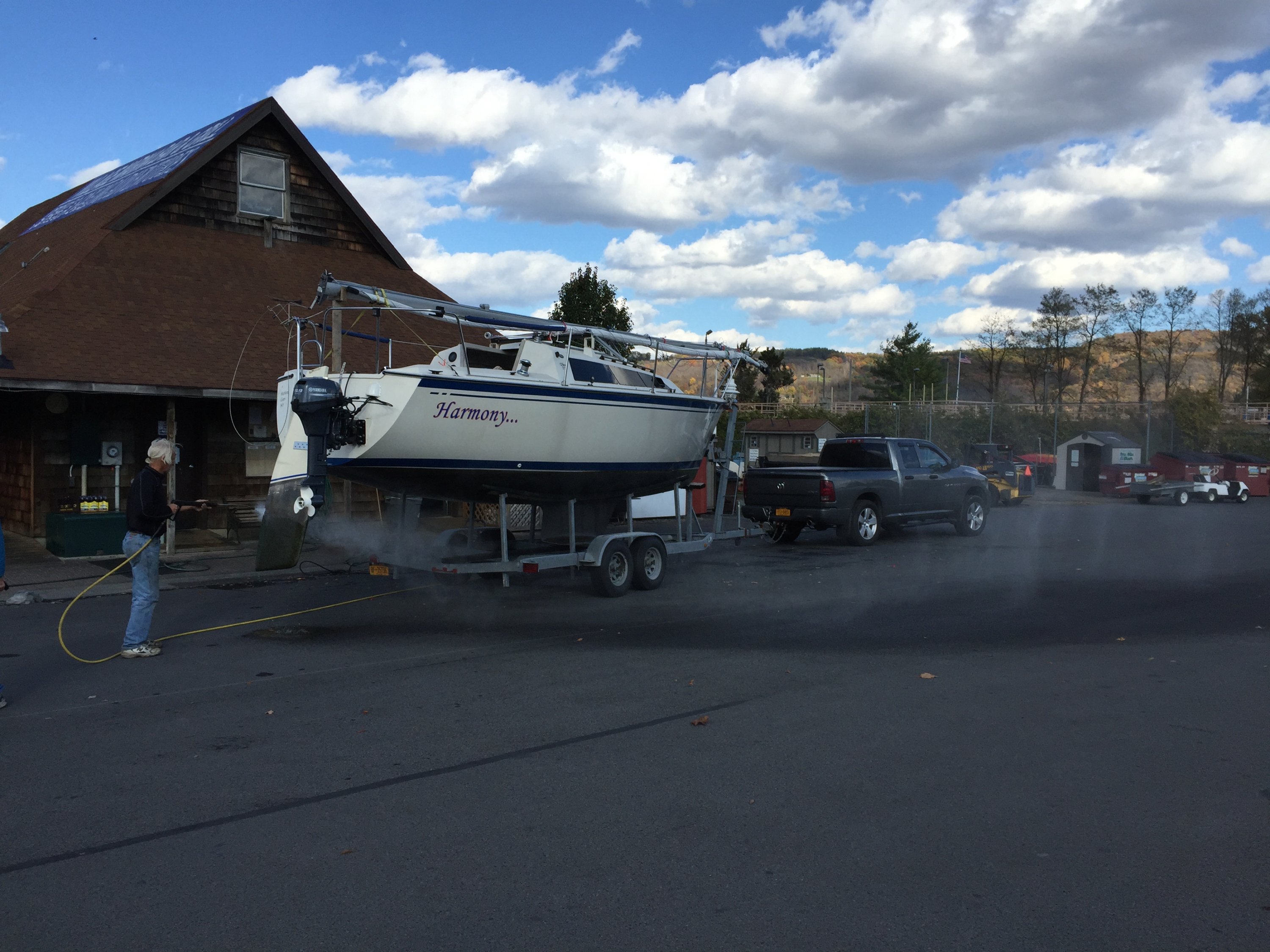

Above is a picture of my girl!
Andrew
