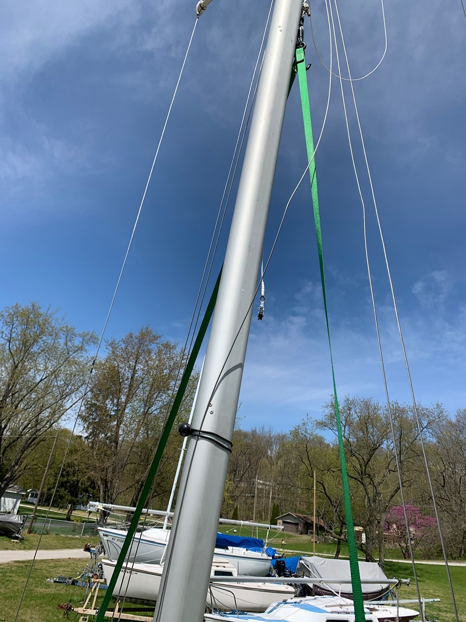

I suffered from challenges stepping the mast on my own as well... and created a bridle too... mine was based on the one discussed in this link from Skip Meisch... which also had a nice design for a gin pole.
Tips - Gin Pole
Like Skip’s, mine attaches to the forward babystay chainplate and the turnbuckle on the rear babystay with a SS ring positioned approximately at the height of the mast bolt (pivot point)... Skip used a loop of line around the mast... and attached the SS ring to that loop with some low stretch line... but I had a spare gooseneck slide and attached some spare adjustable lashing straps from the ring to the gooseneck slide. As Skip describes the loop ...or in my case the slide... is then attached to the main halyard... which is then tensioned... the main halyard only needs to go up part way (just below the spreaders worked for me). I was then able to adjust the the lashing straps so they were equal. I‘be used it only once so far... but it did a great job helping to keep the mast mostly centered! Here are some pix of my setup...
