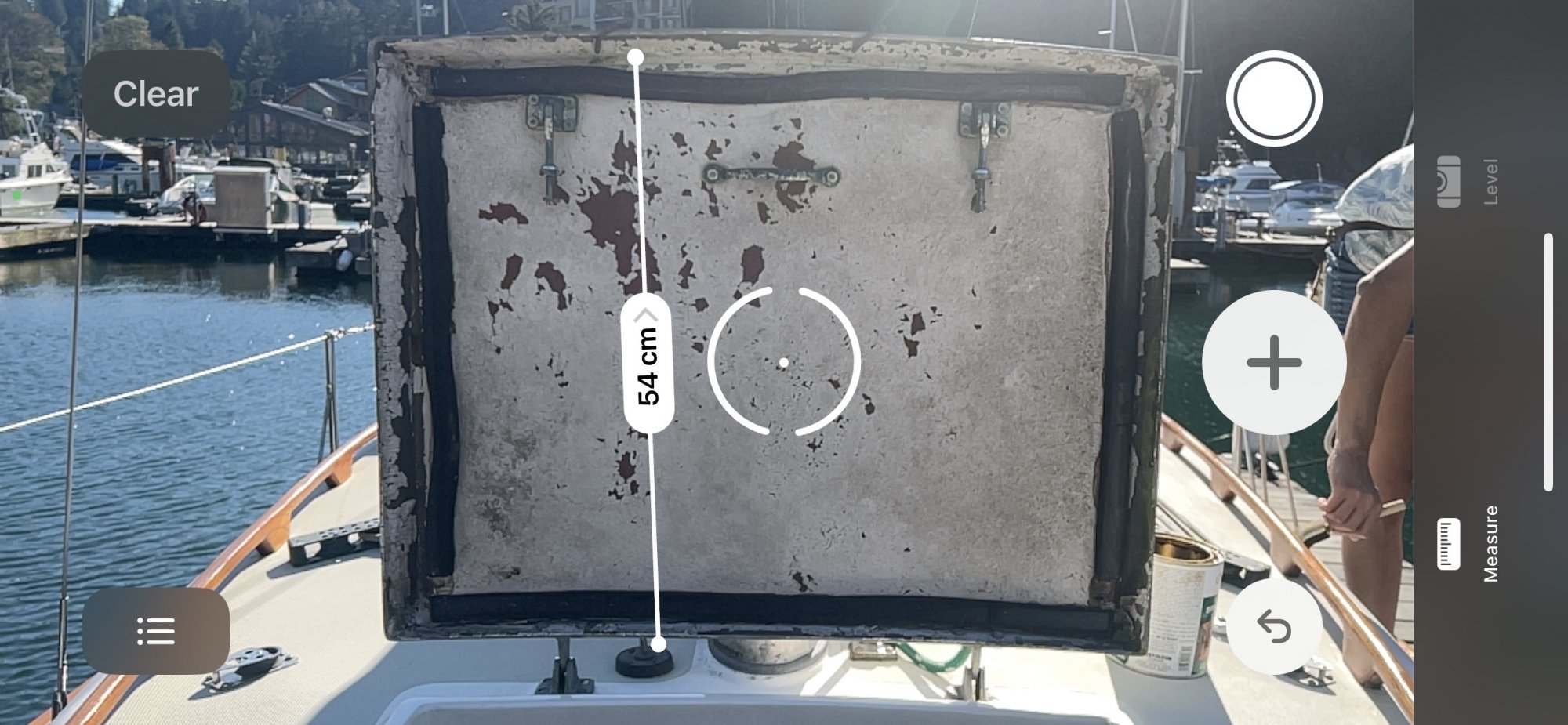

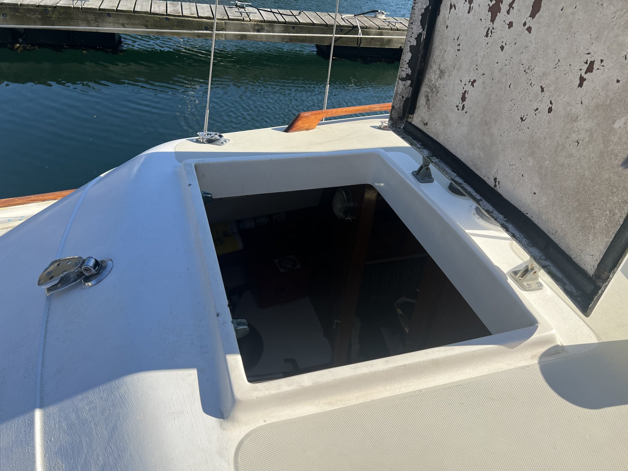

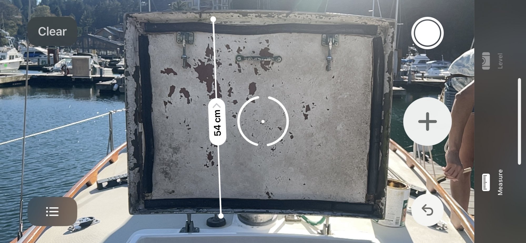

Can you post pictures of your current hatch(s) that you are looking to replace? That might help the more inventive minds on here to come up with innovative answers...
dj
Aug 12, 2024
6
Ranger 29 0 Vancouver
Here are some photos of the opening and of the current hatch.
Mr. Mayhem, I would be able to fix up the old hatch but would love to be able to have some light in our forecabin.
Basically just need a hatch that is 18x24 inches and it be pretty easy to install. But finding that size of a hatch is proving difficult.

That is a custom fiberglass hatch specific to your boat. Standard hatches have much larger radius in the corners so those are out unless you want to spend some big money to have one custom fabricated. You can install a hatch on your existing hatch but it looks like it has a bit of a curve to it. Most off the shelf hatches are made for flat surface installations and finding one with just the right curve might be difficult.
I think the most practical approach would be polycarbonate or plexiglass. You will be able to use most or all of your same hardware. If the think plexi is too tall for the hinge, raise the hinge with washers or a custom shim/block. I'd recommend 3/8-1/2" material. You can cut it yourself or have a local plastic supplier/fabricator do the work. Many S2 boats have a similar design so look at those for examples.

That's where I was going when I asked for pictures. Be mindful of the lip on that original hatch. You will want something like that on your replacement. Those seals don't withstand water coming from the side with force.
