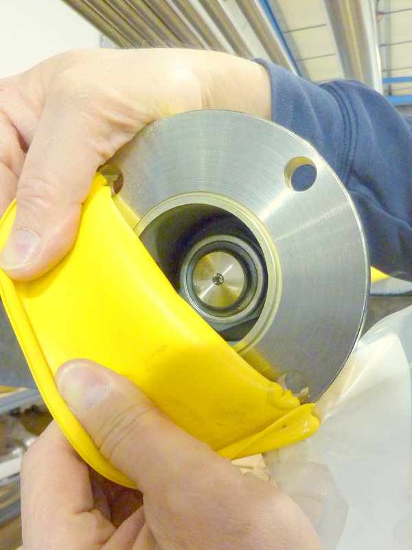

Because builders and customers don't want to pay for it. Sabre Yachts / Back Cove specifies double tapers on all their shafts and they are all made at my friends shop here in Maine and all are double taper, sail & power. I have seen double tapers on lots of higher end sailboats.
No place for the nuts!
Ross this is not the case, the nuts are well hidden inside the coupling and there are a number of ways they can be attached without the typical "prop" type nuts.
This is a double taper on a 4" type coupling which was likely for a Sabre..
