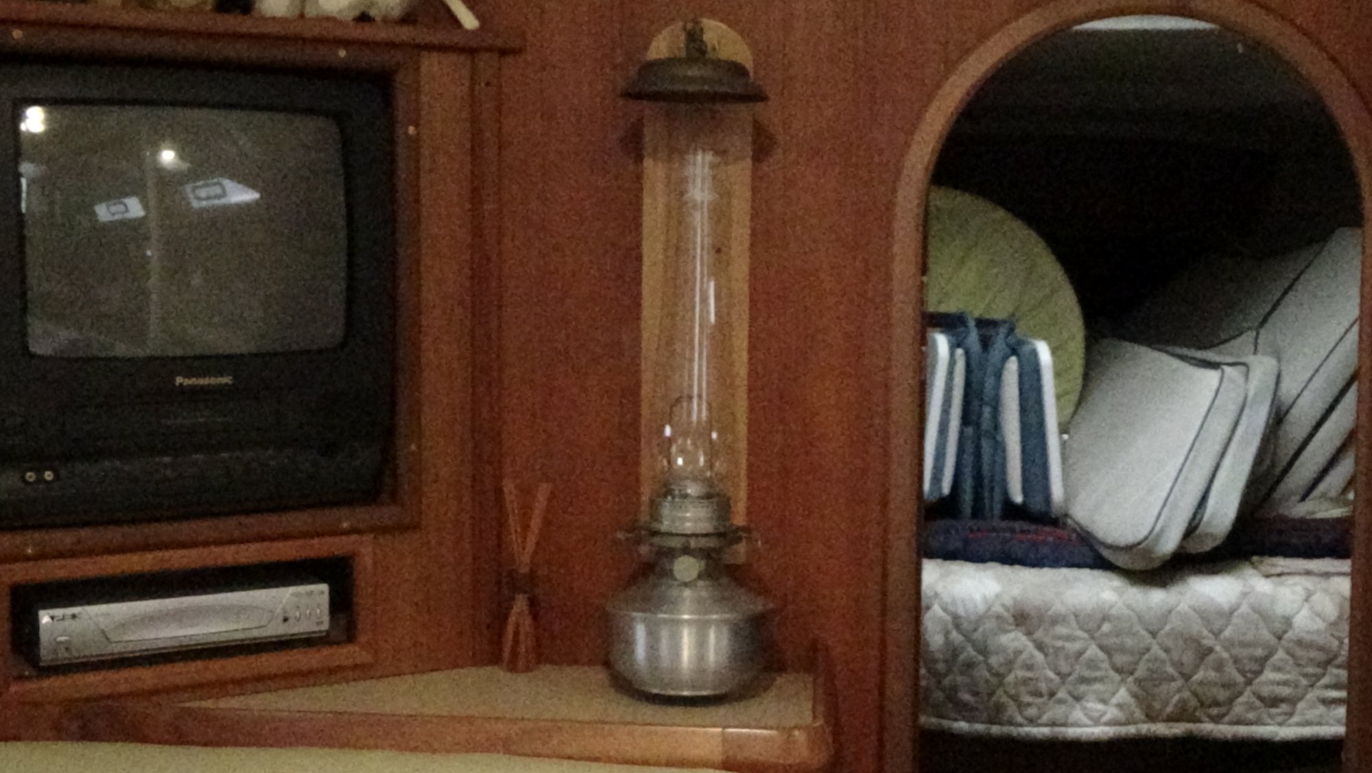

A properly gimbaled or hung lantern is much safer, though not as save as a battery operated lantern.
Agree, Dave. That is how we installed ours; mounted on the wall and gimbaled. Due to the high heat output of the Aladdin lamp, I also have a heat shield mounted above the glass chimney. The reason for the wood back plate is because that is where our nautical oil lamp used to be that we moved to the aft cabin. I did not want to drill new holes for the Aladdin lamp so made the backing wood plate to use the existing holes. The only time I light the lamp is when we're at anchor. Ditto the aft cabin lantern.

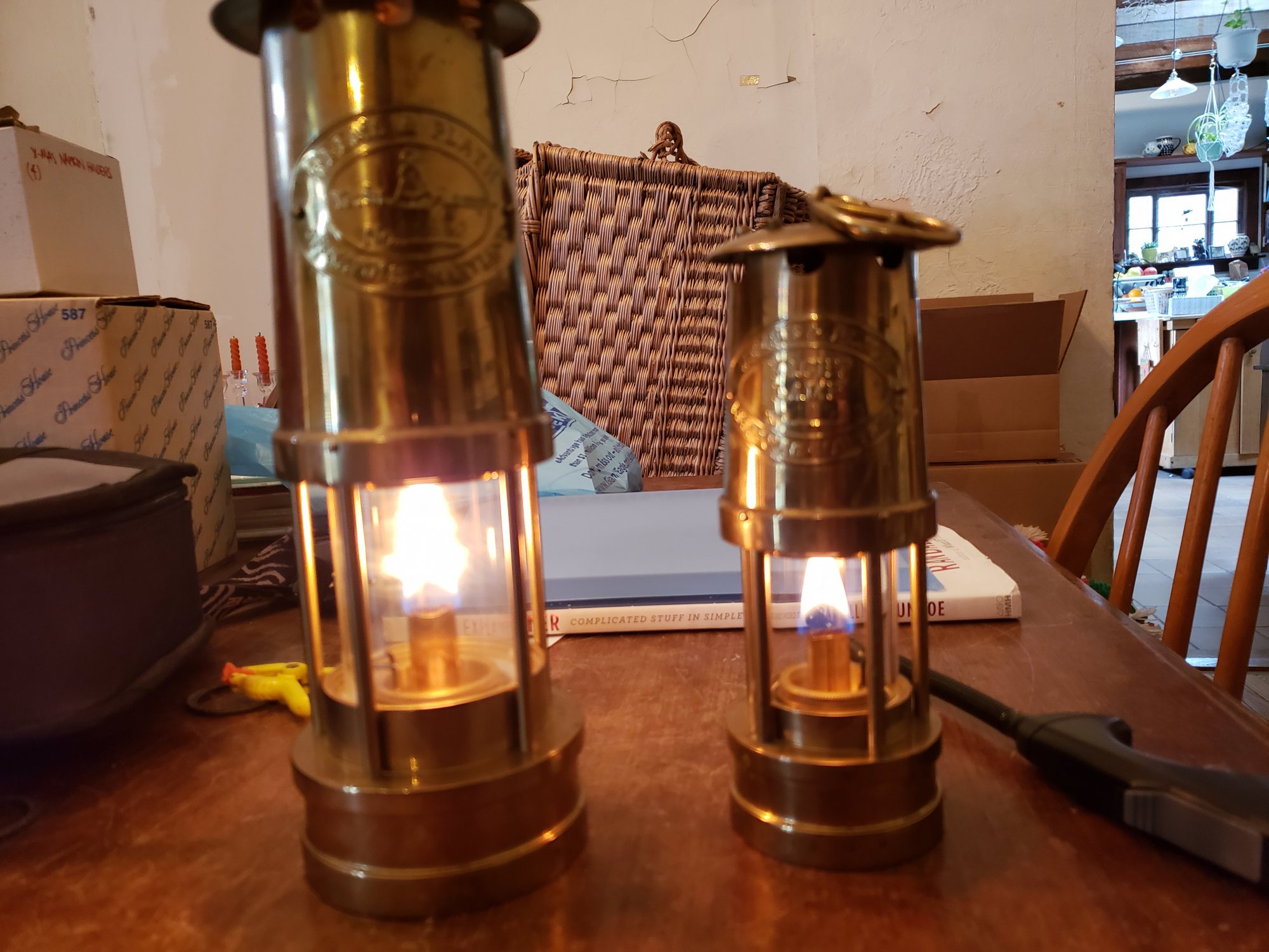

Thanks everyone; this discussion was just what I was looking for. Didn't know about wick trimming, for instance, though people are always doing it in old novels. Now I see why. Keeps down the soot.
After looking at the Aladdin and Trawler Jr lamps, I decided that the small Weems and Plath lantern was my best choice for this small craft. The small gimbal isn't sold anymore, but I imagine I can buy the large one and adapt it somehow. I ordered the small lamp off Etsy. Looks like I won't be able to read by its light, but it will take the edge off the chill, and I can also use a rechargeable light too if I'm reading. No burning lamp while underway or asleep for me, of course.
So W&P parraffin oil is about a dollar an ounce. I wonder if the cheaper oil I'm seeing online, such as Hyoola brand at about half the cost, are just as good? Thanks for any input.
13,441
We use unscented lamp oil that can be purchased at a grocery or hardware store. But the W&P does burn well and puts out a nice warm light while also burning a hole in your wallet.

Hi American Mainsail, thank you for the link. The lamp I bought has a sort of built-in smoke bell, but another wouldn't hurt. I lit the lamp last night and some soot came out; I think I need to let the burner heat up before putting on the rest of the lamp. Those reflectors / carriers also look really useful! I will order one.

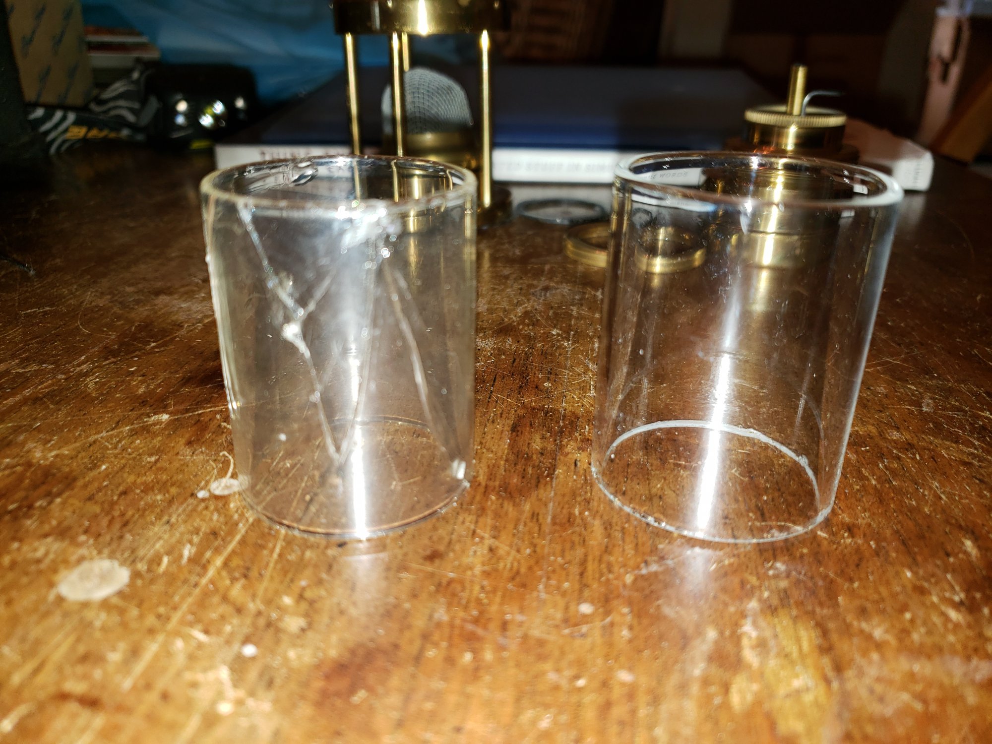

I have the small 600 and the large 700. I had a broken glass on the 600 but couldn't find them anywhere so I made some. If you want one PM me. I plan on making special mounts, but haven't done it yet.

Hi Everyone - one followup note: Weems and Plath does sell replacement gaskets for these lamps! This will make it like brand new.

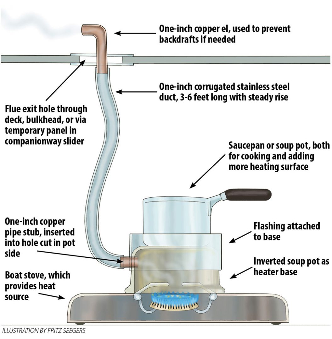

Heat the boat with the stove (crack hatch). Use LED lights.
I have one of those lamps, and it is poor at both jobs. It was obsolete when I came upon it 40 years ago, and it has only become more so. It does look nice on the book shelf at home.
Better, heat with this: I built the original from scraps for free. Works great.
1,078
Make damn sure you have carbon monoxide and smoke detectors installed if you go this route! Actually, a CO detector is really a must with any fuel-burning device onboard, including the diesel engine.
Likes: LloydB
Mar 26, 2011
3,837
Corsair F-24 MK I Deale, MD
Agreed, with ANY heating source. Boats are MUCH tighter than houses.
In fact, I tested this with an industrial CO monitor, and the exhaust goes up the stack. I day sail the boat and only use it for warming up guests during the day, in the winter. BUT ABYC requires all heaters to be sealed (from combustion air intake to stack). The heater I installed on my cruising cat had a double wall stack that brought in outside air, preheated it, and kept everything sealed from the cabin. And still I had a monitor.
To repeat, a CO monitor is mandatory on boats. Their cheap.
