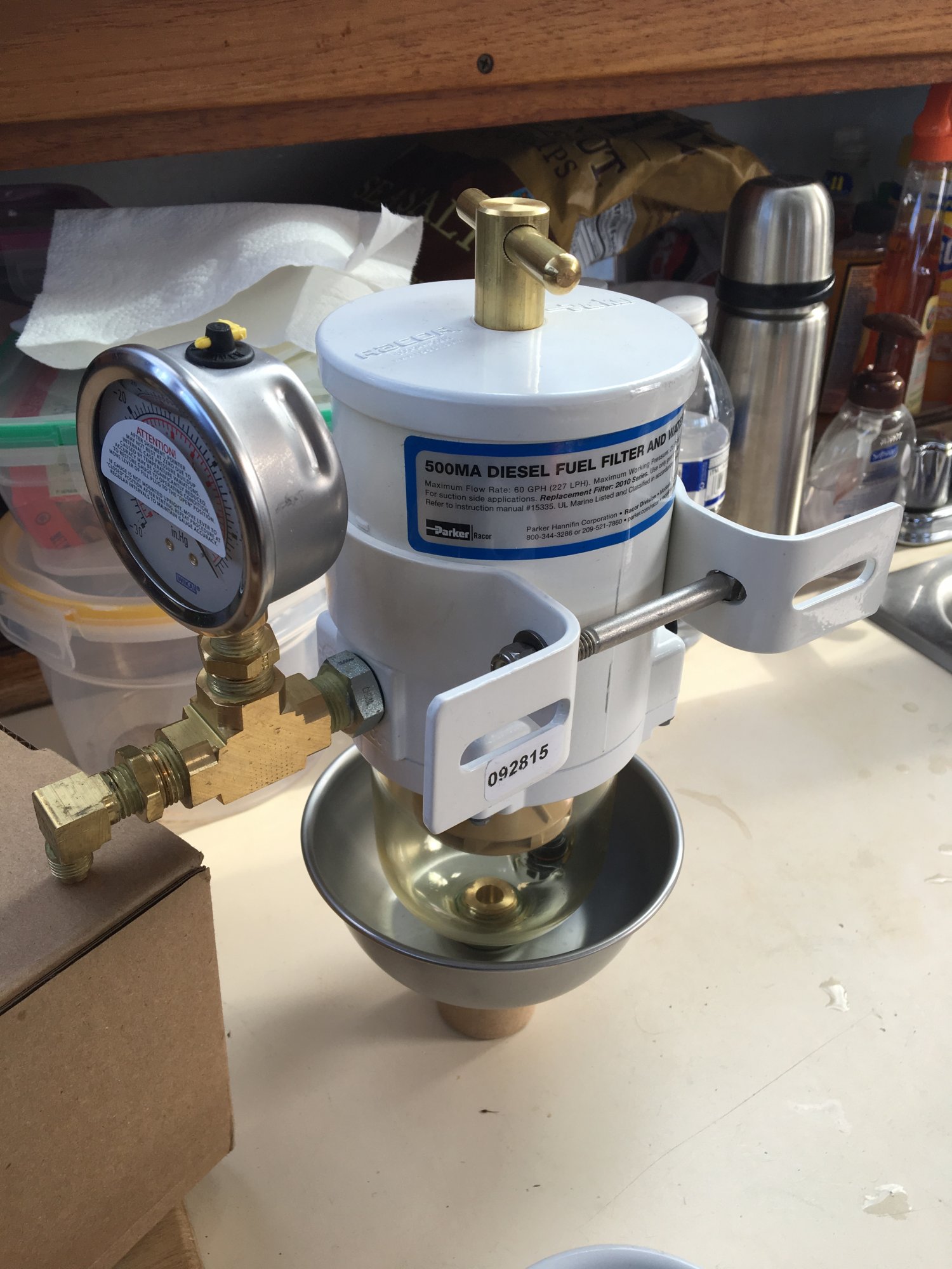

Instead I replace the primary with a Racor 500M.

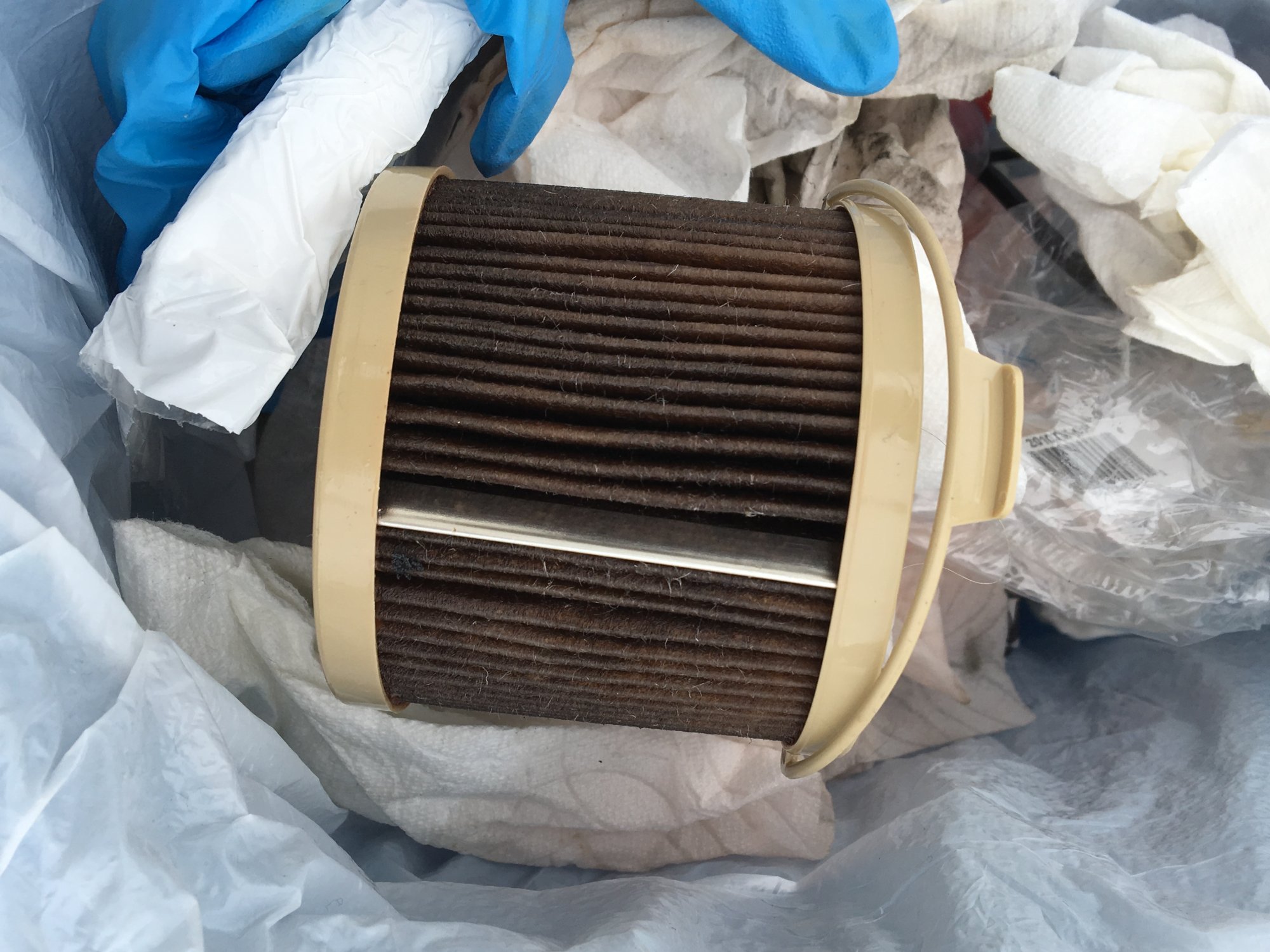

Uses a 30 micron filter. I ran the boat and start burning the fuel. I give the fuel an additive shock treatment of Biobor JF and Startron Marine Enzyme Diesel Treatment. The combination was discussed on Practical Sailor. Gives a 1-2 punch to the usual suspects that contaminate our fuel systems.
I completed about 3 filter replacements.
Here is what one of the filters looked like when changed.
After about 5 filters (cost $10 each) I had burned through most of the old fuel. The each change lasted for a longer time between changes. Now I can go for about 100 hours before I get to wondering how the filters are. Tanks are pretty much clean. I did replace the O-ring on the fuel cap. This keeps water out of the fuel tank. I recovered all of the fuel and saved about $2000 in the process.
