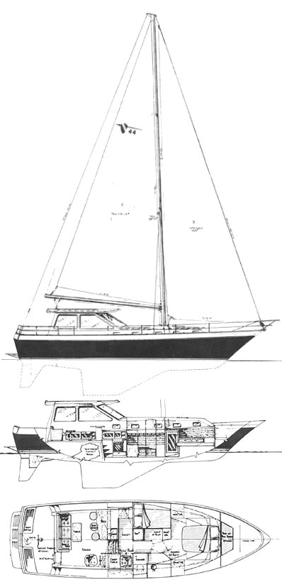

Welcome to the SBO forum. I was just up in Anacortes at Cap Sante last Sunday.

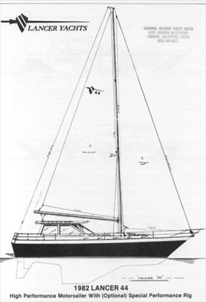

Congrats on your new to you boat. The Lancer 44 is reported to be a good coastal cruiser. No boom is not consistent with the data on the boat or the draft images.
I suppose one could rig the main to fly without a boom, like a second jib, but managing the sail would be complicated. You might do ok, off the wind ( beam reach) but not a great sail to windward. There is that saying “Gentlemen don’t sail to windward “.

Thank you for the reply. Most of the 44s did not have booms. They came with behind the mast furlers. They were rigged with the clew of the main sheet to a traverler that is at the back of the cabin top, yes basically two jobs.
They are actually known to go quite well up wind, but not as good down wind.

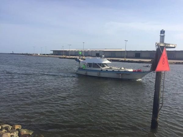

I have a 1983 Lancer 44 that has two Perkins 85 hp motors and an unusual flybridge. When I bought her in 2015, the 52' mast was down and having been berthed in Little Rock, Arkansas, we kept it laid along the port catwalk in order to clear river bridges on the way to the Gulf. We left Little Rock this past June, heading for the Keys > Bahamas > Caribbean and have since discovered that she gets pretty good fuel mileage and, since stepping the mast and redoing the rigging would cost over $5k, we decided to forego sailing and got rid of the mast. At any rate, this boat was set up with a boomless rig and her main traveller was located at the back of the flybridge.
One thing that has puzzled me is that these boats are described as being able to reach planing speeds, but my engines running at 1500 rpm only reach @ 7.5mph in slack water.
I do have one question, though. Since she now lacks a mast, the heavy keel seems to cause her to roll excessively. I'm wondering if its feasible/advisable to shorten the keel by a couple of feet. She currently draws 6' which has caused us untold aggravation.
Not sure your cause and effect are connected. Before breaking out the sawsall I’d chat with a marine engineer about the boat hull dynamics.
Your hull has a bit of a rounded bottom and what look to be soft chines. This would contribute to rolling in a bad seaway. The keel would act to maintain a straight course and minimize the boat slipping sideways. This in combination with the rudder maintain course under power. Your rolling experience would be affected by the amount of surface area and mass you have above the water line. Sure you are missing the sails and mast, but the cabin top and deck height are significantly captures of wind. The keel balance’s those forces.
I suspect a marine engineer may provide some reduction in depth but the calculations for ballast will mean attaching the lead from the bottom of the keel to the remaining stub or the boat will capsize in foul weather.
An interesting project. Keep us appraised of your progress.

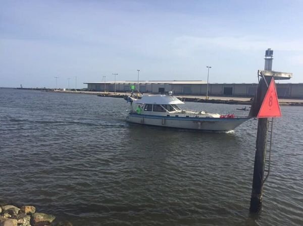

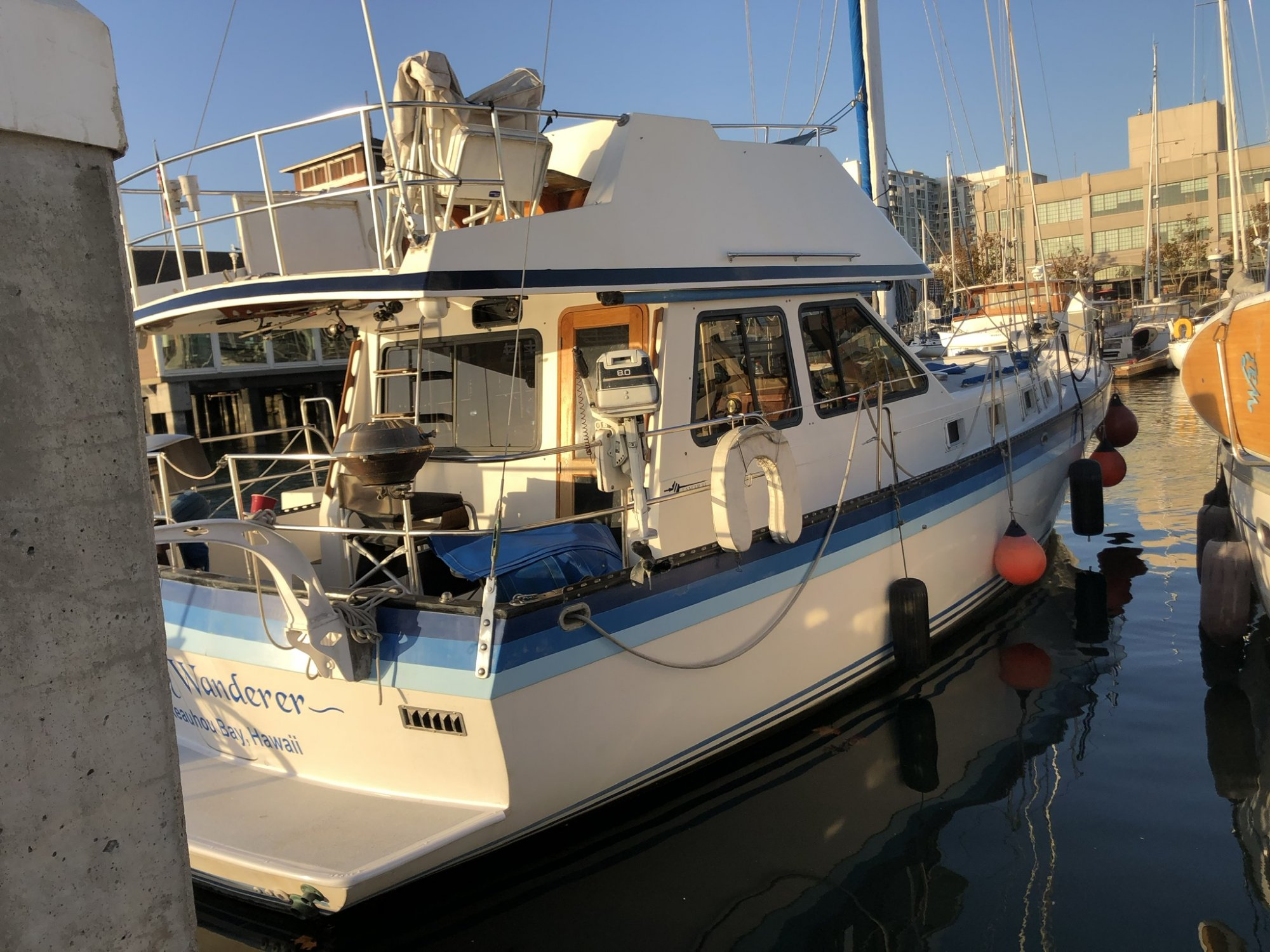

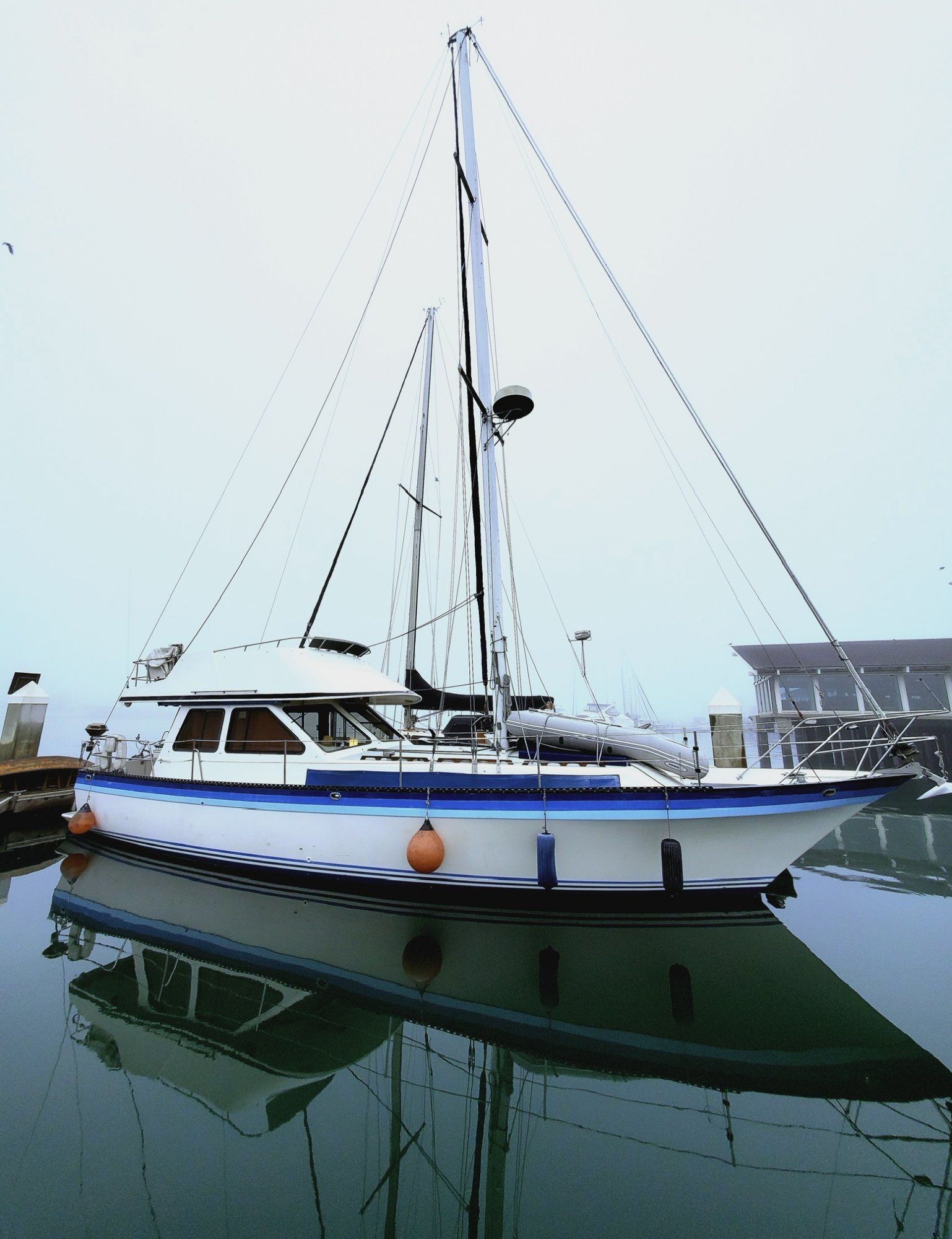

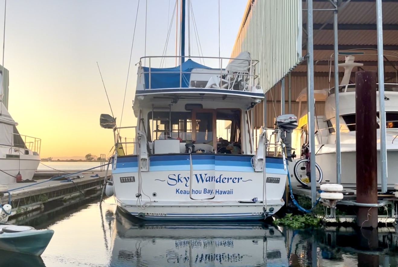

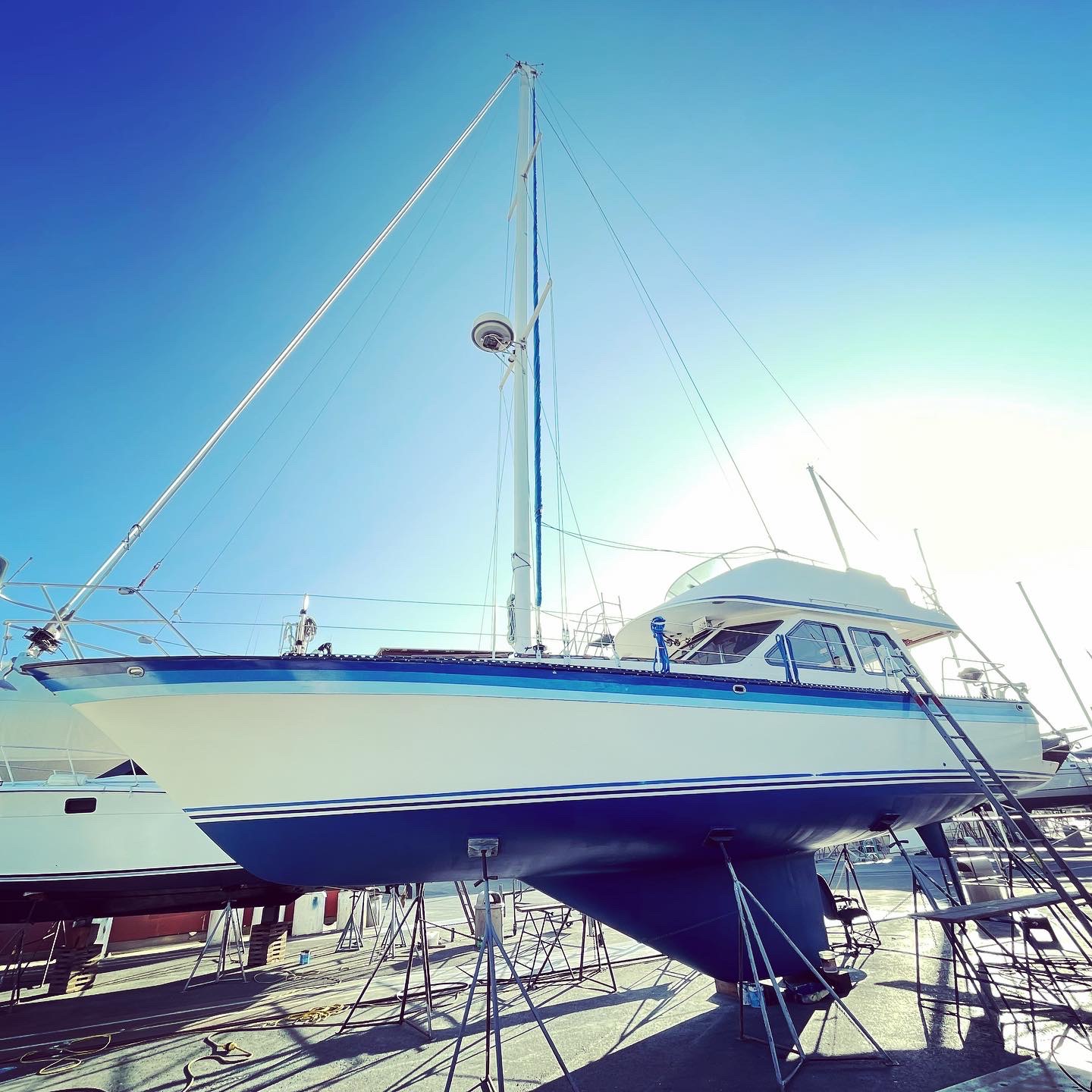

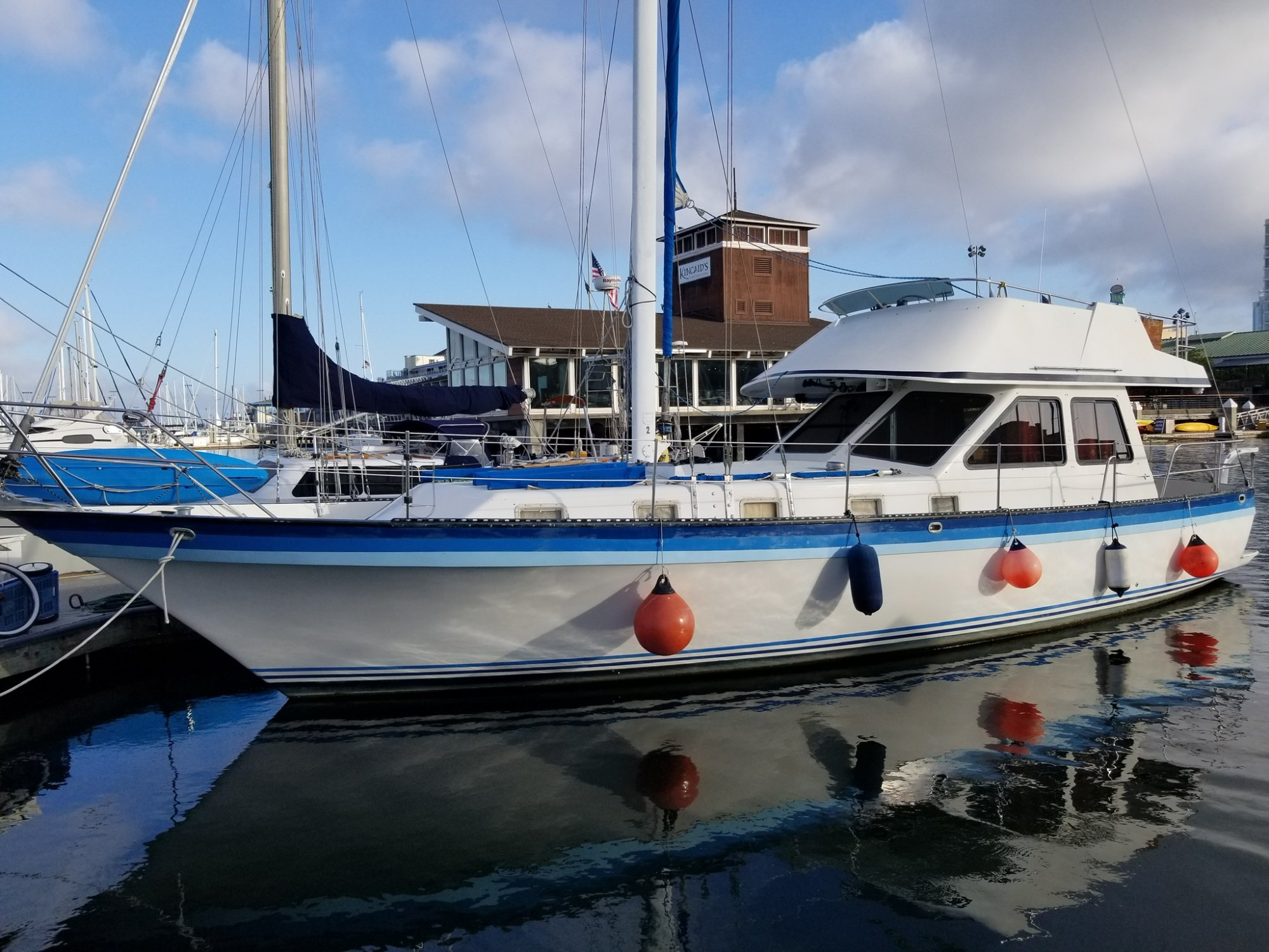

Hi CapnCrunch! We have the same type vessel (standing rigging & flybridge)!! I have also owned mine since 2015 and have never seen anyone else with a similar layout! I LOVE my boat! This initial post was made by a potential future Lancer owner several years ago, but I’m excited to see other Lancer 44 owners here. I bought mine in San Diego and motored up to SF 7 years ago. Also have twin Perkins 85 hp 4.236 engines. I’ve been slowly renovating her all over, and now heading back to San Diego (June 2023). My next/last big project is redoing the standing rigging, as it’s time. I love putting out the sails and cutting the engines and have achieved 5 kts. On average I cruise under power at around 7.5-8+ kts. Yes, she has a tendency to roll sideways more than other boats in certain conditions, but moreover is really such a comfy boat. I think it is because of the large rounded hull design. And we both deal with a lot of freeboard in windy conditions which can be challenging for docking in certain circumstances.
My desire is eventually to continue south along Baja, and ideally through the Panama Canal and onto the Caribbean.

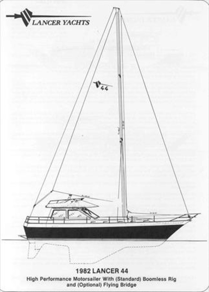

depends on what you call "planing"
the Lancer 44 was designed to plane under enough power, dare I say this was the point of the boat. In fact the nearly identical Lancer 45 is the same boat simply without the option of sails. here some things I saved over the years looking at and thinking about the Lancer, they are not mine

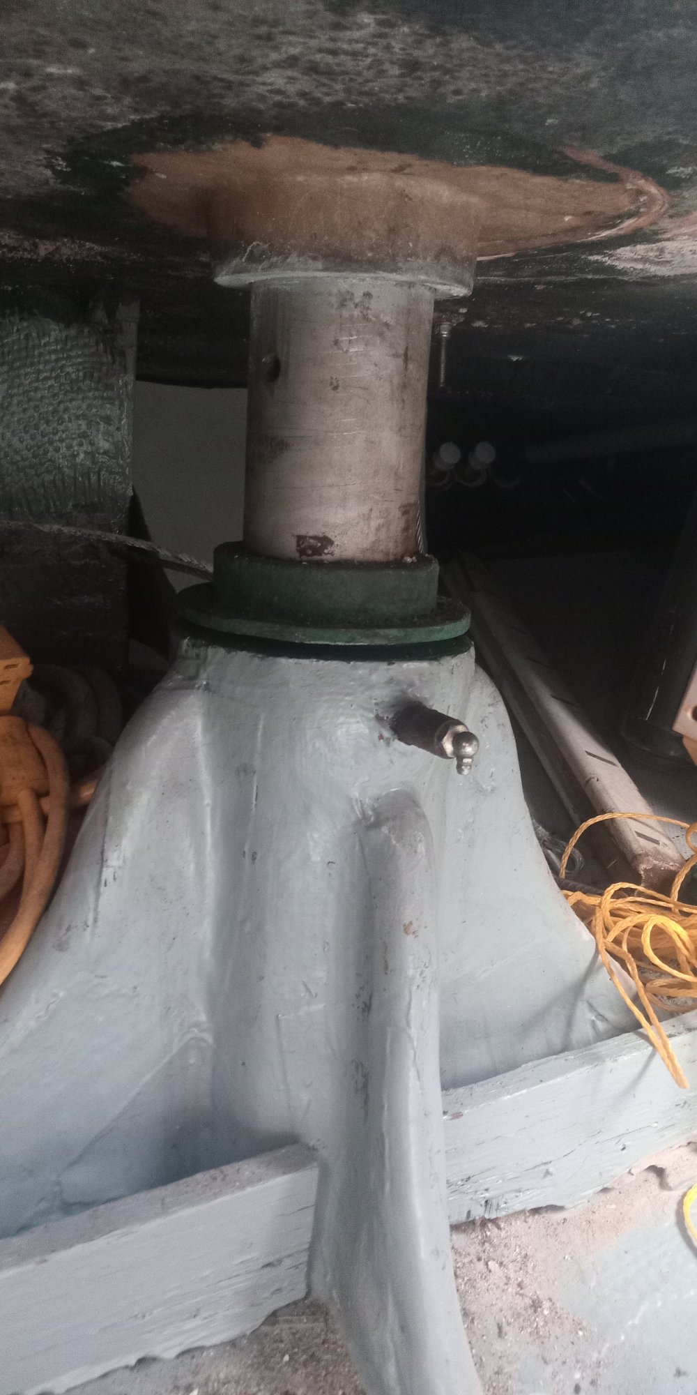

I have a Lancer 44 MS down in La Paz Mx. I've had her (Against the Wind) 4 yrs now and have been working on her slowly and enjoying life, living on her 6 months a year in a very nice place. She is a dream to live on.
I've done quite a lot of work on her...both 4-236s are fresh...new windlass...lots of new electrical parts..batteries...Bottom job...woodwork refinishing...new glazing in all the salon windows....and more i'd bet.
i'm currently working on a rudder issue. I need to remove the rudder...still in the water.
Have any of you seen any photos or have any experience with rudders on these? We are stuck and can't get the post out. TIA
