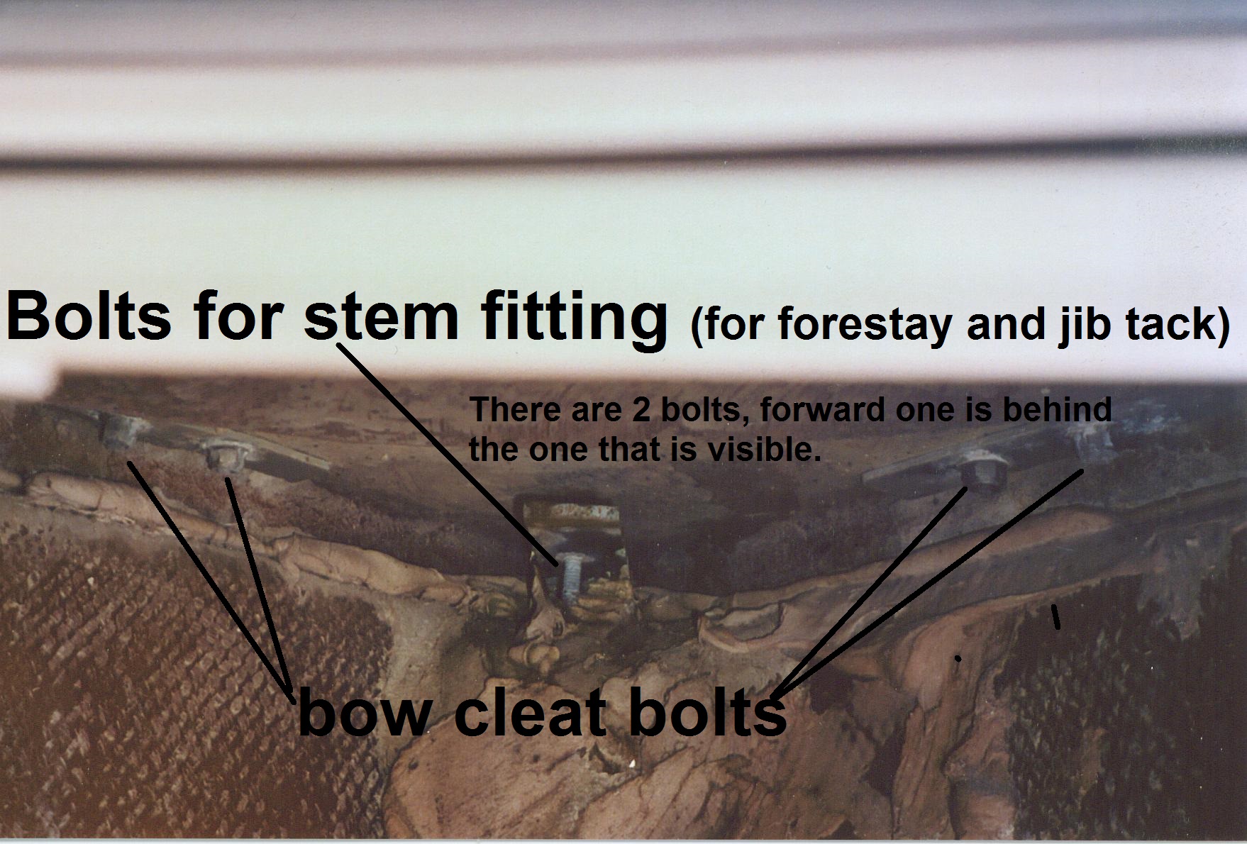

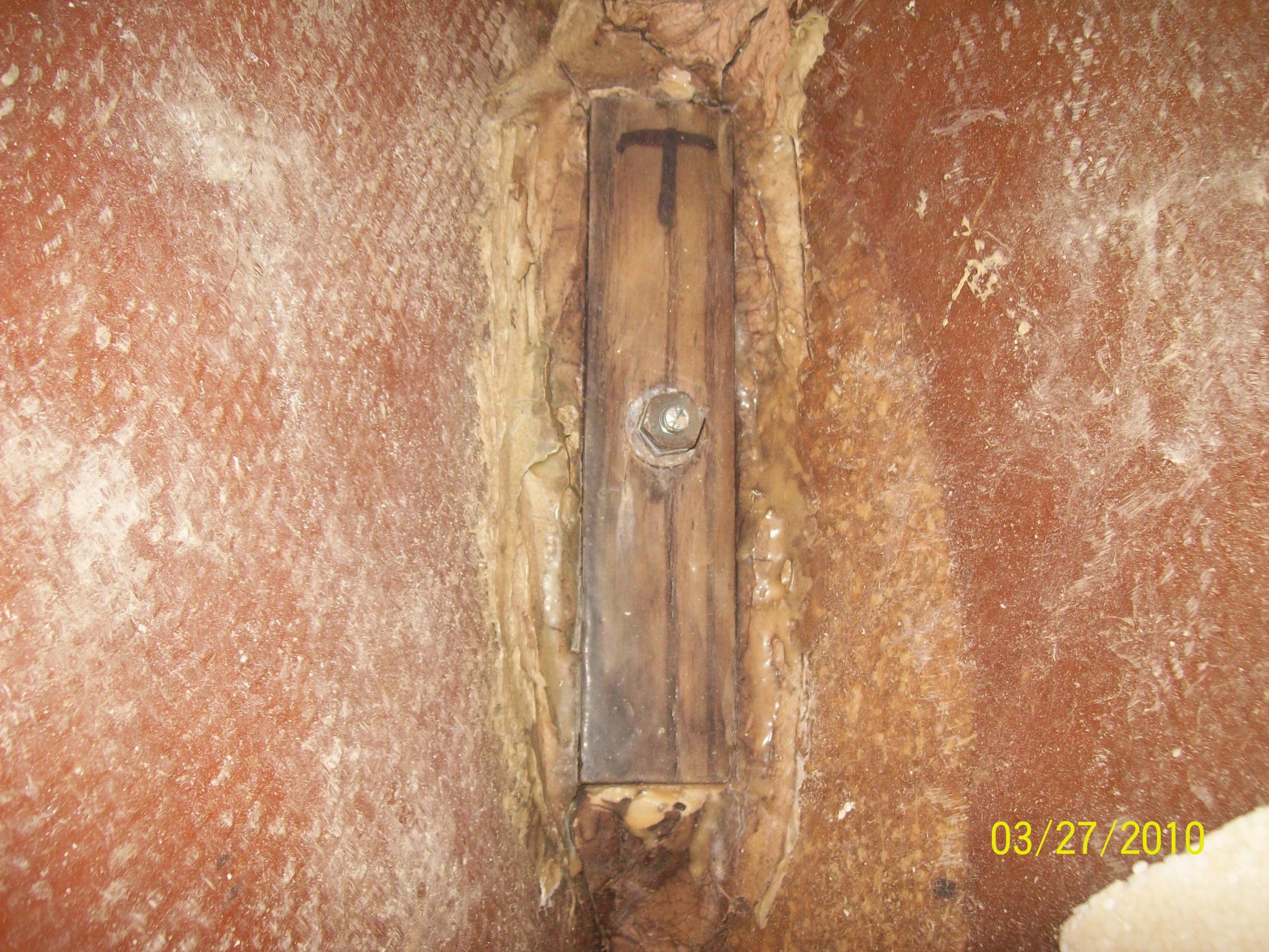

I know the bow eye on my DS II is a lot better re-enforced that the 2 bow cleats. I have a solid oak block (which I later coated with epoxy) backing up my bow eye (Trailering eye). The bow cleats are through bolted, but the backing plates from the factory are just 1/8" aluminum strips. I've been meaning to replace those with real backing plates ever since I bought my boat in 1996, still holding, but maybe I'll get to it soon..... That block for the bow eye is about 2" thick if I recall.

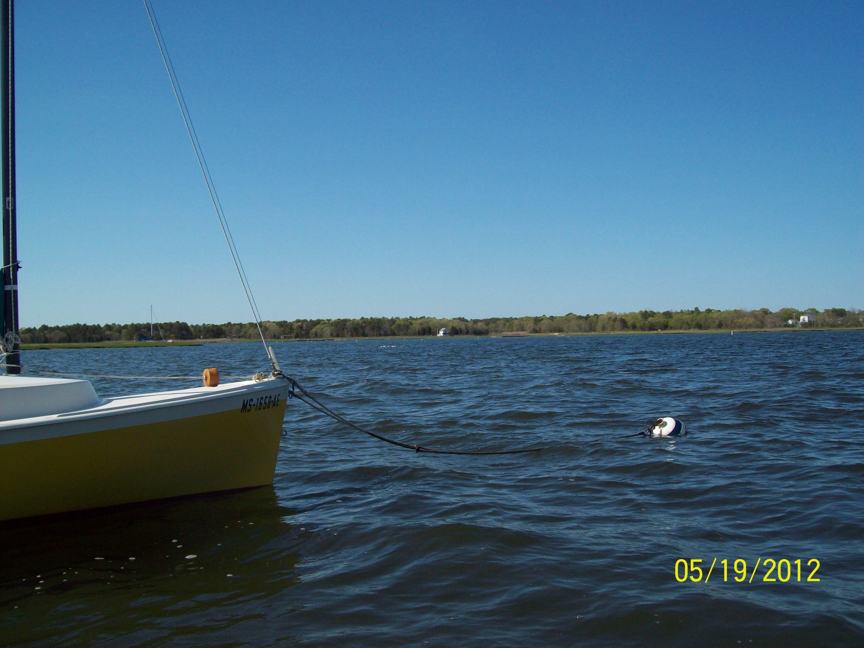

My top chain runs through the buoy, and my rope pendant uses a bridle to attach to both bow cleats. Be glad you don't want to moor your boat In Wareham, MA, I'm in a sheltered cove and yet town regs require 5/8" heavy chain and 1/2" light chain for my 600# boat!! My 100# mushroom is "grandfathered" but otherwise I'd need a 200# mushroom! (Usual common sense rule of thumb with good holding ground, says that mushroom should be 10% of boat weight)
