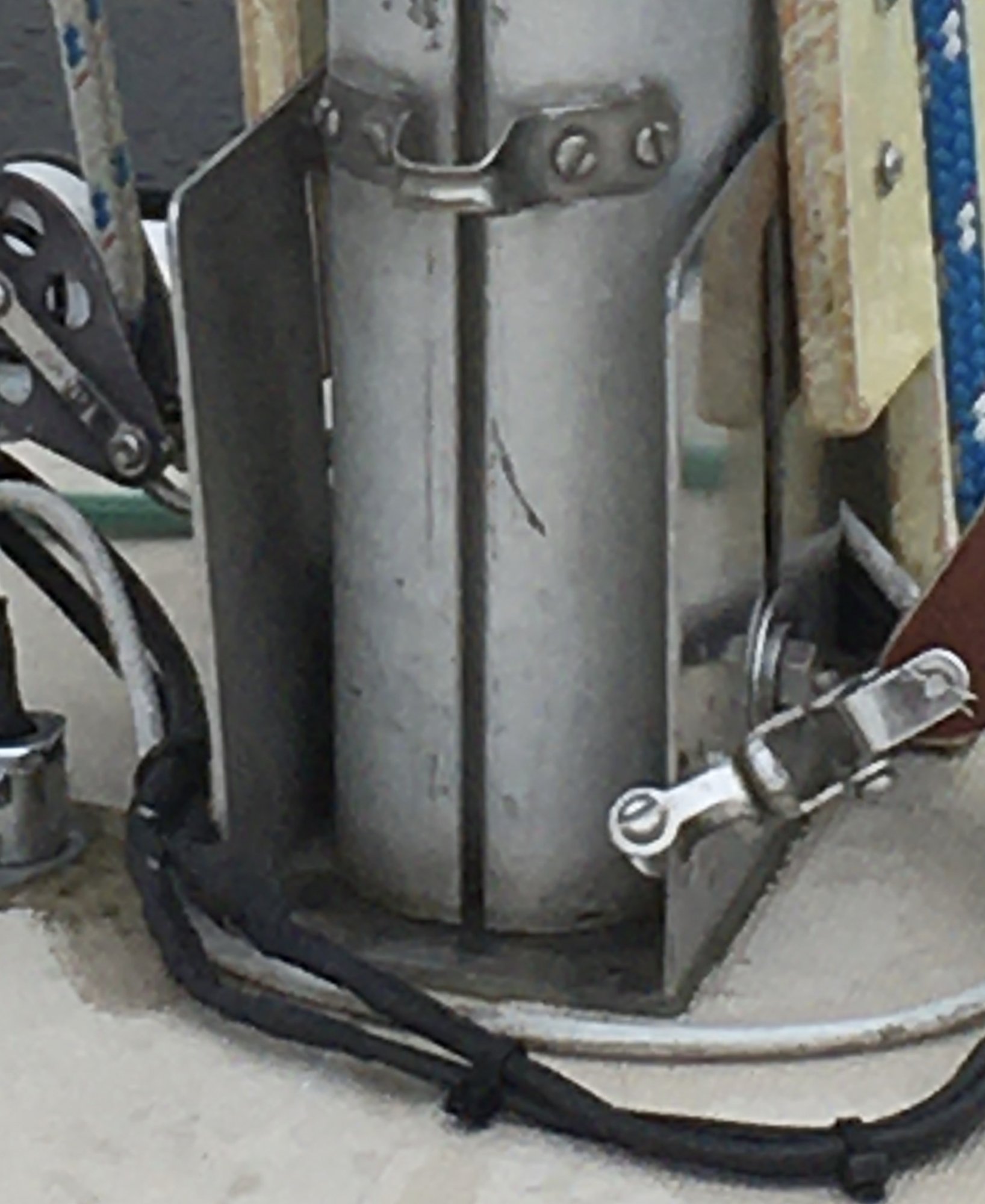

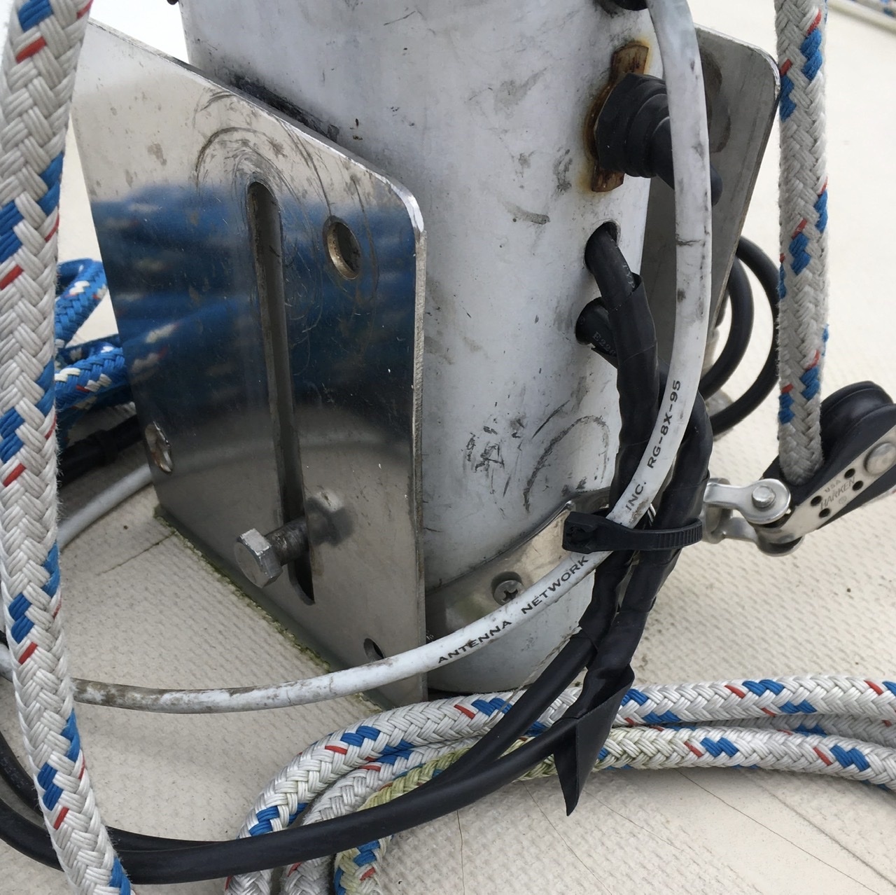

I need to get the mast lowered on my Laguna 26. It doesn’t have the normal setup of a plate welded onto the base of the mast with a hinge point on the aft side. Instead, it has a through bolt about an inch up, going through a SS bracket which itself is attached to the cabin top. The mast itself is elliptical shape, about 3” x 4.5”
I don’t see how this can work as a pulpit without damaging the mast. If I start to lower the mast aft, the lower aft end of the mast will have to slide forward as the bolt hinge point rises and then the entire weight of the mast will bear down on this aft corner which will almost surely bend the mainsail lug track. On other similar setups I’ve seen, the aft part of the mast is curved to increase the bearing surface and let it slide forward more easily, but mine just comes to a point. What am I missing? I know the mast is designed to be lowered, but it just seems inevitable that the aft end of the base will be crushed.

To clarify, in the photo we're looking at the mast from forward and starboard of the mast, right?
It would help to see the other side. It looks like the slot is there so that the bolt can slide up as the mast goes down. And I agree that would put a lot of point load at the base of the mast. Does that SS bracket go completely under the foot of the mast, so that it can act as a bearing surface? That would probably be okay. I mean, it's not like the load is tons. Still, it does seem like an odd design.

Yes, you are right about the perspective. I will try to remember to take another picture of the aft end when I go to the boat tomorrow. The stainless steel plate/fitting does completely go under the base of the mast so I’m not worried about the cabin top, just the aft end of the mast when the slot for the mainsail slugs run ... not down that low of course, but still, I don’t want to crush anything.

What is the hole at top of the bracket for? There is another at the bottom.

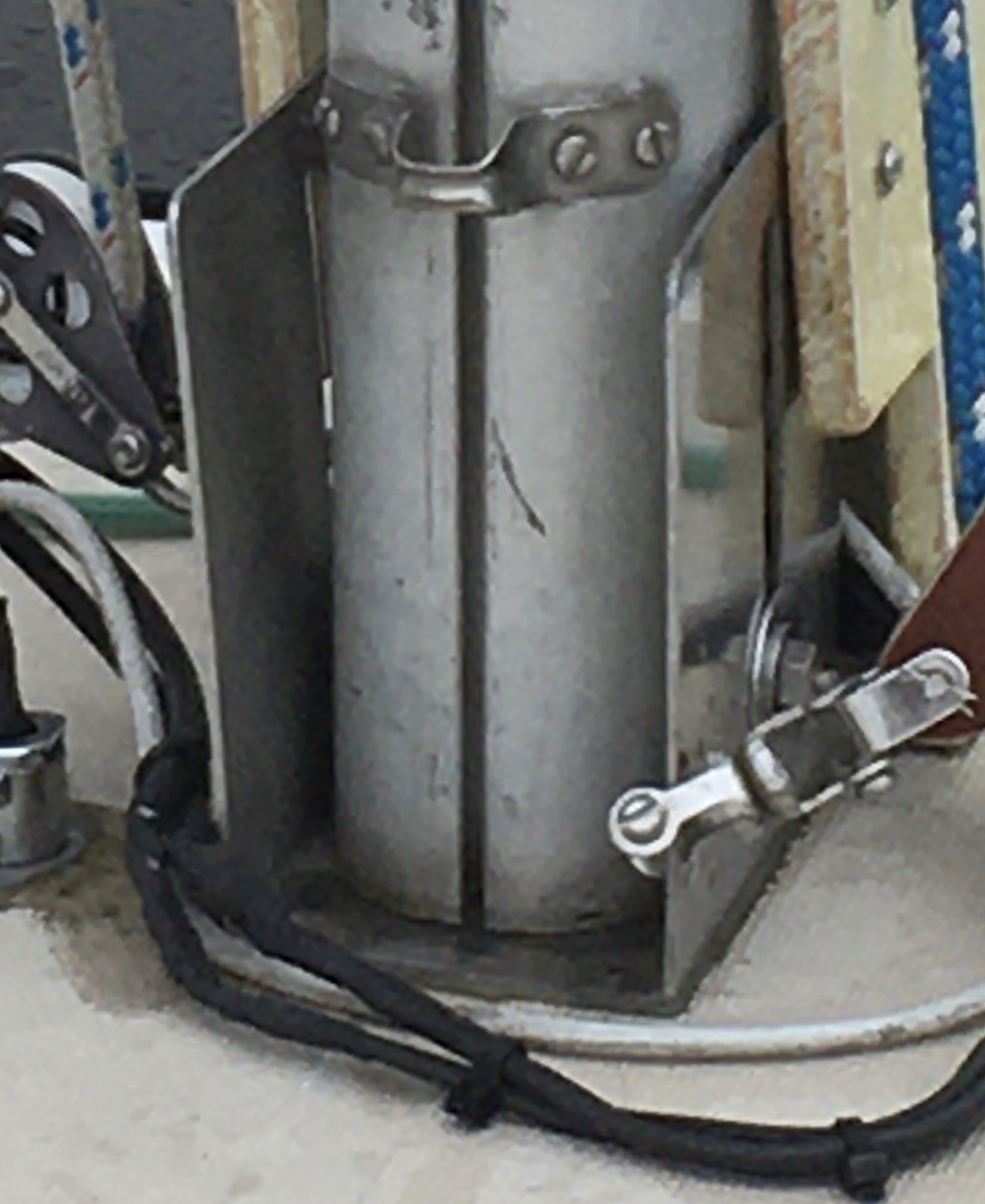

I have seen that style before as a dealer. Generally the back of the mast at the bottom was cut straight with the backside cut at an angle to allow dropping the mast backwards. Can you take a photo of the backside bottom of your mast

Thanks Dave. Here is a picture of the back of the mast. As you can see, the heel of the mast is not cut at an angle (or curved) like you describe, so it seems all the stress on the channel for the mainsail lugs will almost certainly bend it if I lower the mast aft, unless I can actually lift up on the mast as it’s lowering, but I don’t even think this is possible. Any ideas, suggestions, feedback, etc. most welcome!

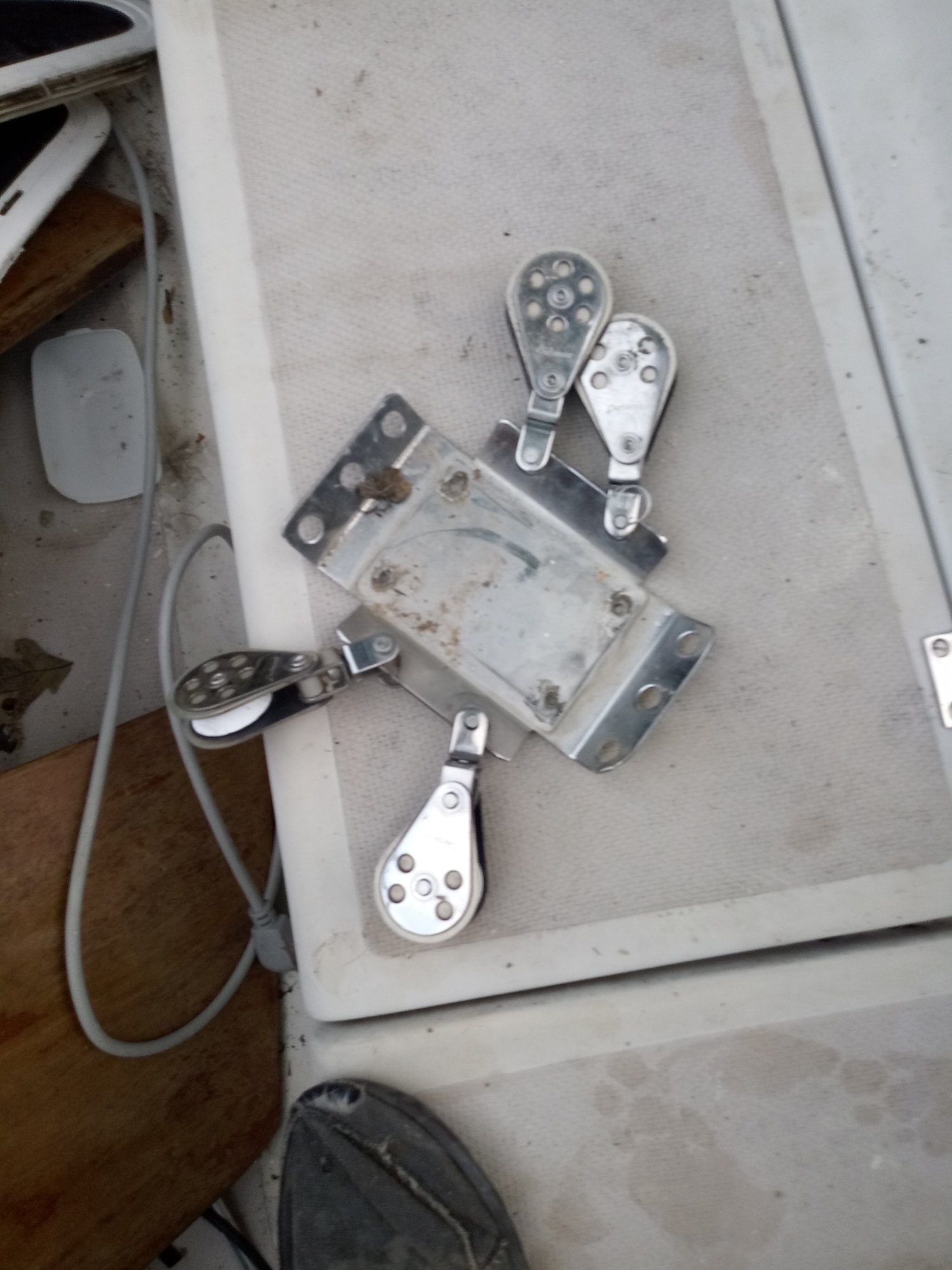

yep, same bracket. mine also has a plate under it to attach blocks to for cockpit routed halyards

Could you post a picture of the plate and bracket. I would like to do the same thing as your setup.

My boat is taken apart to reseal deck hardware right now.
This plate sits under my mast base and my halyards and vang run through the blocks to line clutches a small winches on my deck alongside my companionway.

If the backside of the mast base is cut or angled upwards to allow the mast to be dropped backwards easier, that is not a problem as the mast is aluminum resting on a stainless steel mast foot which based on my experience as a dealer was never an issue

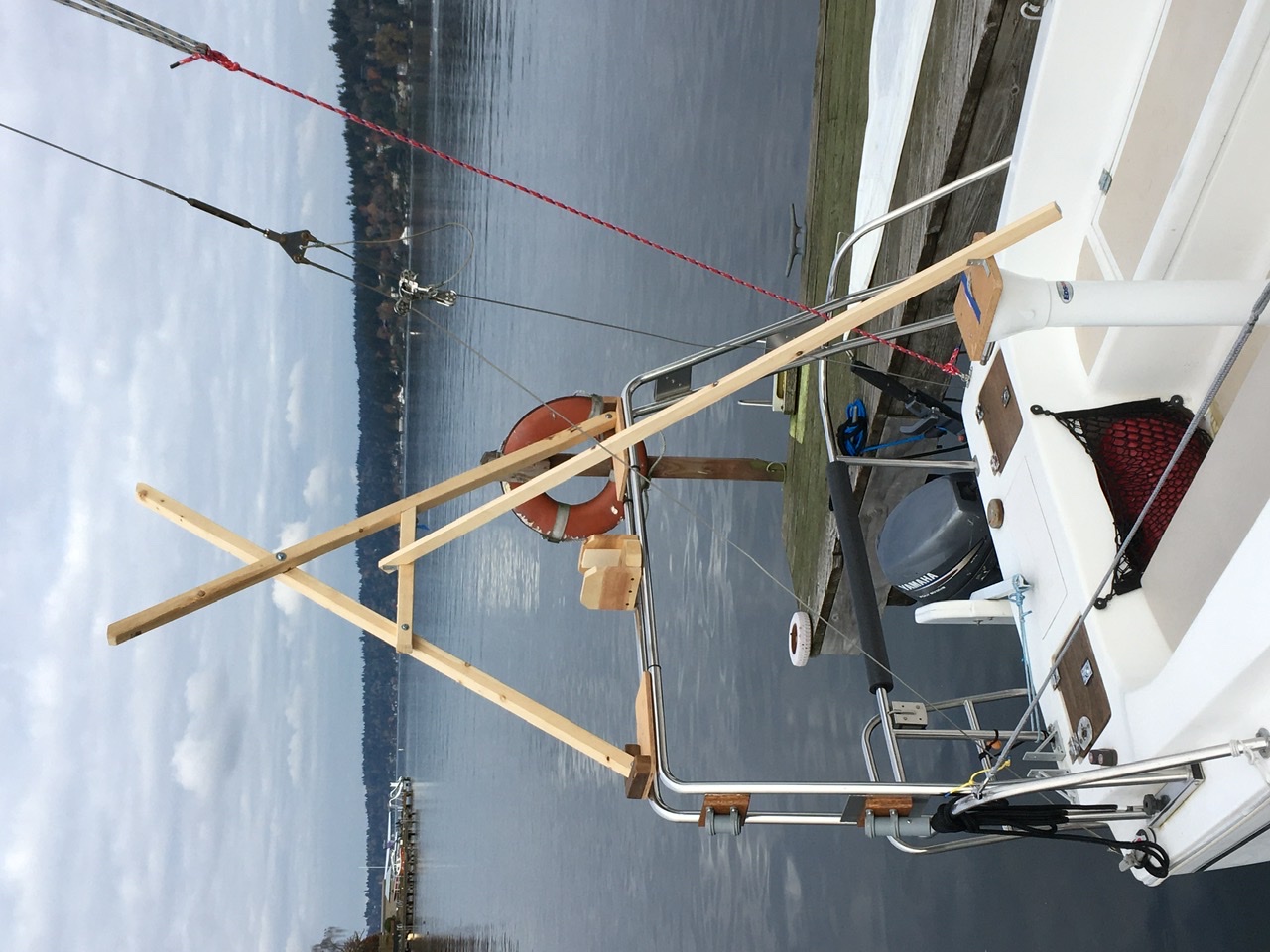

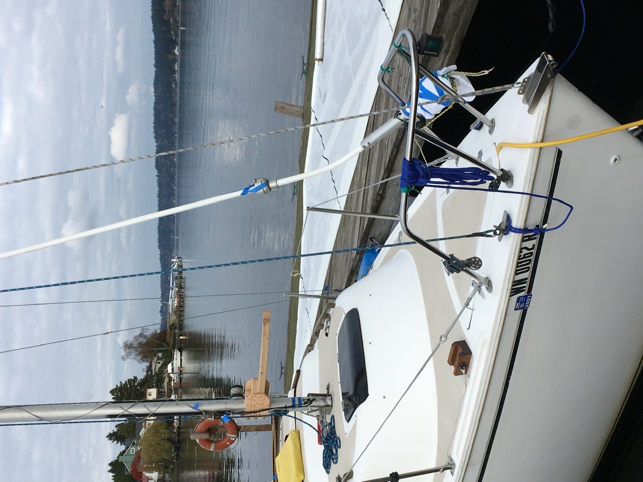

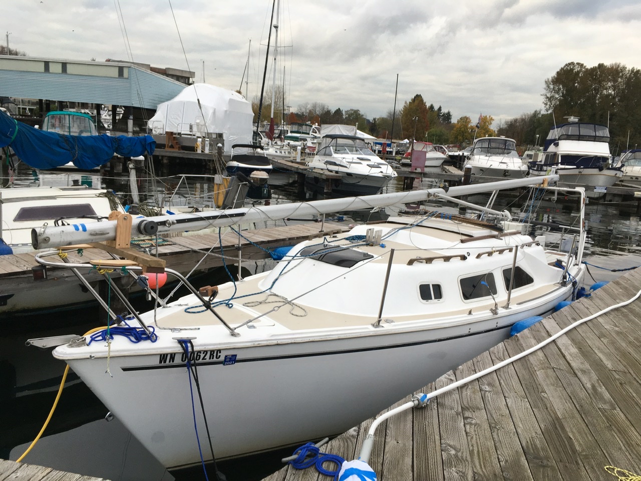

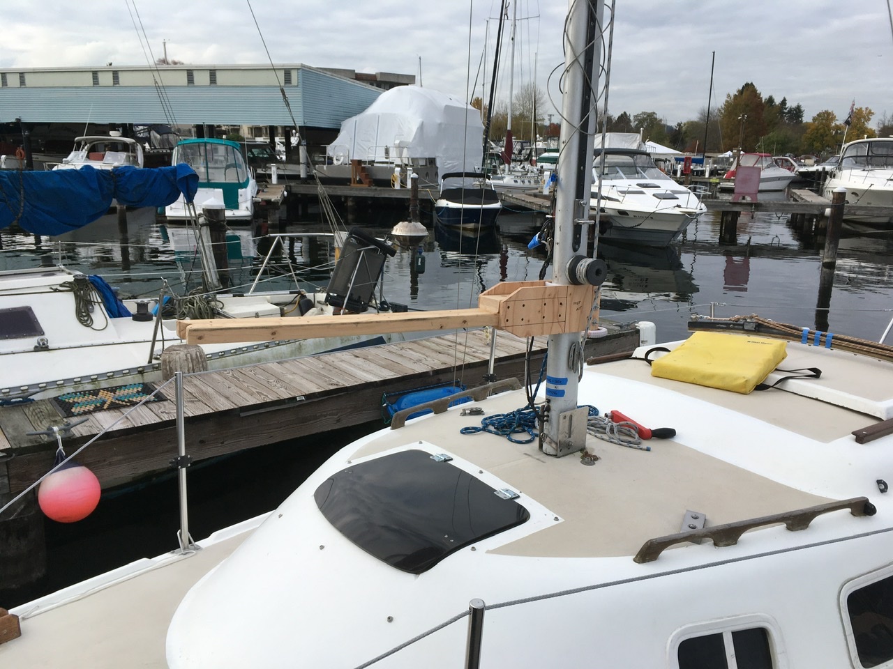

Mast lowering went as planned. Thanks everyone for the advice. To get it raised, I will have to extend the “pulpit leverage pole” by 2-3 feet, but at least it came down okay with no damage and no injuries!
