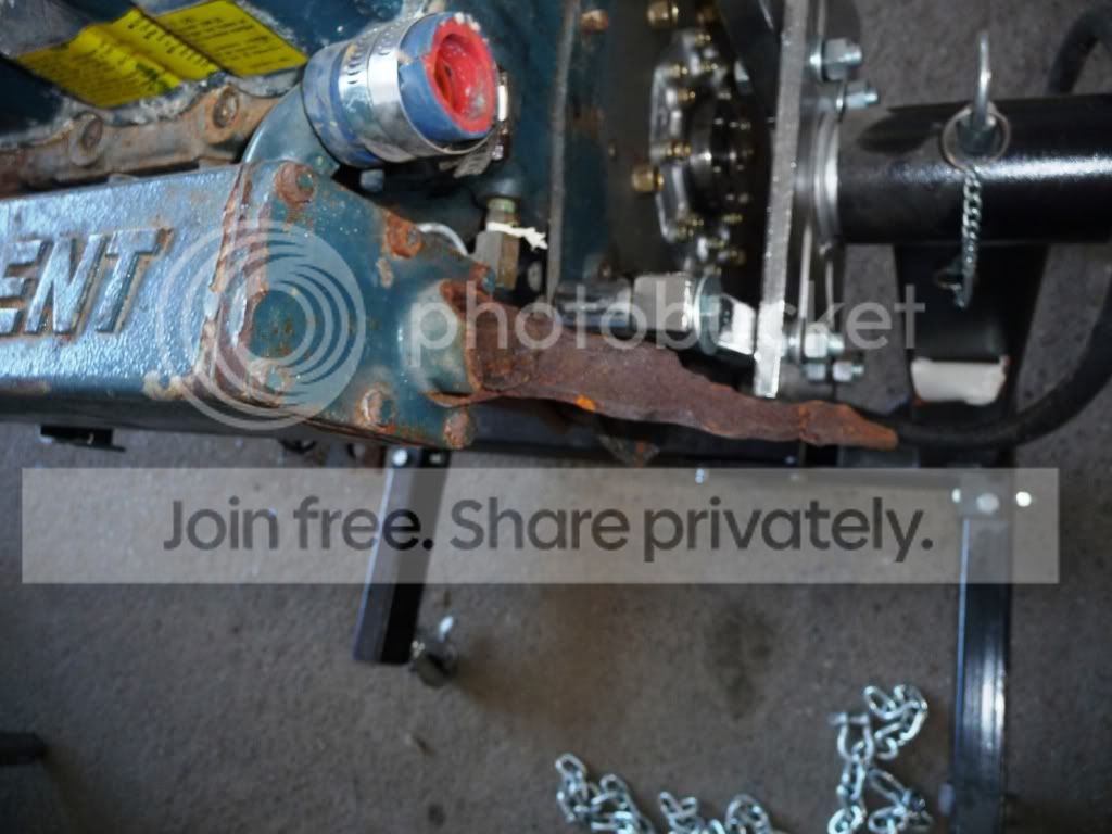

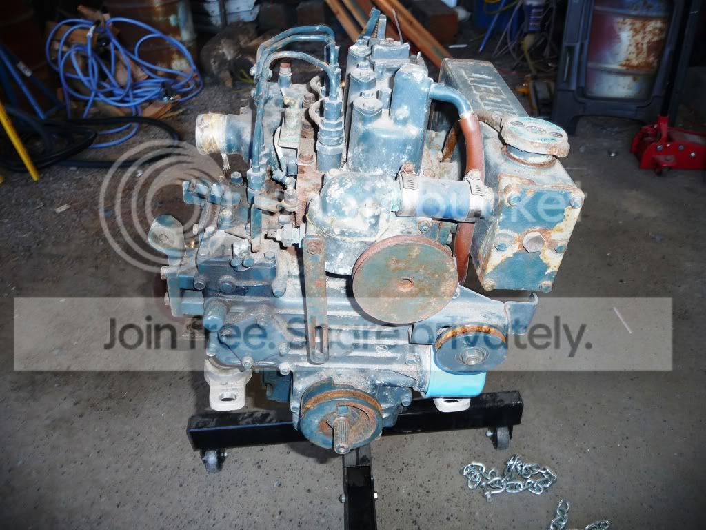

Ah yes, the restoration of Lady J starts in earnest. First we pulled the little Kubota that hasn't fired in over 18 years.
It spins freely, seems to have good compression and has both compression relief and glow plugs. My big old Perkins has neither. The heat exchager is toast.

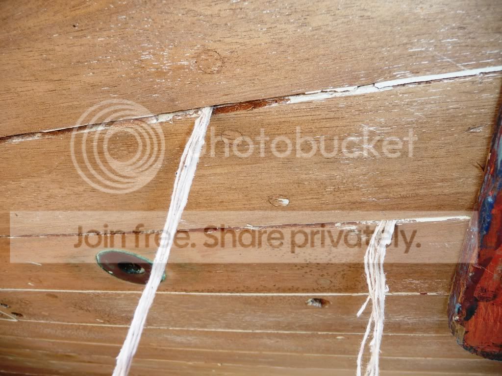

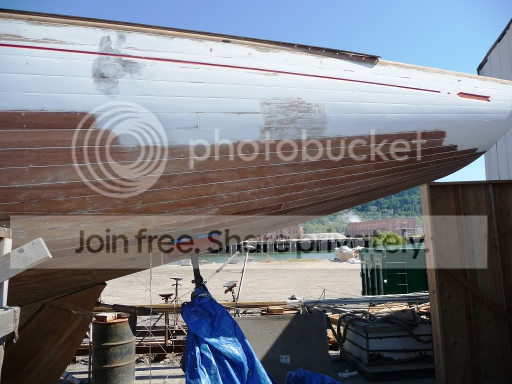

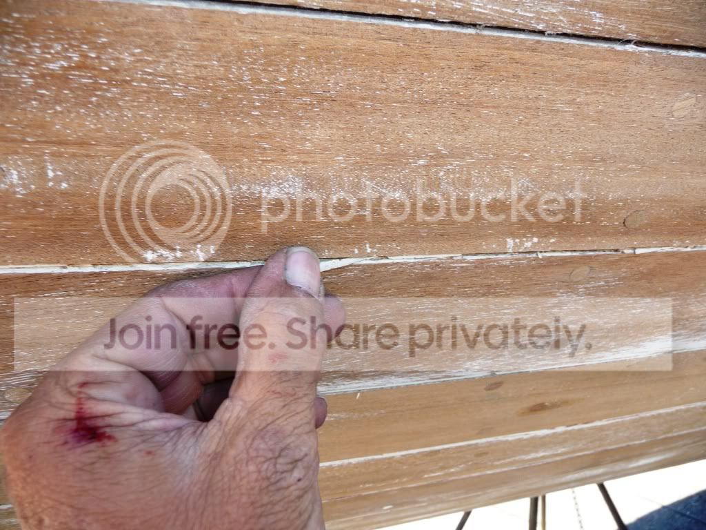

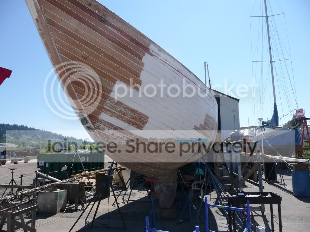

While the boys worked with heat guns on the paint, wooding the old girl, I went after the seams. This job is not entirely painless.
The compound the previous folks used is like an epoxy, hard as a rock and sticks well to the wood on whatever side it stuck to. I have to chip it loose and then reef it out. I'll post a video tonight showing the painful, tedious process.
Sometimes I get lucky with a long run, usually not...

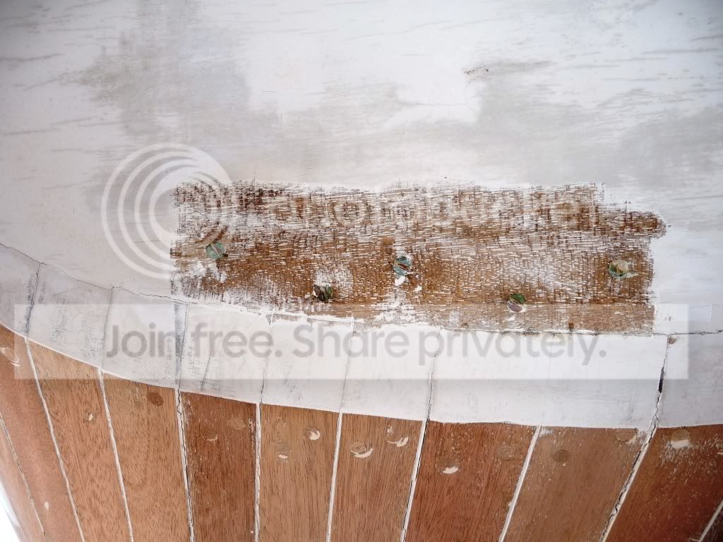

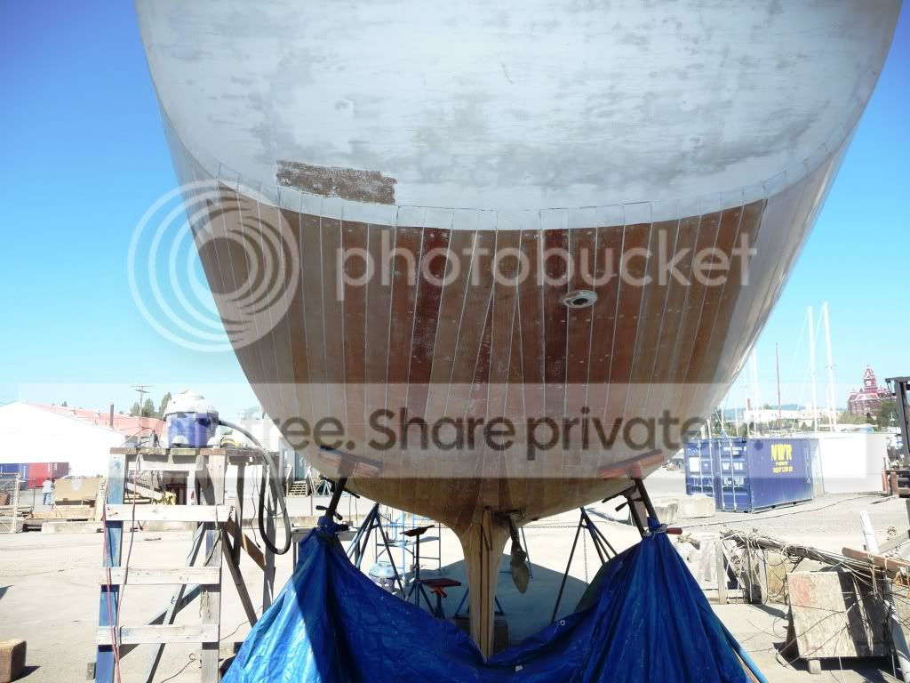

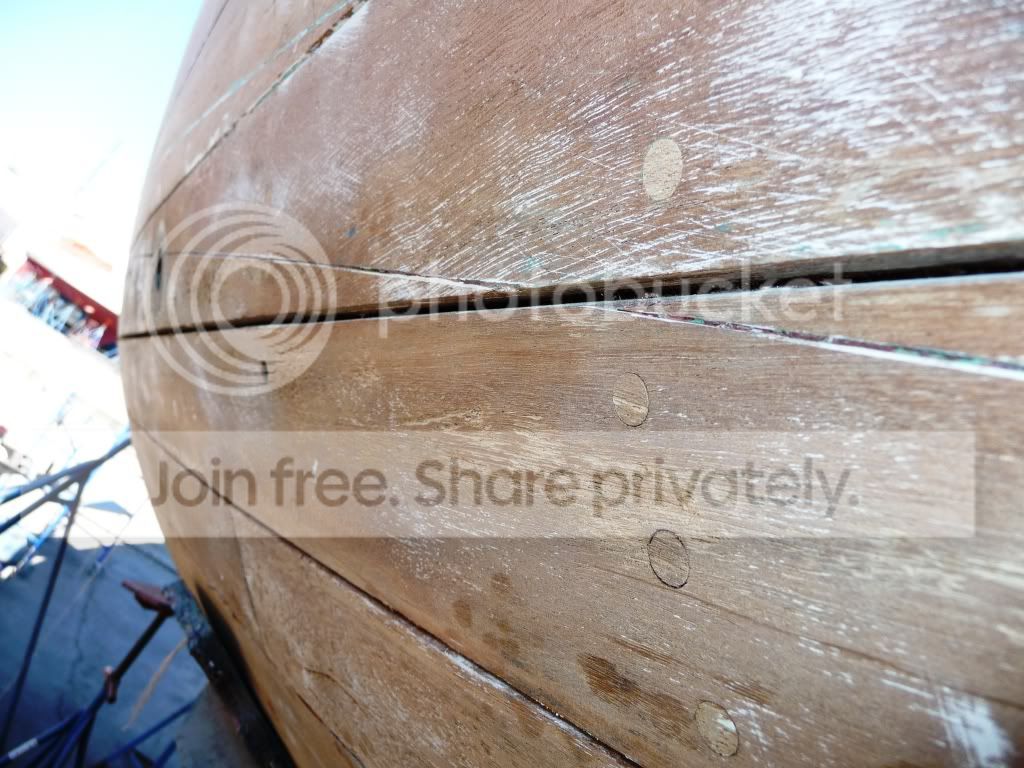

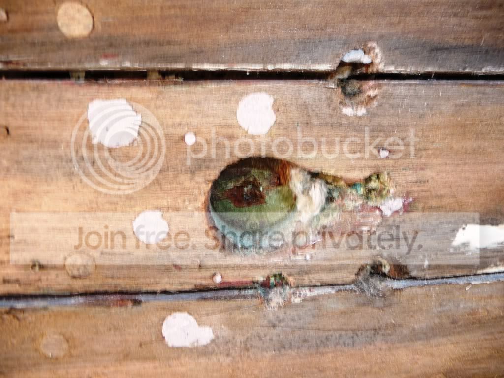

There were some dubious repairs done to her in the past, such as this thru-hull plug with fasteners set in seams. I'll have to scarph in planking to fix that.

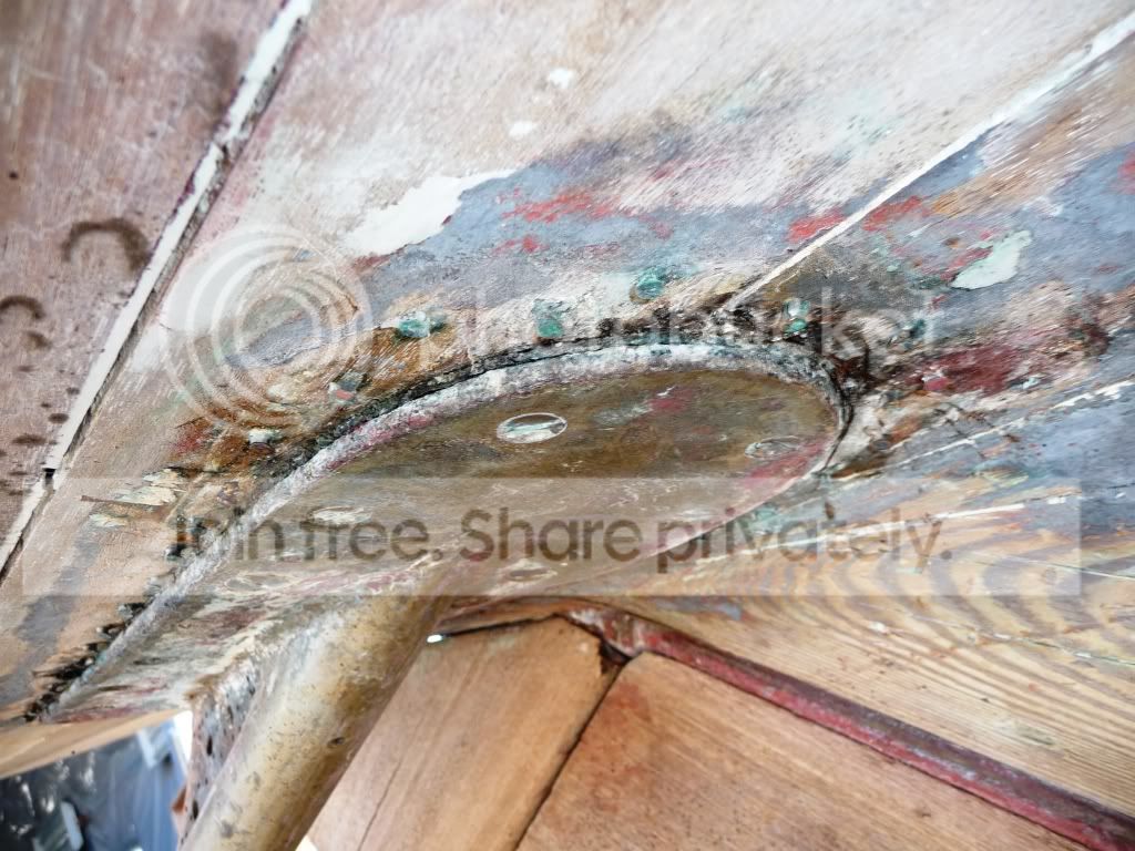

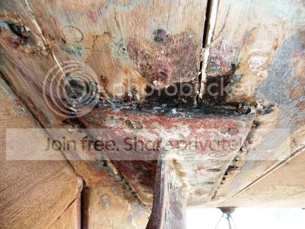

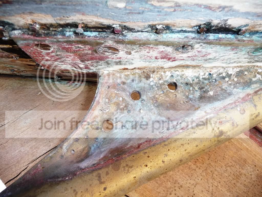

They also has drilled holes in the shaft strut in order to make sure the goop they faired it with stuck. C'mon..., drilling holes in perfectly good, irreplaceable bronze for THAT? Somebody needs an a$$kicking...
Of course, the goop they stuck on caused it's own issues that I'll have to deal with.

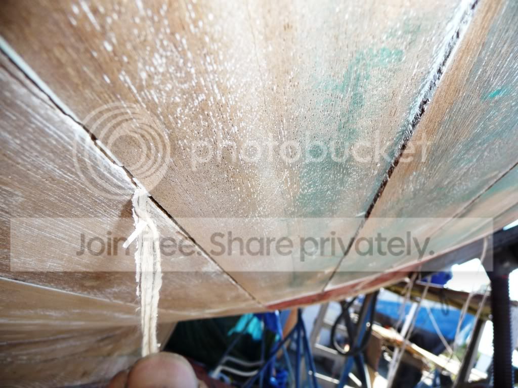

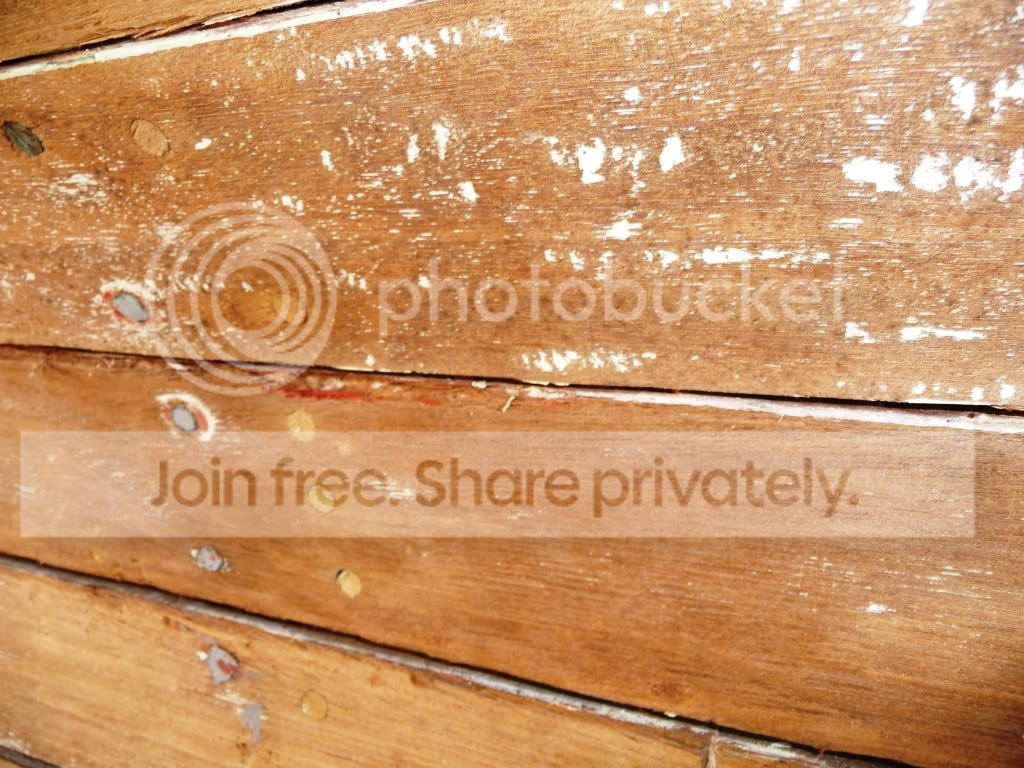

The seams do clean up nicely, if well opened. Seeing as how see has 9" centers on the ribs, I'm not worried about caulking too hard. This is the best built Kettenburg I've yet seen, much stouter than the K-38's or PCC's.

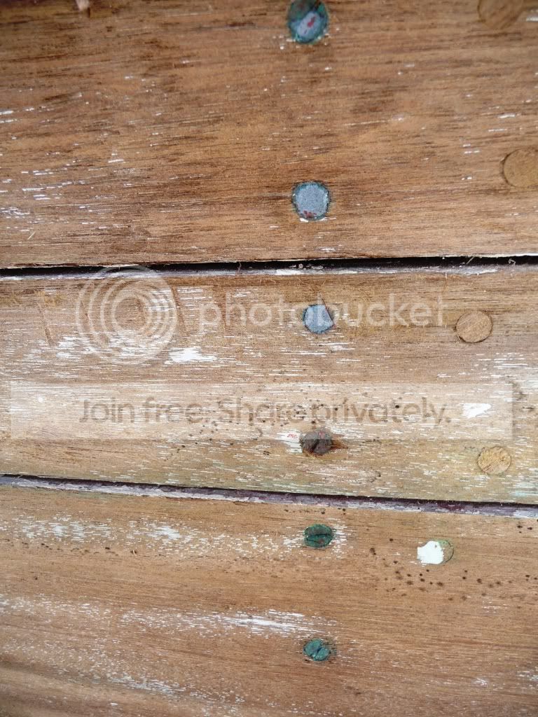

More shoddy work in the sisters and transom where they didn't sink the fasteners enough to set bungs. I'll have to fix this, especially on the transom where she'll be bright.
The boys have been making good progress as well.
So, all in all, it's been a bit tedious but steady. She'll go inside the shop next week for further work as the yard gets nervous with all of the scraping and carrying on we're doing. We do vacuum up a couple times a day though. Yes, that's right. We vacuum pavement and dirt to clean up the paint chips. I reckon we have the cleanest dirt in the PNW....

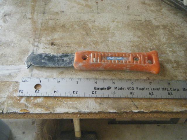

Charlie they make a carbide tool for scoring and breaking laminate. It is cheap and I think that it may be about the right thickness for reefing those seams. I can do a pix if you want.
Ross
Jun 15, 2004
14,693
Sure Ross, nothing like another tool in the arsenal...
This are it. The thickness is about 1/16 and I keep it sharp with either ma siliconcarbide stone or a diamond hone.
Edit to add : I think that one was sold from the ceramic tile department for scoring cement backer board.
