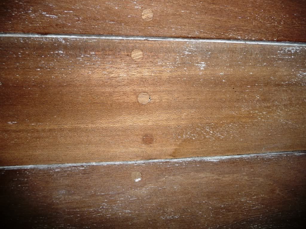

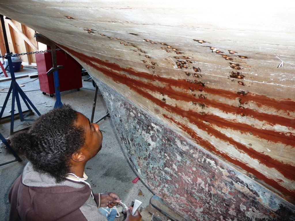

After I bought two more multitools (Rockwell) the job of clearing out the old seam compound went much faster with three guys working it. I was still using my tool for rib replacement. We used a semi-circular sanding blade to get all of the residue out and prep the seams. Yesterday, we started paying the seams with cotton, both eight strand and cotton. Some of the places where the seams close up, you'd have to separate strands out and do those only to rejoin strands when it opened up again.

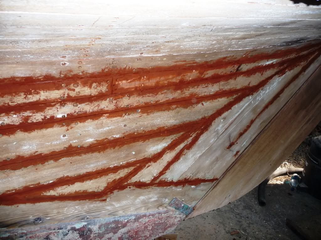

This afternoon, I started applying seam compound. Nasty, NASTY stuff to work with. Very stiff and clay like. It doesn't like sticking to the inside of the planking and will sometimes fall out just when you think ya have it set. Very oderifous as well so ya know you've been at it too long when ya can't smell it anymore.
Yeah, that's pretty ugly but I'll clean it up tomorrow after it's cured a bit. Jay was on the same side still paying seams further up the hull.

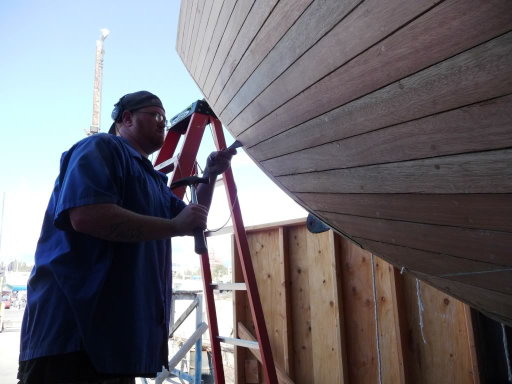

He came in with a Samurai topknot today, interesting doo. Zach was forward finishing the seam along the stem post that runs all the way from the back of the keelson.

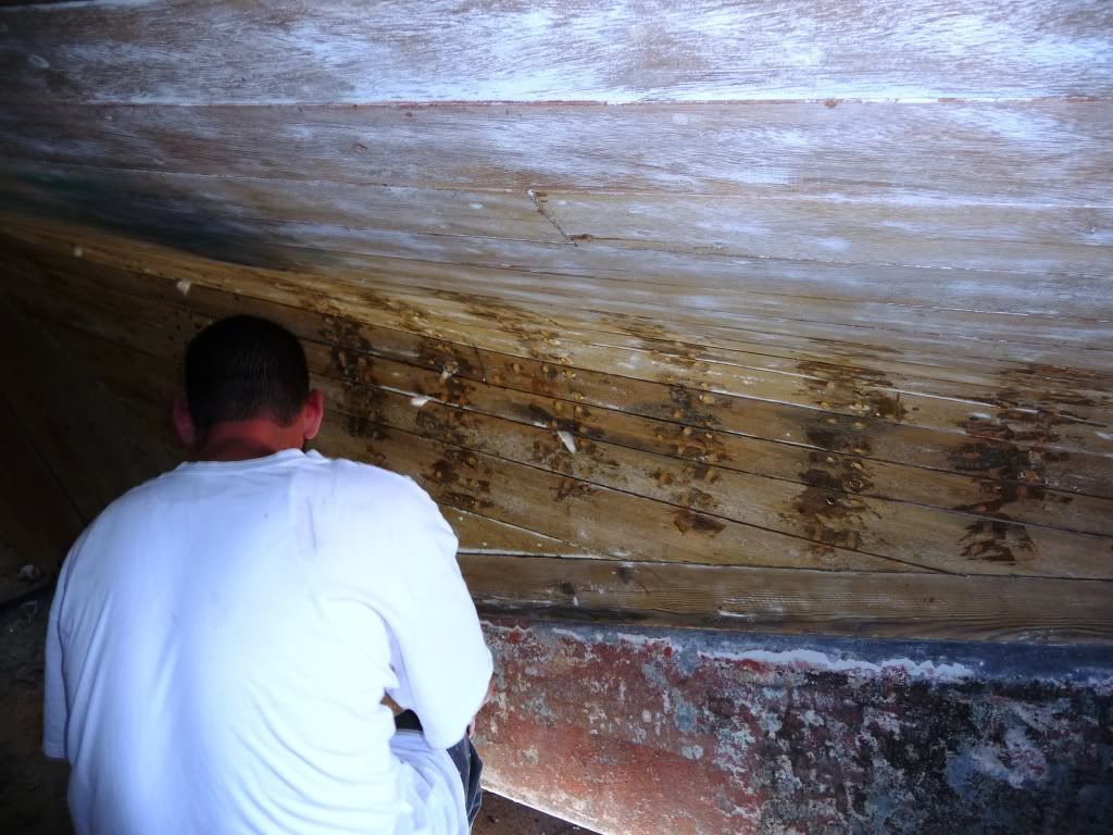

Charles was hanging out by himself to Starboard working seams.
