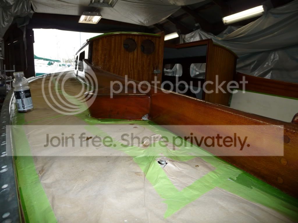

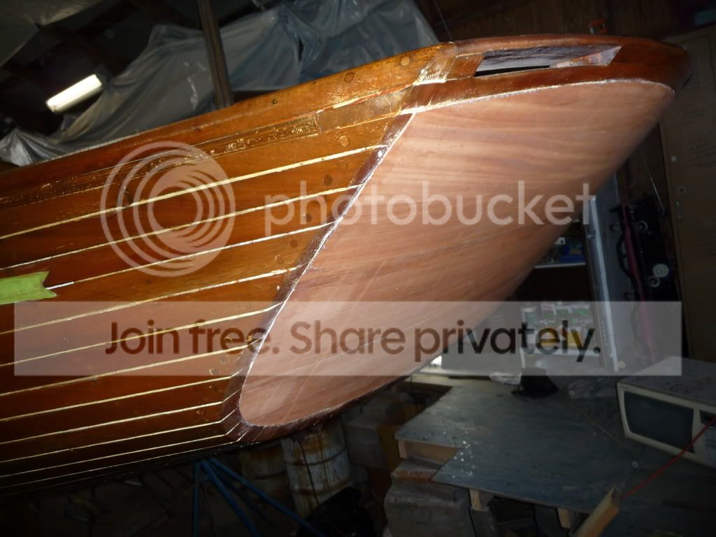

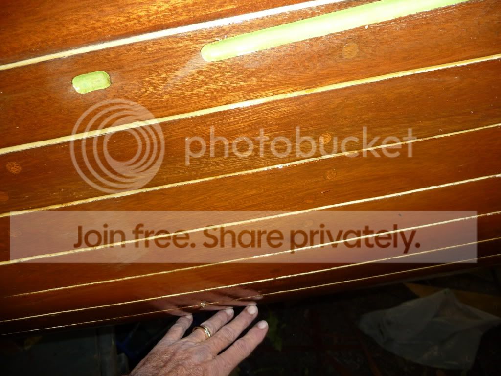

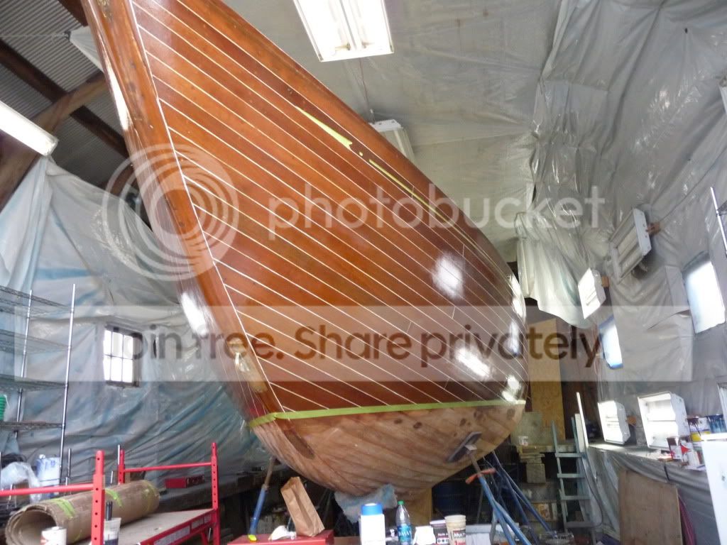

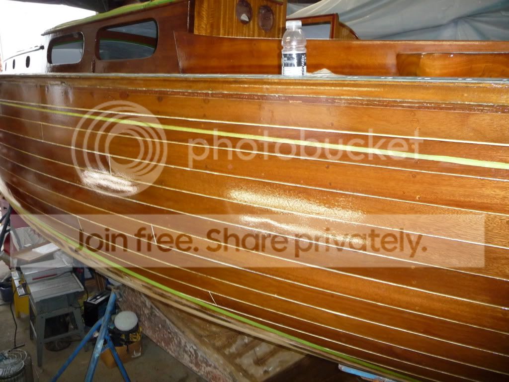

It's been a while but I waited until I had a bit of something to show. Progress is a bit slower now without the major changes. We've been laying varnish on her and inside as well. The hull has four brushed coats so far and will get at least one more before we block her smooth.
Once she's blocked down, I'll start spraying her.
The varnish surface is almost where I want it before we get it perfectly level.

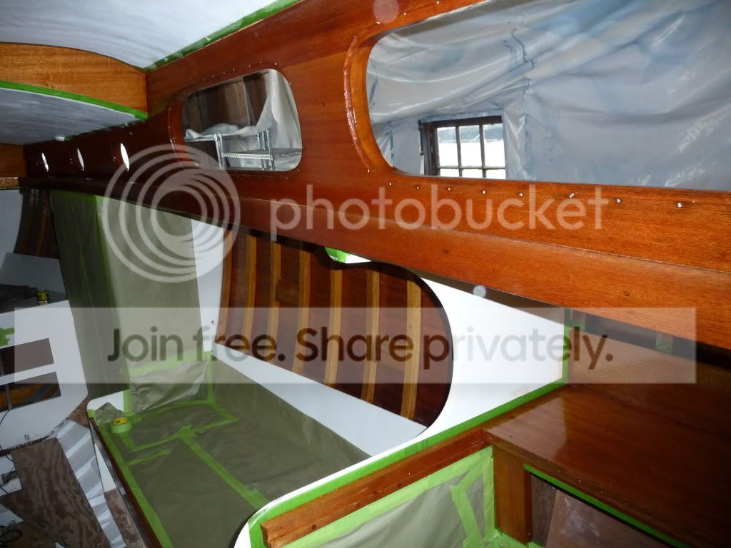

The interior has three coats and will get two more before blocking and then I'll spray it as well.
The exterior is about the same as the hull at this point.
It's coming along...

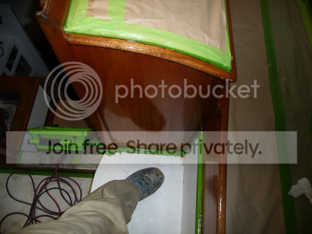

I did manage to get the veneer on the transom. Here's the before.
The after.
I'll detail it, stain, CPES and epoxy it before we start the varnish regime. We have some catch up to do on it. All in all, just getting things done or waiting for wood. The engine will be done within a couple of weeks, hopefully. The electrical is waiting for Blue Sea to finish the custom panels.

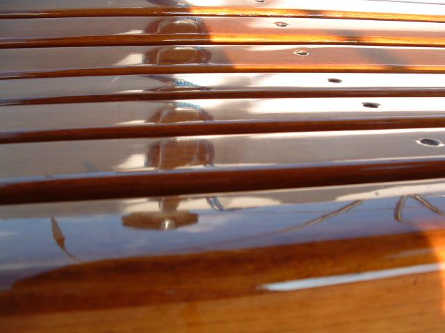

Ah yes, Penetrol, so do I. I'm spraying with an HVLP rig turned up to 22 PSI with the varnish thinned by 5% and Japan Dryer added. I sprayed the other day so I'll post up some pics soon.
