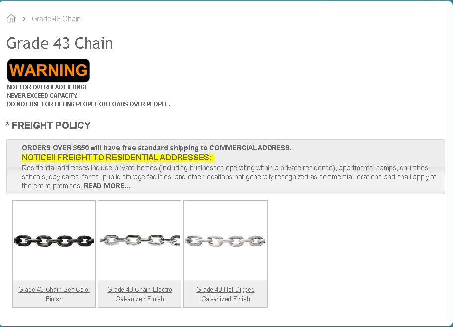

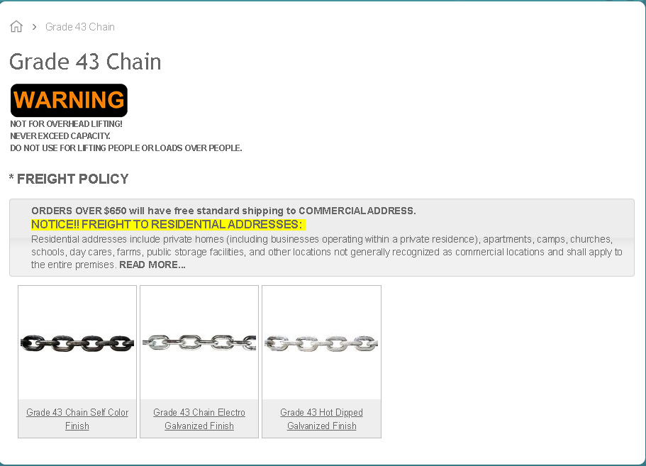

Here are the three finishes I have found on G43 chain.
The only one you want, as you know, is HDG for anchor chain...
By the way - if you are going to buy chain, look at my post above this one... during purchasing is when you want your ducks in a row...

I only purchase HDG. I only posted that to show that G43 is available in three finishes. As I stated in post #4, you want the one that is rough and dull because the electroplated is shinny and pretty [for a short time] before it rusts to pieces.
Yes, but the visual difference between mechanically galvanized and hot dipped galvanized is not at all easy to see the difference by looking at it.
Sure, but that is G43 chain in general. If you look at their specific G43 (and G30 and BBB) anchor/windlass chain sizes, they state these are only made in HDG and self color finishes. No electrogalvanized for them. Strangely, that wording about finish is only in the broad overview of windlass chain. If you actually go to the pages of the different types/grades/sizes of windlass chain, all of them state they are HDG.
So if you have a windlass, and order windlass chain, it is not possible to get anything other than what they represent as HDG. There is no way to get electrogalvanized chain for a windlass.
Unless they are lying through their teeth and ripping everyone off like dLj proposes.
