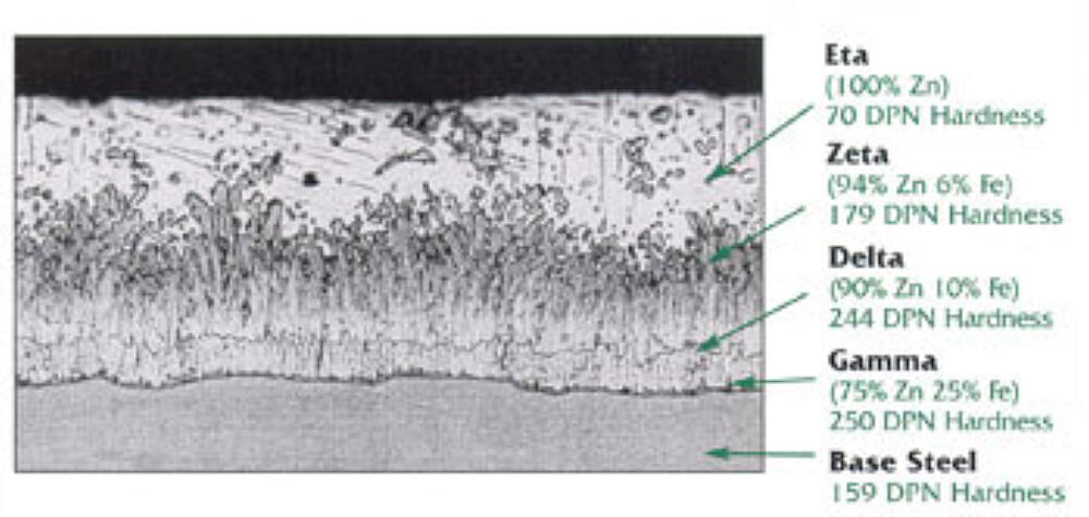

Like I said, short of doing a metallurgical analysis on the chain links, there is not a lot more I can say.
The physical external appearance of the chain cam vary. We used to make HDG nuts and bolts - there were tricks to getting the outside surface right in terms of smoothness and the consistency of the coating thickness so they would thread together correctly.
I'm on my cell phone at the moment so I'm not sure how well I can drop in info... Let me see....
Ha! Got it! OK - that shows the metallurgical structure of HDG. Note a couple things: the approximate compositions and the hardness values. O don't know how familiar you are with different hardness scales, DPN is diamond pyramid hardness. It is really the only "universal" hardness scale which is why it was used on this photo. Eta is what is formed in all galvanizing processes. 70 DPN is very soft. It's actually below any hardness value in the Rockwell B scale which is below the Rockwell C scale. It is the lower layers, the Zeta, Delta and Gamma layers that make HDG unique.
Those layers will not form iron oxide that would appear as you have described swelling and not allowing the chain to run through the gypsy. In fact as the Zeta layer wears, and in chain it will do so rather quickly especially at the link to link points of contact, these harder lower layers still provide corrosion protection. They will get a rusty appearance, but it will just look like surface rust which in fact it is. It is the small iron content of these layers turning the surface into a rusty color. But your chain links are in fact still protected because of the zinc content. These lower layer are much more wear resistant than the Zeta layer and can last quite a long time.
It doesn't matter what the HDG process is - every single one of them produces this structure. You can increase or decrease the size of the Zeta layer, you can adjust your costing parameters to change the appearance of the Zeta layer, you can add finish coatings to that Zeta layer, but you aren't changing the existence of those lower layers. They are a fundamental part of the process.
I didn't say they swelled - only that they no longer fit the gypsy. The problem was the link size got to be outside the margins of the gypsy pockets and it would skip and bind. Eventually it did rust to the point of flaking off and binding into a ball that needed to be pounded apart.
Forget Acco for a moment - how do you explain chain going bad at all? If the bottom layers are so hard and protect against all but surface rust like you describe, why do we ever need new chain? Why does almost every anchor locker that has seen a change of chain have flakes of rust on the bottom?
If instead, chain can indeed rust out to the point of being unusable, why does cheaper HDG chain do so faster/worse than more expensive chain? For example, Peerless sells an economy version of HDG chain that demonstrably (from reports and reviews) lasts shorter than their more expensive HDG chain. If this is all true, then why couldn't Acco chain be less robust than say Maggi or Laclede?
I'm not buying that all HDG chain is the same quality and will last almost forever. Every single piece of usage evidence supports the opposite.

Will you better explain this statement?
"Those layers will not form iron oxide that would appear as you have described swelling and not allowing the chain to run through the gypsy. In fact as the Zeta layer wears, and in chain it will do so rather quickly especially at the link to link points of contact, these harder lower layers still provide corrosion protection. They will get a rusty appearance, but it will just look like surface rust which in fact it is. It is the small iron content of these layers turning the surface into a rusty color. But your chain links are in fact still protected because of the zinc content. These lower layer are much more wear resistant than the Zeta layer and can last quite a long time."
It is confusing, as it implies that all HDG is the same, and that chain can't rust out because the lowest layers are too hard to be removed. Or at least it takes many years.
There is sufficient evidence that some HDG chains last far less than others.
Didn't mean for it to be confusing. First, I did not say the lower layers cannot degrade, they do. But they do not abrade away as the Zeta layer does due to their higher resistance to abrasion. There is also a known degradation process of these layers that does not fit your description of the problem you had with your chain. ALL HDG product has these layers.
How do they degrade? In very simple terms, the zinc component goes away through galvanic corrosion, and the iron component goes away through oxidation – rust.
Let's see. Now lets go to how does zinc protect steel in a marine environment. As I'm sure you are aware, the zinc component is an active element on the galvanic scale. Let's start with anodes. We put anodes on our boat in various places to protect metallic parts. We use different “zincs” depending upon if the boat is in salt water, brackish water, or fresh water. These “zincs” (technically they are sacrificial anodes) all have different actual chemistry – none them are 100% pure zinc. There are additives in varying amounts for several reasons. They allow the sacrificial anode to slow down it's galvanic corrosion, allow the corrosion product to not inhibit the continued anodic protection, and additions of like aluminum and magnesium are used to make the specific sacrificial anode chemsitry for the three different applications mentioned above.
Now, say you are putting an anode on your prop shaft. You don't put a sacrificial anode covering the entire shaft, you put one on that covers some small contact area of the entire shaft. But that small area of direct contact protects the entire shaft. Why? Because there is an area of effectivity around that anode where it's affects are sufficient to protect the metal structure it is attached to. In steel ship building, the placement and number of anodes used on the hull is a complex science. You need to design the number and placement of anodes such that the effectivity of those anodes cover the entire hull structure.
OK, now lets get to your chain. Chain is a very difficult application of galvanizing (creating a sacrificial anode over the entire surface) because of the abrasion and contact stresses chain is subjected to. The Zeta layer at the link connection points will wear away fairly quickly. You won't see anything there for a long time because of several reasons; the underlying layers are much more abrasion resistant, the zinc component of that layer continues to work as a sacrificial anode, and the Zeta layer present on other areas of the link also serve to protect that area. In this rather complex chain structure, we superimpose the fact there can be minor additives in the zinc used in the baths that specific manufacturers have developed to make their specific process “better” than a competitors. There can be coatings added to the chain after hot dipped galvanizing.
The truth is there may be some differences, but not major ones. HDG is a very well achieved process.
My fundamental problem with this statement is you have 0 evidence. You do not have a single metallurgical report that supports this claim. Nor does anyone else that you may have heard it from. It's all just hot air and people being pissed off – justifiably so, mind you. They thought they had HDG chain and it sucked. But it is highly unlikely that in fact they had HDG chain. Now, I can't say that with absolute certainty as I've never been asked to examine a case of this nature, but until someone can actually supply a correctly done metallurgical report that shows me the contrary, I'm not even remotely convinced. There are far too many other methods used on chain.
There may well be some HDG chain manufacturers that have some proprietary formulas that work a bit better than other formulas, but highly unlikely it would be to the extent that as an end user you would ever be able to notice without a very controlled scientific experiment – contrary to whatever marketing claims they may have....
