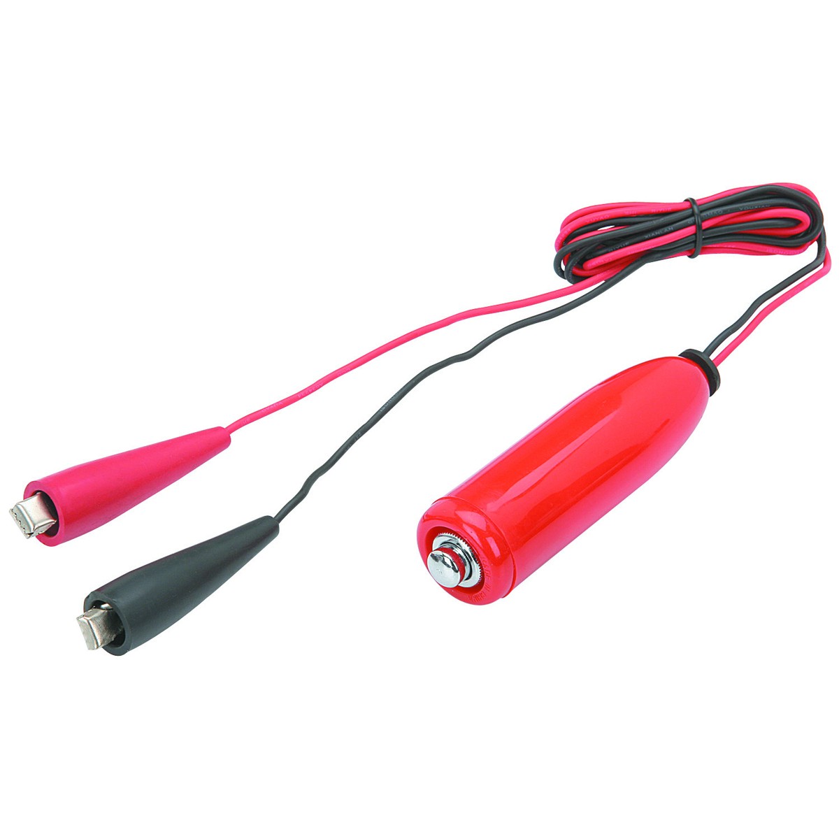

A) Easy way to test a starter is to buy a starter switch (see pic below) that attaches to the leads in the back and bypasses all but the power leads. Always good to have one aboard anyway in case your starter switch fails. This will isolate the outside problems and then it's either the motor or solenoid or electric feed. If you remove the starter and hook it up to positive and negative (laying it on a towel or such to keep it from moving if you don't have someone to hold it) and this switch, you can see the Bendix gear snap forward as you push the button. That means the solenoid is OK. The motor will turn with a lot of force (which is why it should be held, etc) after the Bendix gear has thrust forward if you have A) good electricity and/or B) it is OK. If it turns slowly or not at all, you either have a bad connection to it, bad/low batteries or it needs to be rebuilt. You shouldn't need any professional help to go through this process if you are a DIY person. If the motor does not do as above, take it to a shop and they will handle the rebuild.
