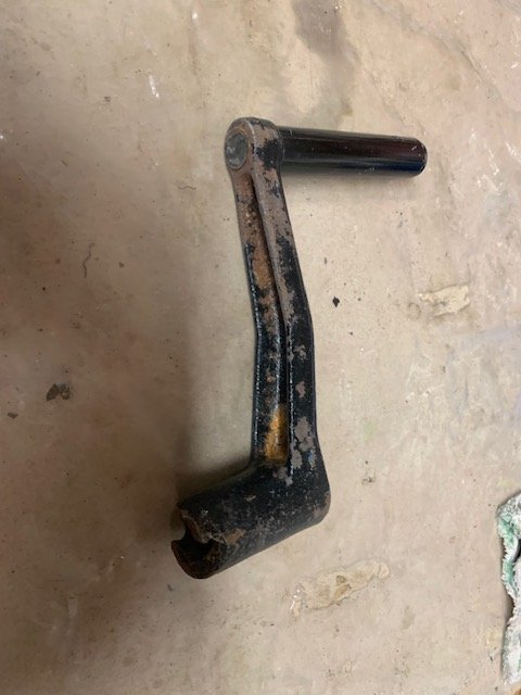

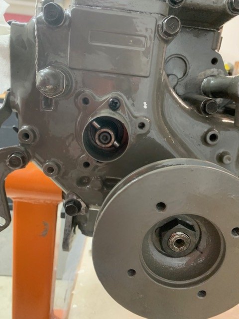

Those screws are Posidrive - not Phillips. The Posi bit looks like Phillips but the end of a Posi bit is flat - not pointed. The cam end (which the cover hides) needs to have a cross-pin installed. The 2GM20F (which is yours) did not come with a pin. So, you will need to make one for the hand start to engage. You will need a crank too. I have a spare or two. My back up starter is the socket off the hand crank, (handle cut off), weld the socket to a length of rebar, and power the thing with a battery driven drill - Makita, Harbor Freight, Milwaukee. As far as access is concerned just cut of the dome end of the cover. Pics below.

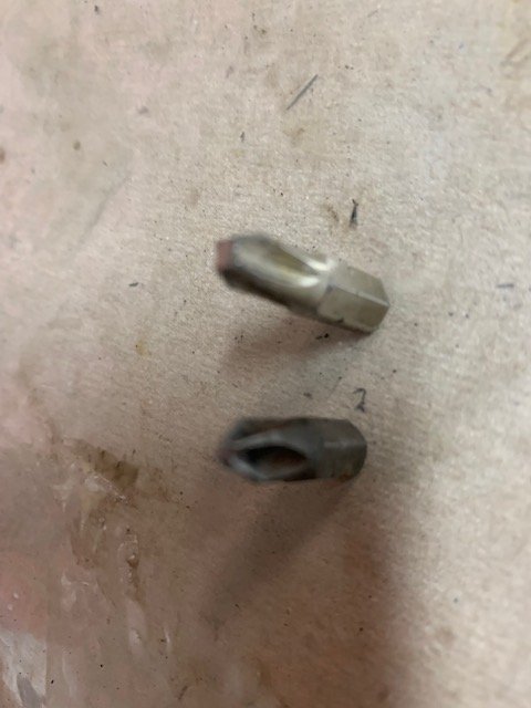

@Charles Erwin
Thanks for putting a name to that unusually shaped #4 screwdriver I used to attempt to remove the two screws. I've had that #4 driver sitting around for years now and thought the flat tip was a much better idea that the regular Philips but did no know it had a different name. In this case, it would have been able to supply enough torque to shear the head off of the screw's shank.
Unfortunately, I won't be able to WOW anyone in the near future by rattling off its name as I don't think anyone else knows or cares what a Posidrive driver or screw is.
