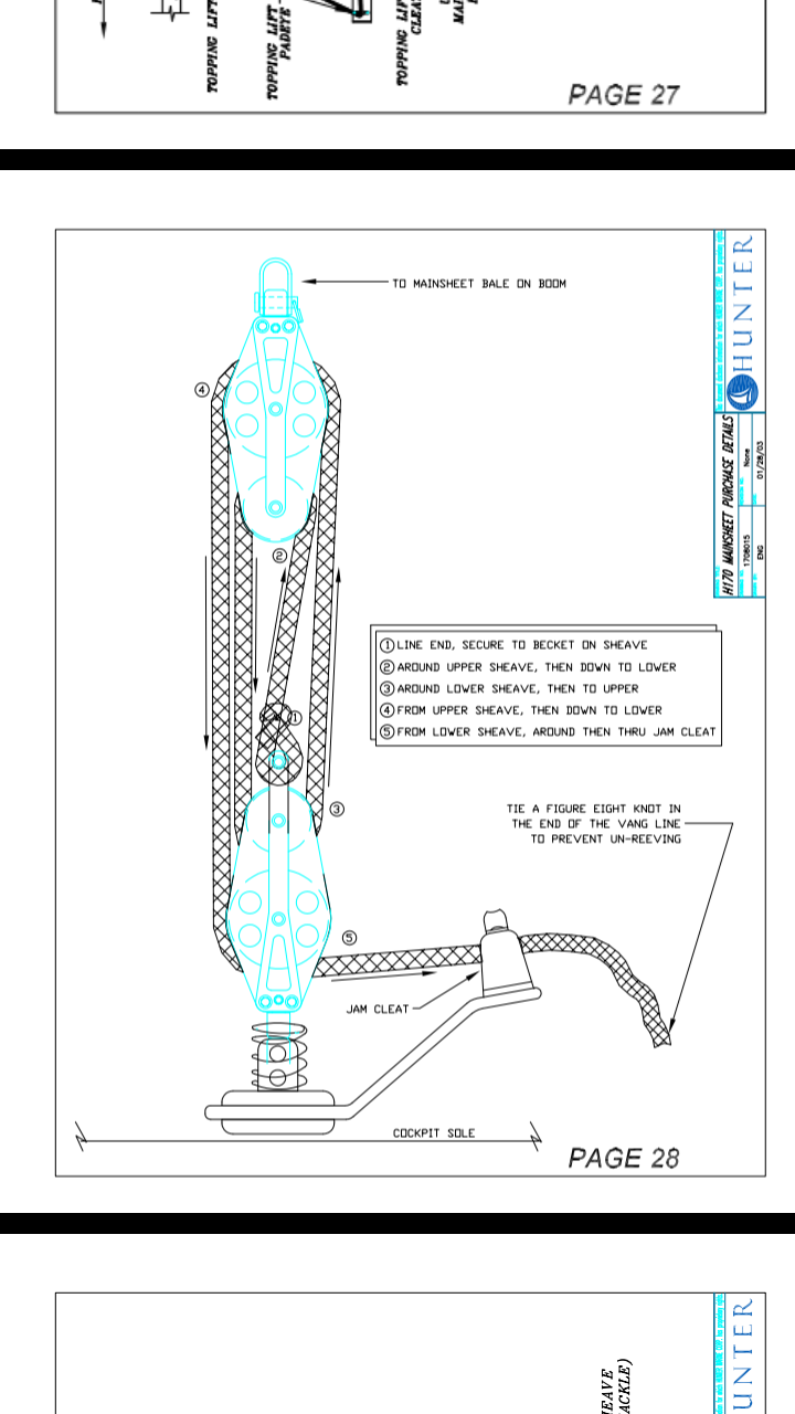

Here is a case where a picture is worth a million words.
Of course, they leave out which way the lower sheave one way switch should be set up. Should it keep the line from pulling out or being pulled?
Does that even get used in practice?

Due to the "excellent" documentation. i actally did install the rachet backwards.
Leave the rachet on most of the time. Turn off rachet for very light winds.
