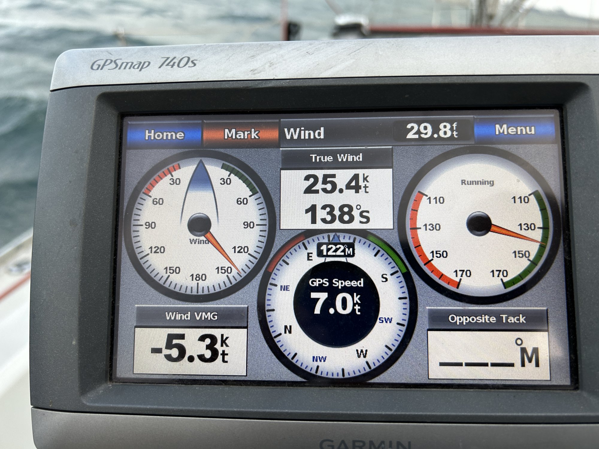

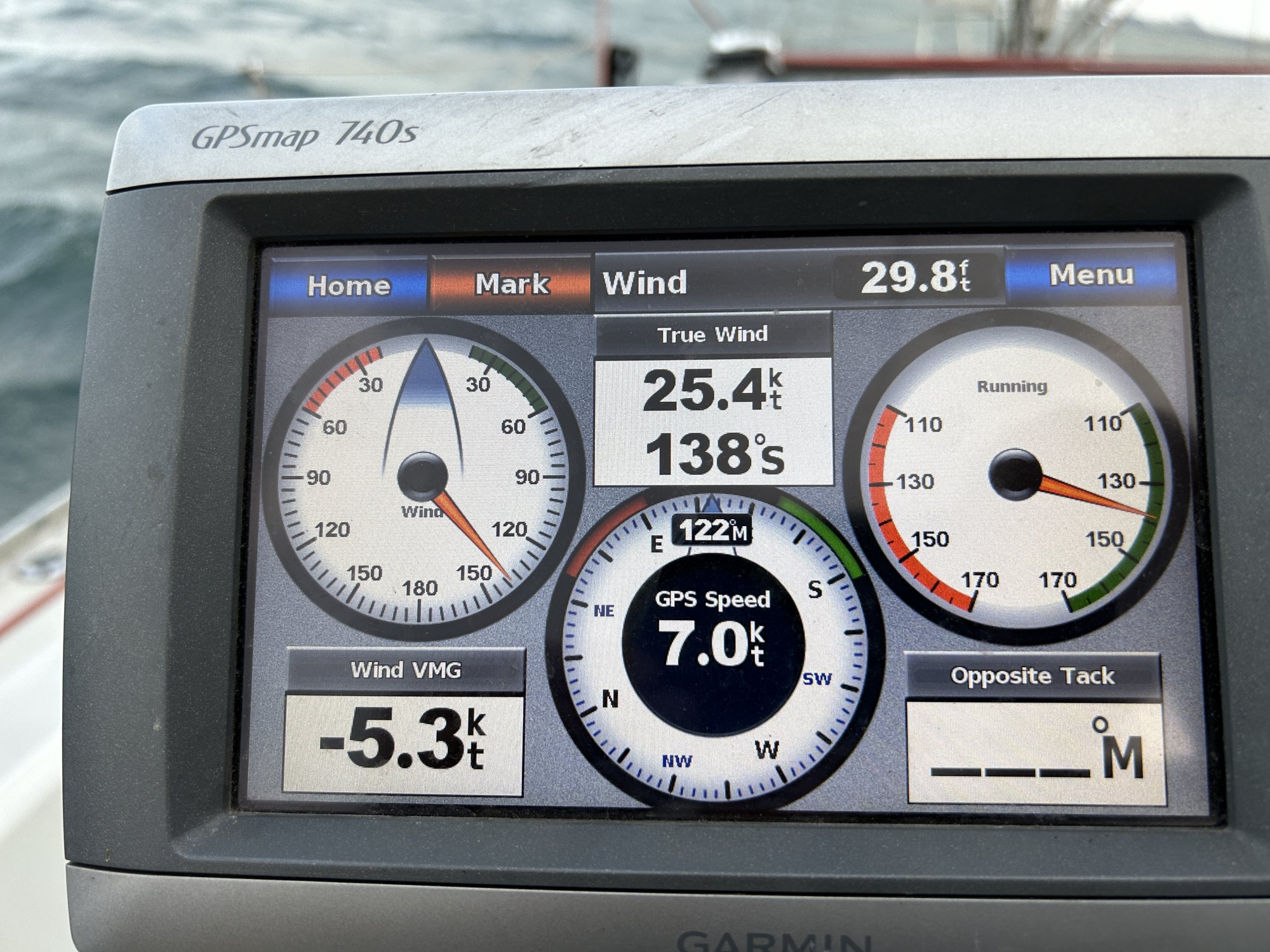

My boat had both a paddle wheel transducer/gauge and a GPS speed on my Chartplotter. My paddle wheel would be way off on one tack…as the boat healed over. i recently removed the display and I am just using the GPS speed. In Milwaukee, you don’t have to worry about tides and speed through the water (Much).
A chart plotter is a great place to start on your instrument package…it will have built-in compass, depth, water temp And hopefully can help, you get home in the dark or fog.
I have mine tied to my AIS-capable VHF radio via NMEA2000 network, so I can see all AIS targets around me.
I have a separate wind instrament (TacTic wireless) and after some trial and error and a wireless interface I bought used, I can also display my wind info on my chart plotter.
I also have a separate autopilot, and about the only thing I have set up is tying thre wind info into the AP…this way I can have the AP steer to a wind angle, instead of a compass heading.
