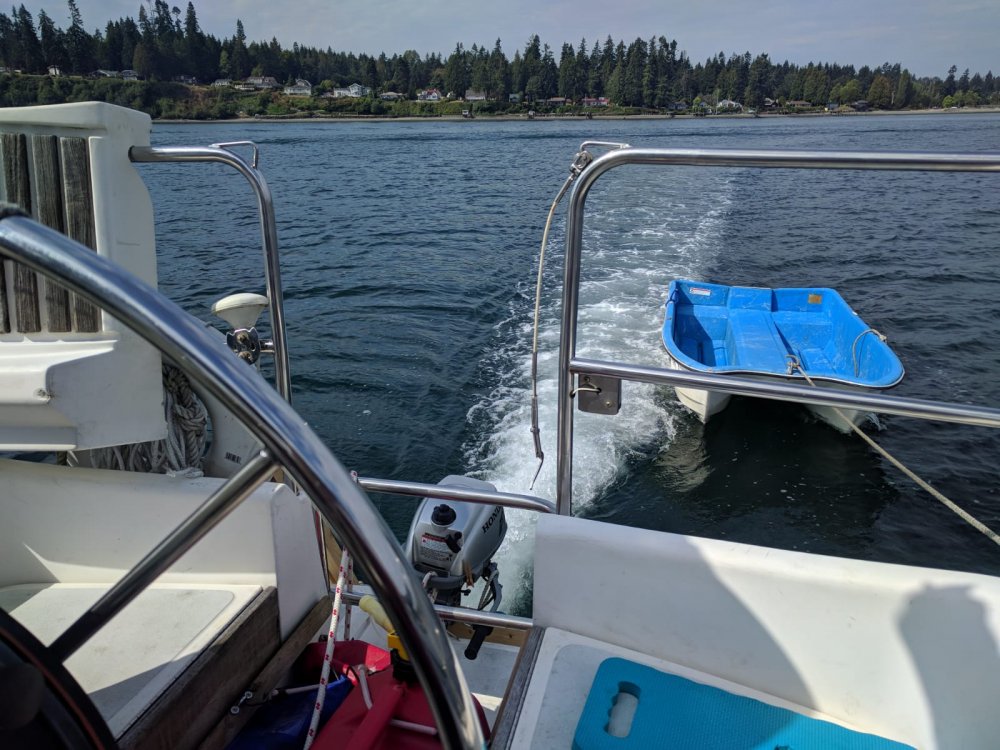

We just had a diver look it over. The strut is broken off just below where it attaches to the boat. He said there was no indication of hitting something. It's just resting on the prop shaft. I plan to jury rigged my dinghy motor to push it into my slip after I sail home. The forecast is light in the am then south 0-10 in the afternoon changing to NW 5-15 in the evening. It's N Nw 15 miles to our slip so it will be a while.

Sorry to hear of your problem, but glad to hear you have a plan to deal with the situation. Rigging the outboard and/or the dink have often crossed my mind in my "what if" thoughts. Towing your boat using the dink will not work. I tried that, and found myself swinging port and starboard in the dink as the tow line became tight. (No worries, my wife was at the sailboat's helm.) Pushing the sailboat by securing the dink to the aft port or starboard side of the sailboat might work. Is that called a Hip tow? Pushing from directly behind might work too. I often considered clamping the dink motor to the stern ladder. That would require step rungs that would be wide enough to secure the motor. Best Wishes for a successful docking.
