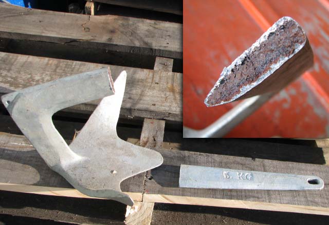

I bought a knock off Bruce, 33 lb. on ebay for $99 including shipping. It is one piece of cast with a hole in it. I don't fear in any way the it will some how fall apart. That is rediculous.
Not really so ridiculous..;) The original Bruce was heat treated the knock offs are not...
Photo courtesy Craig Smith

While the odds of you breaking a Bruce knock off are probably quite low, it has happened..

I am more concerned that the rode would fail before a 33 lb knock off bruce. That broken anchor is an 11 lb. anchor. There is quite a bit of cross sectional differnece to a 33 lb., but anything can fail. I admit I would rather have a forged anchor than cast by far. Before I take off on a serious cruise intending to anchor out alot, I will invest in a manson. From what I remember the rocna sizes go from 10,000 lb boat to something much higher with a higher price also. The manson has an anchor in between that covers my size boat.
