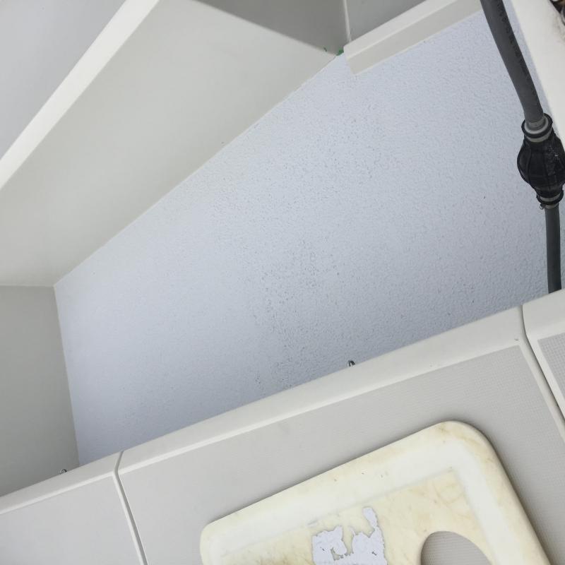

Figured I would share my latest project. The cockpit floor on my O240 had a lot of gelcoat cracks and a nickel size section that flaked off. The floor itself is quite solid. I decided to re-surface the non skid. I decided to go with the Kiwi product because it can be applied over top of existing non skid. In addition it's water based and people raved about its longevity and ease of application.
All in all it was easy to apply. It comes with a textured roller to make the non skid texture. The product is thick, consistency of yogurt and dries quickly.
My only complaint is the gray colored product looks more like a light blue to me.
