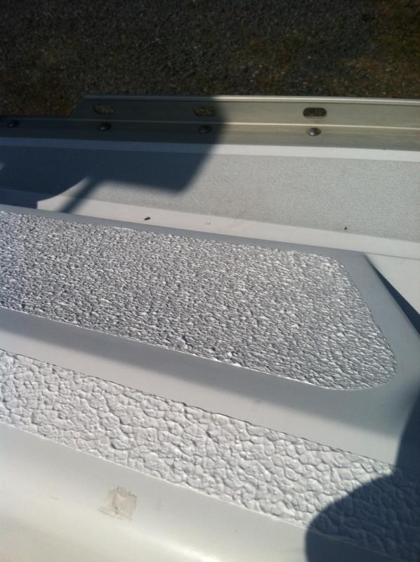

I have s shot of the surface finished. i will get more pictures this weekend as we have a bit more to do. This stuff is great to work with and easy to apply.
The picture KIWI 1 shows the finished surface and the existing surface. Existing is at the top of the picture and the two surfaces below it are the finished surfaces.

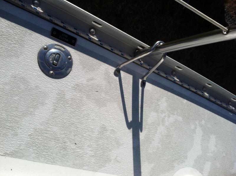

Picture KIWI 2 shows the deck before it got hit with the KIWI Grip.
