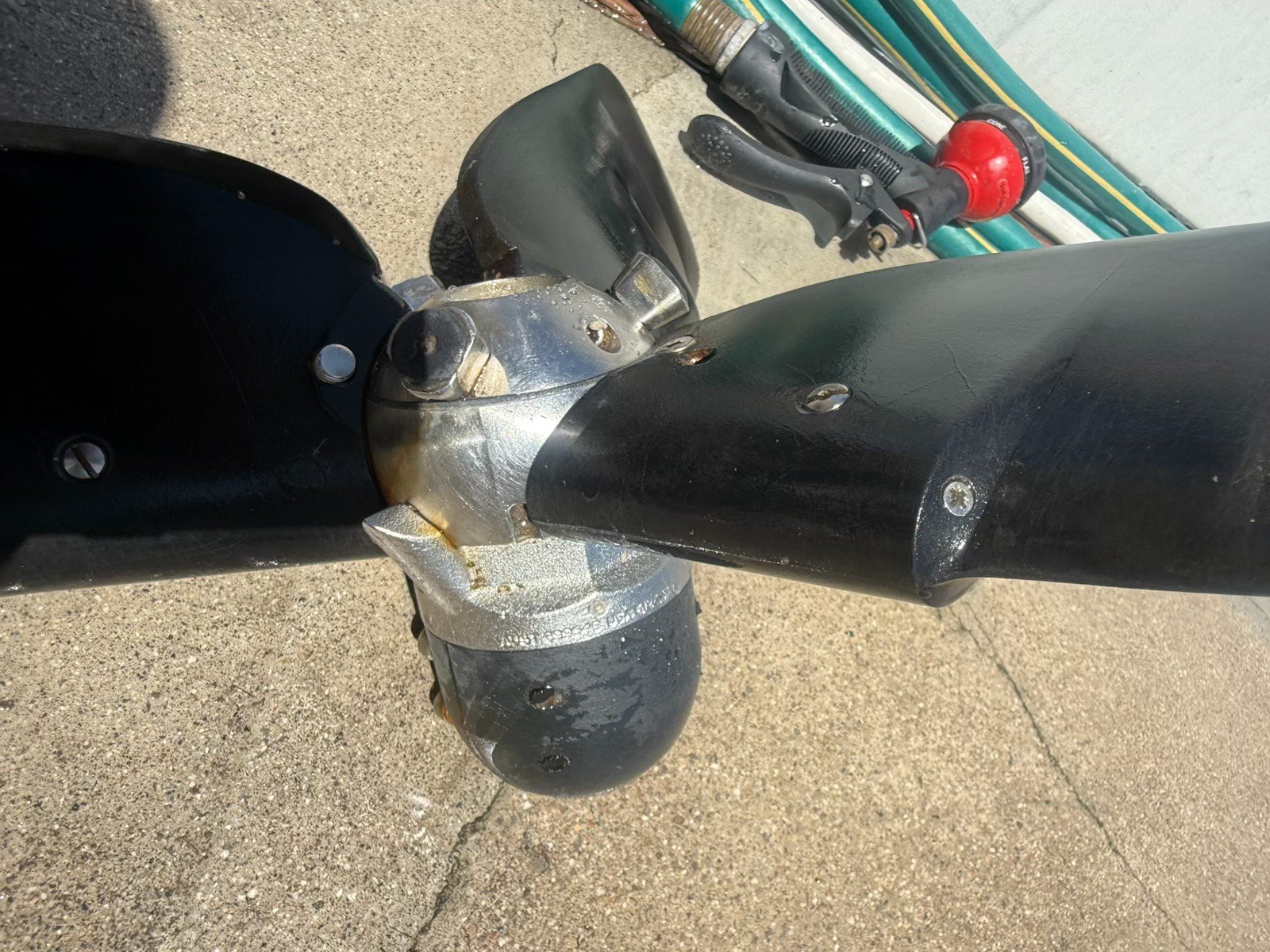

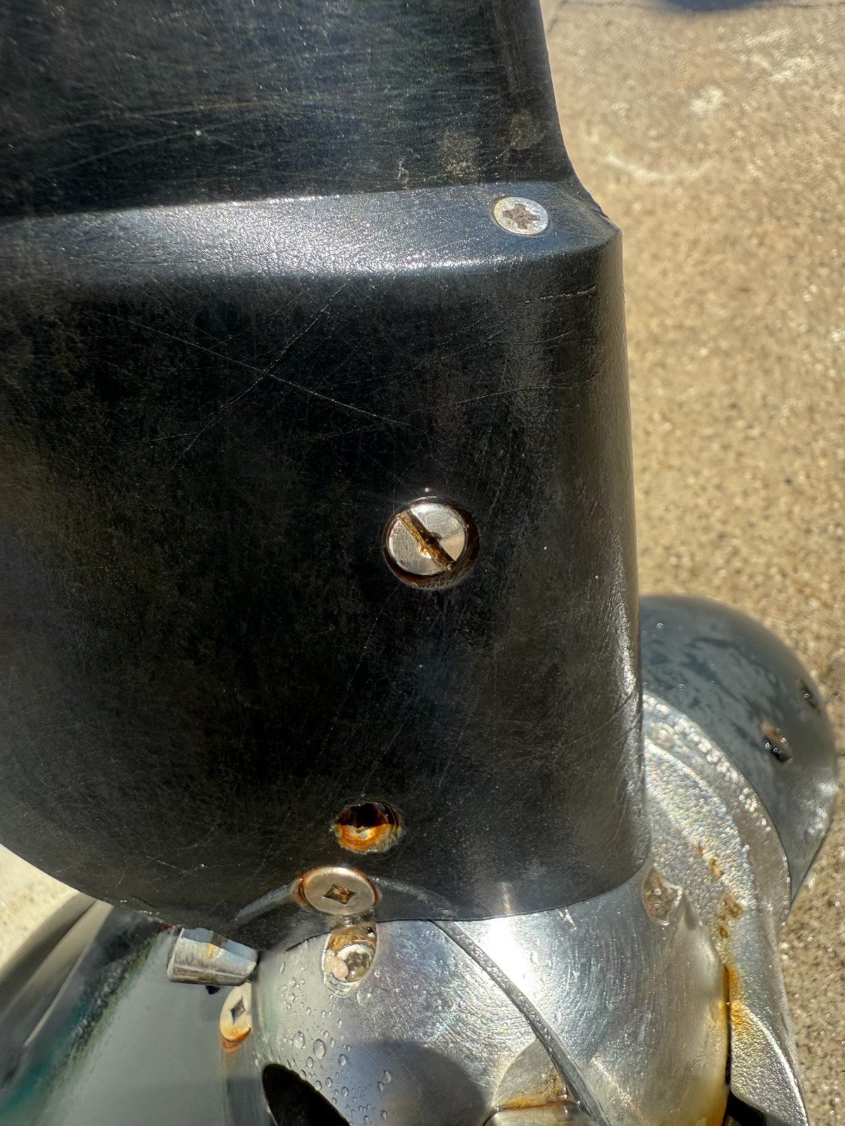

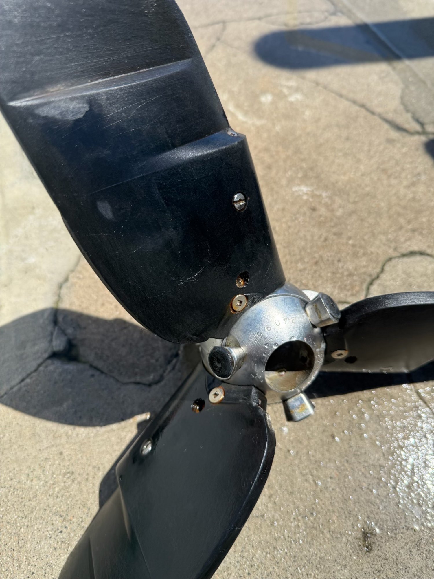

Hello we bought a folding prop from Kiwi Prop (out of Marina Del Rey, but was shipped here from NZ) They have refused to honor any warranty basically and just downright unhelpful so far. The keys/hardware are already showing severe corrosion which makes me question the workman ship for a $1700 propeller! Has anyone had any luck with using these for the longer term? any advice on how to keep from corroding? Or better yet any advice on how to hold manufacture accountable here?

The warrantee on the website specifically says that wear and corrosion are not valid warranty claims. They also suggest painting the unit with non-copper antifouling. Doing that might reduce corrosion. The blades don't look like they're about to fall off. How long have you had it?

Looks like rust. Stainless screws are probably 314 stainless or something else. Paint would help but not a guarantee. Care needed so that paint does not interfere with folding properties.

It looks like Kiwi used 304 or 18-8 hardware, these are less corrosion resistant then 316. You could replace them with 316 hardware. I don't see a "severe" corrosion, just some surface rust typical of 304 hardware.
Most of this prop is plastic, so corrosion shouldn't be an issue. Just the hub and hardware are not plastic. The hub is bronze.

It is a feathering prop, not a folding prop. I flicked through the photos looking for corrosion, and had to go back again to scrutinize them to see what your complaint was. There is hardly anything at all a problem there. Just a bit of staining around some stainless fasteners. This is not in any way "severe corrosion", and is completely normal - even 316 fasteners will do this. Take them out, clean them up, soak them in citric acid, and put back in with either locktite or tefgel, depending on what the manufacturer states.

The hub looks like cast stainless, but I don't know the prop.
Mark
It does look like cast SS, however I got the bronze info from the Kiwi website. The cast hub has not been finished very well, it is a rough casting.
