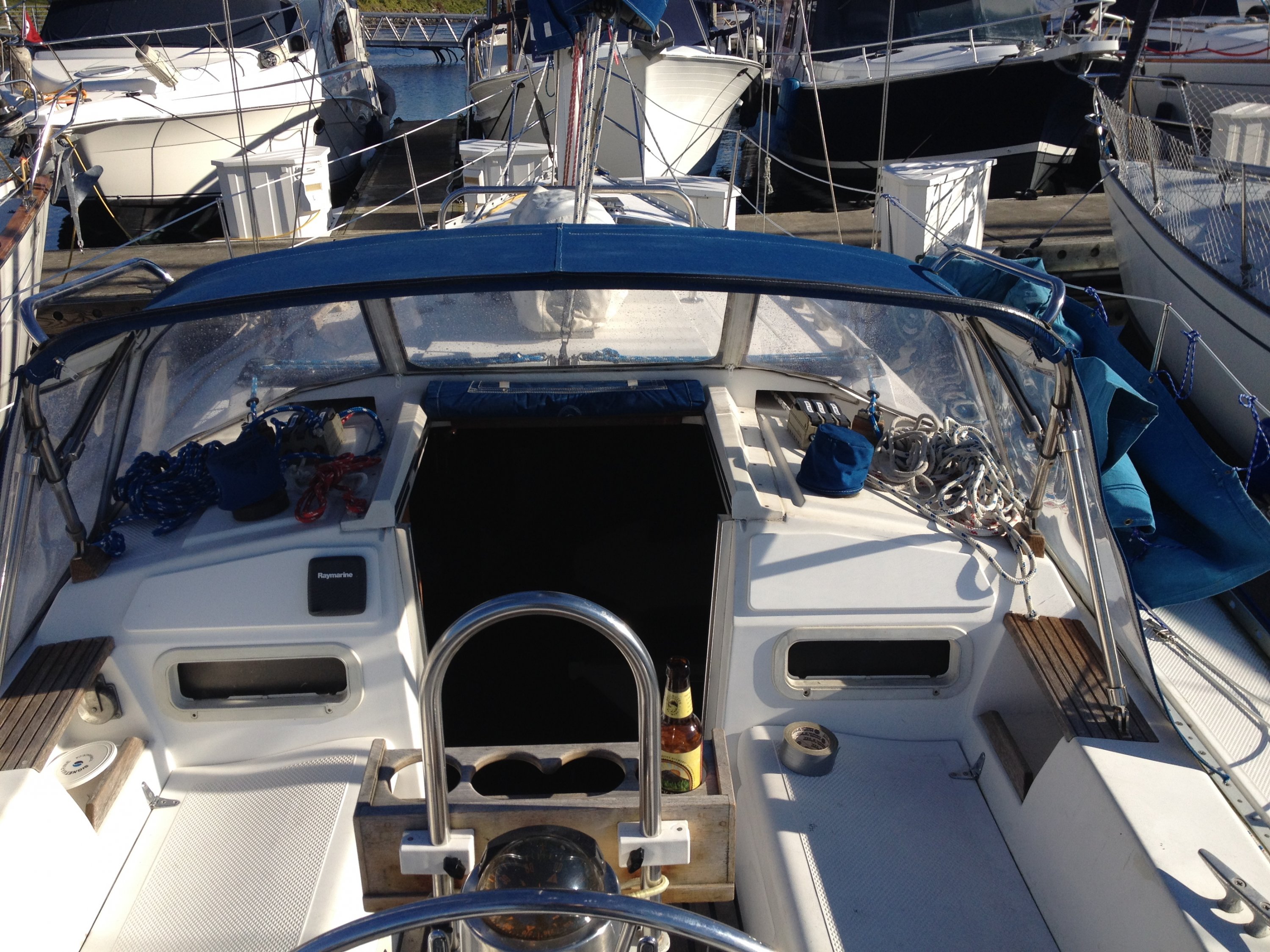

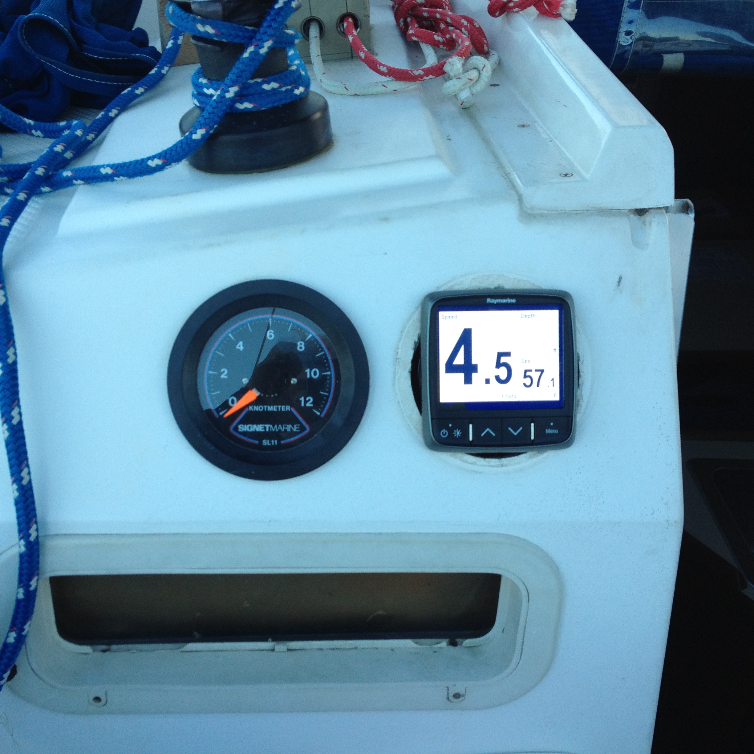

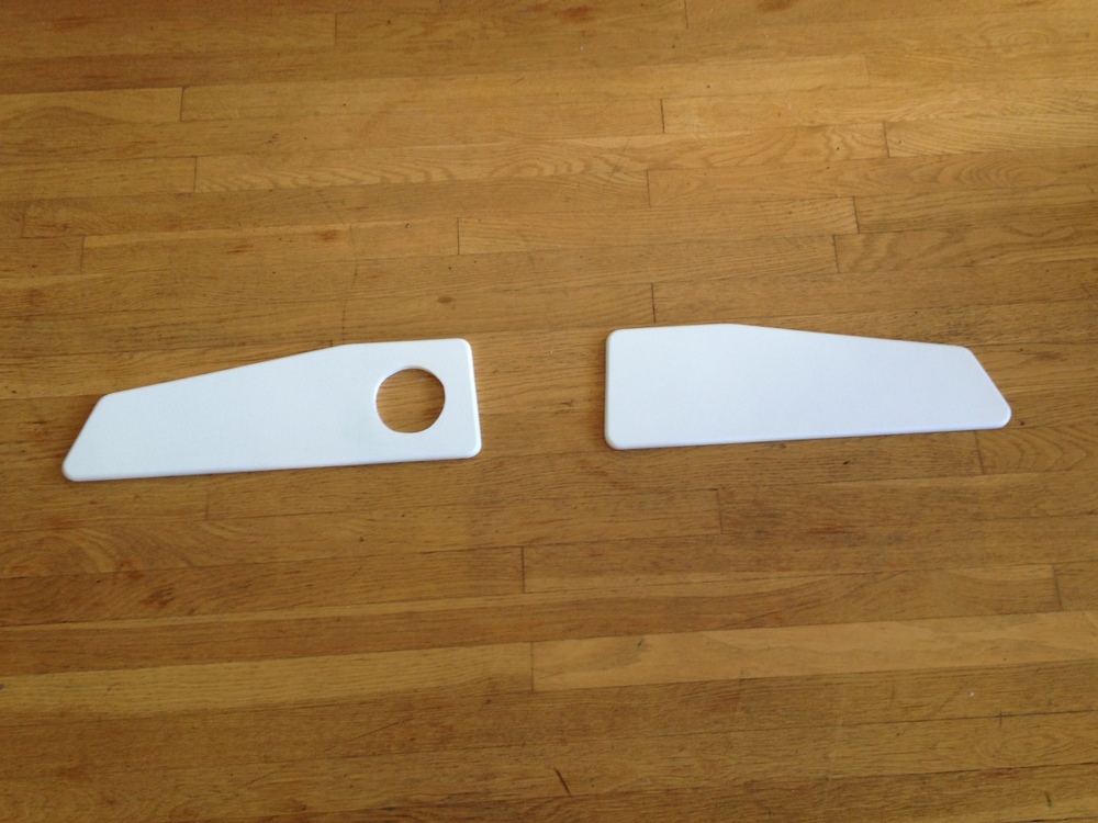

I used it to cover holes from old instruments in the cockpit bulkhead. I replaced old depth and knot meters with a small multifunction display so had a lot of area to cover. I came up with a 1/2" thick panel that followed the lines of the boat and added a mirror image one to the other side for symmetry. Installed with screws from the inside so no exposed fasteners. Sort of almost looks factory.
I've since then added more electronics and moved everything to the helm so I made a new blank panel.

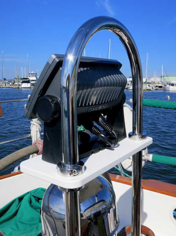

This is awesome! I have been scratching my head for the longest time wondering how I was going to make a bow pulpit and I may have just found my answer. Thank you! Are the supports fastened to the bow also or just butted and sealed?

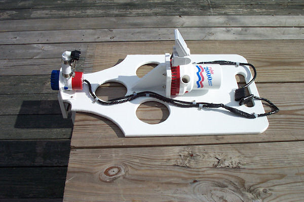

Jim, thank you for the concise answer. Most of the projects I would like to use Starboard for are like this pump hanger,
using glue for parts like the support under the upper pump platform. Even gluing shelves of starboard onto starboard for locker dividers and can goods stowage.
So mostly interior stuff with low stress applications.
Thanks.
If you watch the "How to" video on the Tap Plastic link on my Post #31, their technic, although complex, should meet your described service.
BTW nice design and craftsmanship on your photo job above.:clap: I wish I had that talent.

As for the attached pic, I'd love to say that it is my work, but the craftsman in this case i
s Cloud Diver. I agree, it is a magnificent bit of craftsmanship.http://forums.sailboatowners.com/index.php?members/clouddiver.127132/

I can't take credit for those pics I posted to start the thread, those were various examples of projects I google searched to start the thread. If you reverse image search that pump hanger I'm sure you would find out to whom credit is due.
