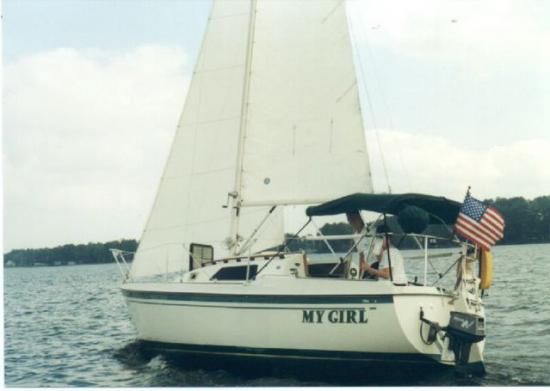

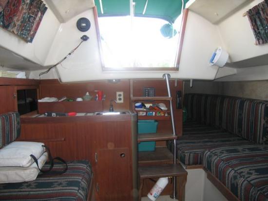

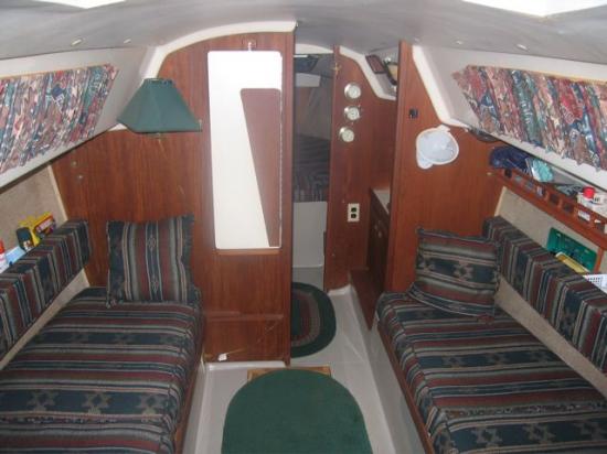

When we were looking to by our boat in '05, I downloaded any pictures I could find of 26's. These should look familiar.
Rick

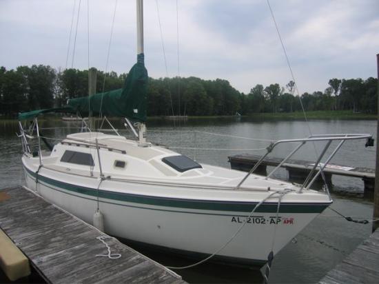

Rick, Glad to see u R still monitoring the situation!.... Great pictures.....Yep, that is my baby, and my slip.....Her restoration (or distruction) continues....
Lynn and I installed hardware today. We installed the pulpit, and stanchions. The trouble we ran into was probably typical of newbies. First mistake is that i put the 4200 on all the stanchions plus the pulpit thinking that I was saving time. But the install was much harder and took much longer than i anticipated and by the time we were halfway through most of the caulk had set up. We pressed on. we will see what leaks and what does not. One other thing: on the oday 26, when installing the aft stanchions, you MUST turn the bolt. You cannot turn the nut from the inside because you cannot get a wrench on it with enough room to turn the nut. You have to tighten from the deck by turning the bolt, thus breaking the seal of the caulk collar I put on the bolt. Will It leak? Probably. If so. I wll cut out the part of the inner overhead liner that blocks me from being able to get to the nut, and also use a S.S. backing plate instead of the one inch washers I used as backing.
