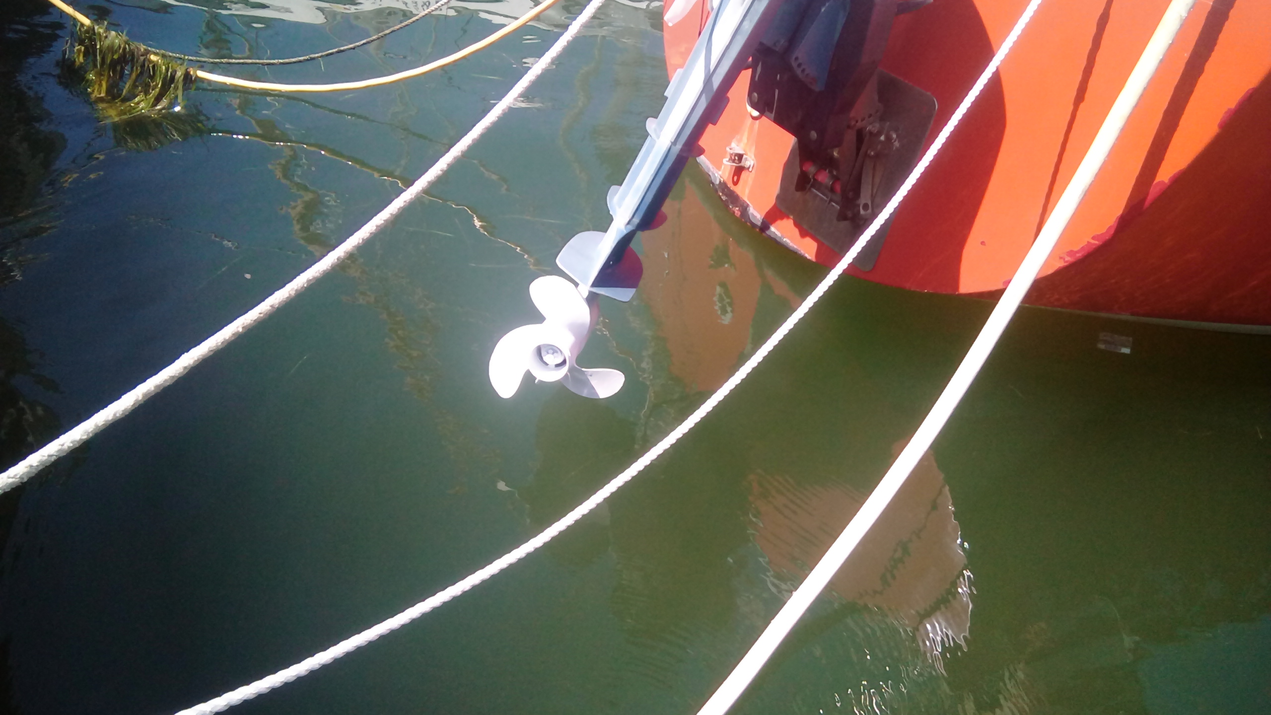

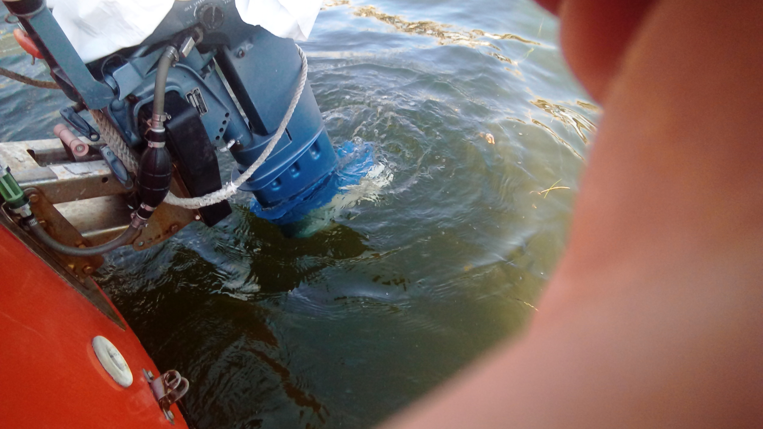

Update, the motor is trimmed out I know, I know how to change that. My problem is the height distance between all the way down on the kicker plate and all the way up. I can measure mine in some way and take that measurement and change kicker plate to a longer distance hopefully like an extra foot lower to start. I get pictures all over the internet but where are the distances measurements. ⚓
I just added a new picture, that's as low as it can go...
The outboard engine doesn't go down far enough in the water, can't rebolt it lower, pull start. Storm tried to drag me and my set anchor to Mexico, all sand here Bradenton Beach west.. I was told this of people that look at it, I ignored them for no reason. Boat was ordered without in board 40 years ago, 40 year old Evenrude long shaft, forget extended long shaft, never find one and I can't afford it anyway. A sail thing I guess. Need to know how to measure for a better engine kick plate that drops down correctly and comes up high enough to clean the spark plugs.. Will make pictures. It's not right, spins in the wind 90 percent of the time on bumpy water. Other than that I need a head tank and hoses, just saying grin.

So your saying the engine is not quite strait up and down, I had a wedge on the engine side of the engine clamps but this gives me maybe a quarter inch one side, I need at least 5 - 7 inches lower. It doesn't clear the bottom curve of the boat the way it is.

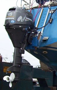

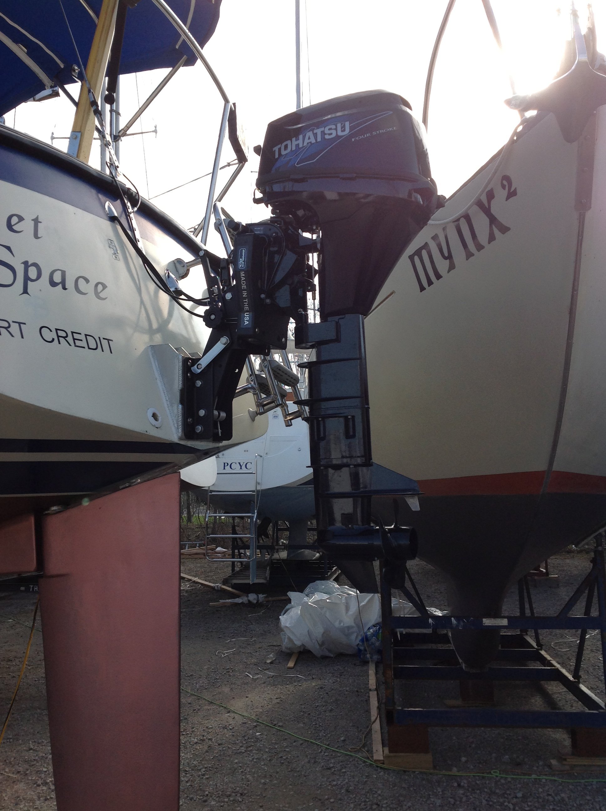

Here is a picture of an aluminum wedge I made years ago for my O'day 28 with a Garelick transom kicker lift. It had plenty of travel and never a problem in choppy conditions, you need to read the specs when comparing lifts as the travel from up & down are two totally different things.
The picture attached shows the motor fully in the up position, not tilted, when in the water I always had it tilted when docked to keep the prop and lower end clear to keep clean and not to sacrifice the metals or zinc.
That lift travelled approximately 16" down, never needed it but nice to have in a chop..
Wow, that's amazing, a real life Transformer. I'm just trying to get my prop in the water. That picture is something that will stick with me the rest of my life. I just need the correct kick plate for my 76 evenrude 2 cycle, 76 O'Day 600 lb fixed keel, It needs to dive a foot deeper.... you all are crazy you know.... God bless us all. Oliver
