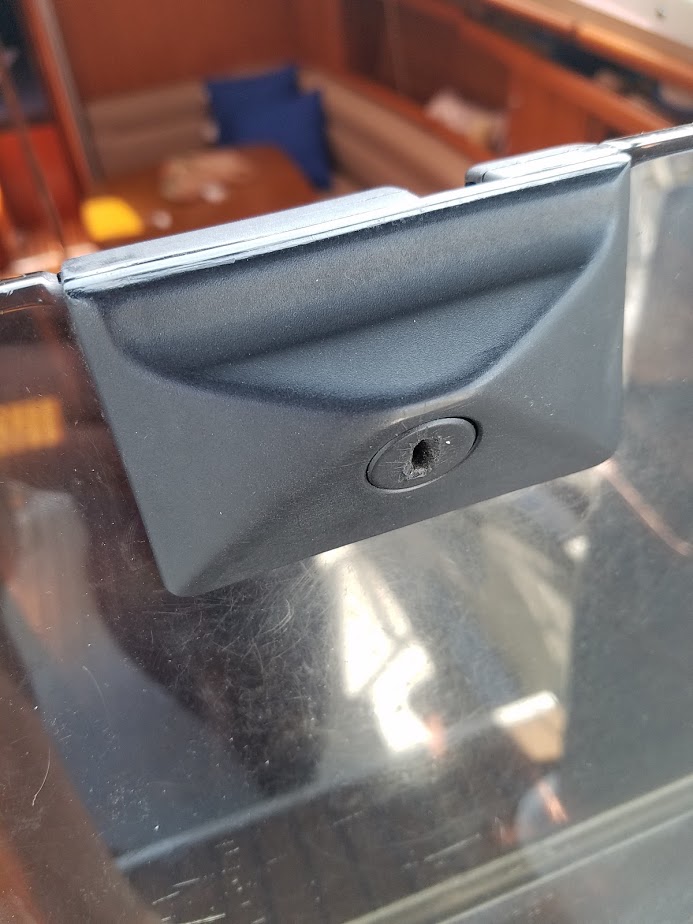

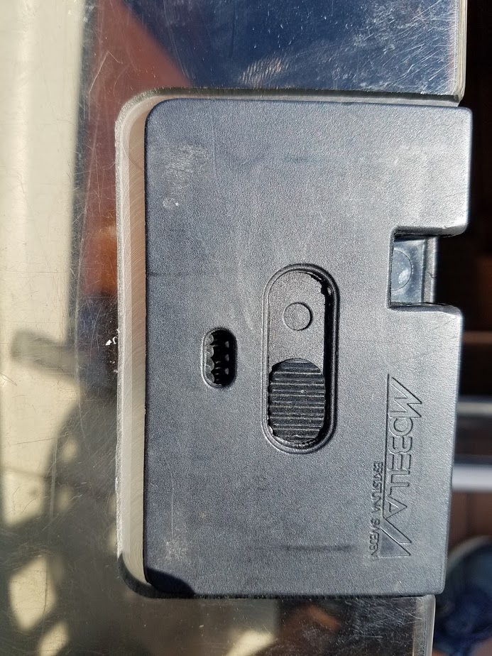

I have recently snapped the key inside a Mobella lock on my boat. Fortunately the lock is in the open position. I tried to retrieve the broken end with fish hook barb, coping saw blade...etc with no avail. I think it would be cheaper to replace the Mobella lock (~$45), then hire a locksmith to fix it. Has anyone replaced the Mobella lock on their boat? I can not find out how it is attached to the companionway washboard. The Mobella lock is part # MG-01-110-50. Any help would be appreciated. Thanks!

It looks like it does just snap in. I tried somewhat to remove it yesterday and I didn't want to force it and break the Plexiglas. I will try again this weekend again.

As Bosman said but if you use a Phillips screw driver between the two racks when you rotate the screw driver it pulls both locking tabs in at the same time. If I remember correctly it comes out the top.
That should certainly work as well - very good idea!

Ron, The key seems pretty stuck in there, I am not sure if the pins are holding it in place or not. I tried a bunch of things that I found on youtube. Seems that the lock replacement would be the easiest at this time. I am sure a locksmith would be more than $45.

Just saw your pix on my computer rather than my phone, and it's clearly pretty far in there. I wonder if contacting the company might shed any light if that's an option?
