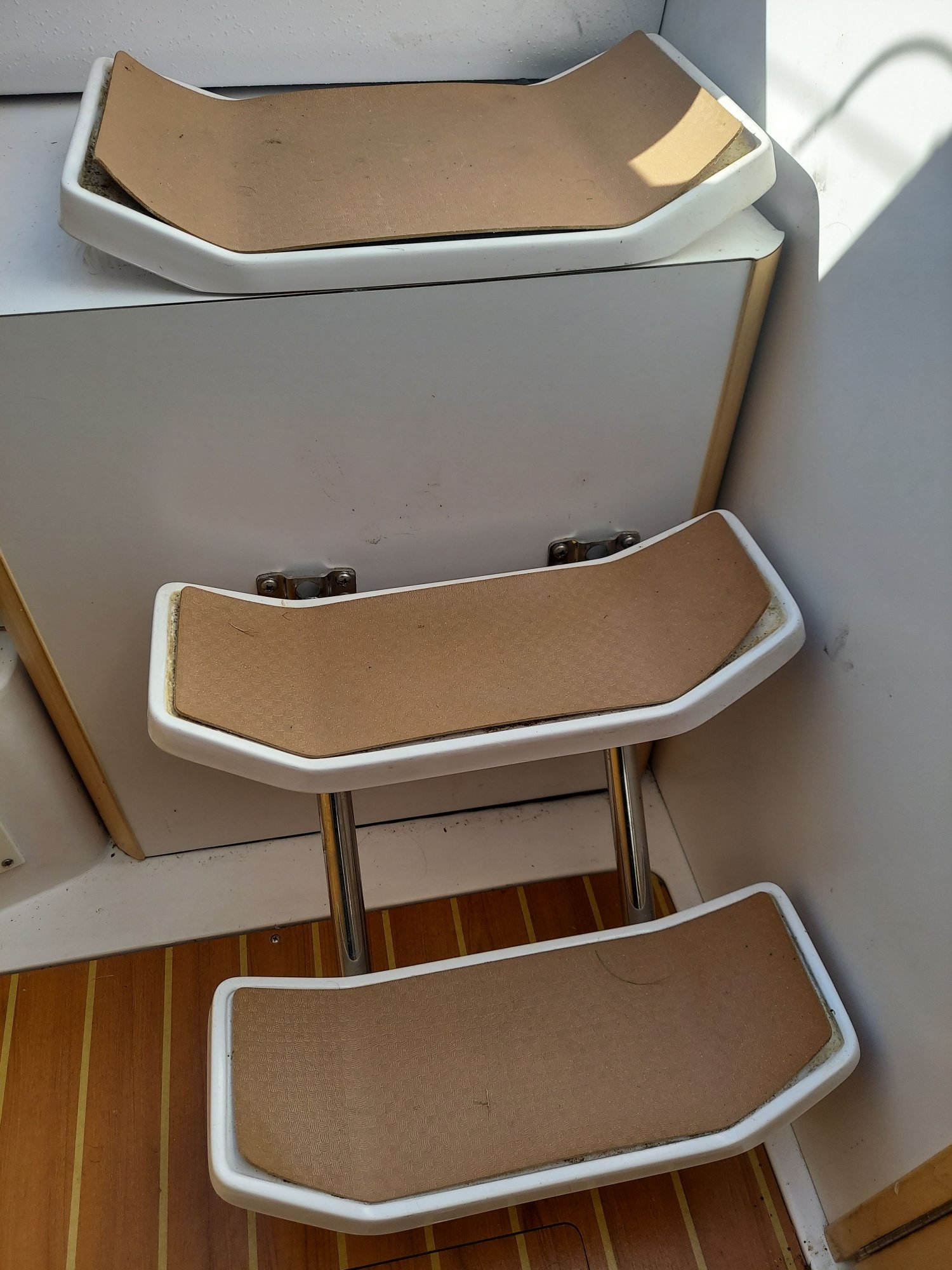

The boat is in Michigan. I am in Washington State, so SeaTrial is not in the mix. I had a chance to sea trial a boat owned by the local dealer and I really liked it. The survey is today. Will report back. its a 2015 boat, but was basically in the showroom for three years. The biggest issue I saw in the photos was that the cover on the steps in the companionway have become delaminated. Interesting I saw the same thing on the dealer's fleet boat that I did my sea trial on.
