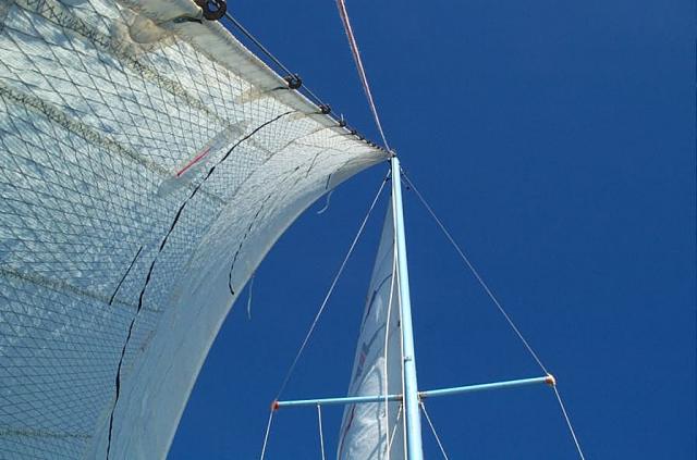

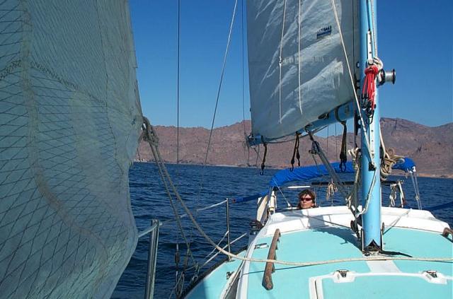

Here are a couple of shots of the sail in question before the roller was installed..I'm going over to the boat and get it NOW!
