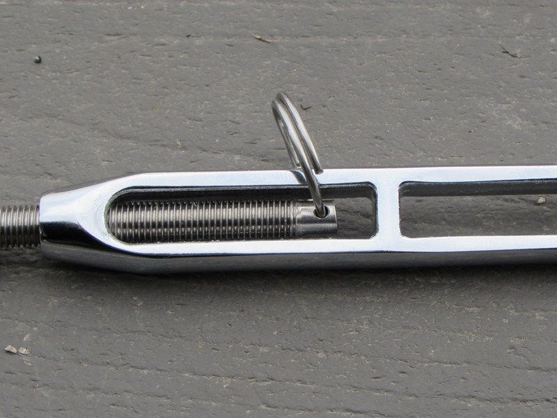

I like your stainless wire approach more because of where this particular turnbuckle is. I'd be concerned with the furling drum spinning around this that something (there's always something) will get inside the drum and foul on the hanging split ring. The wire would fit snugly against the turnbuckle body.

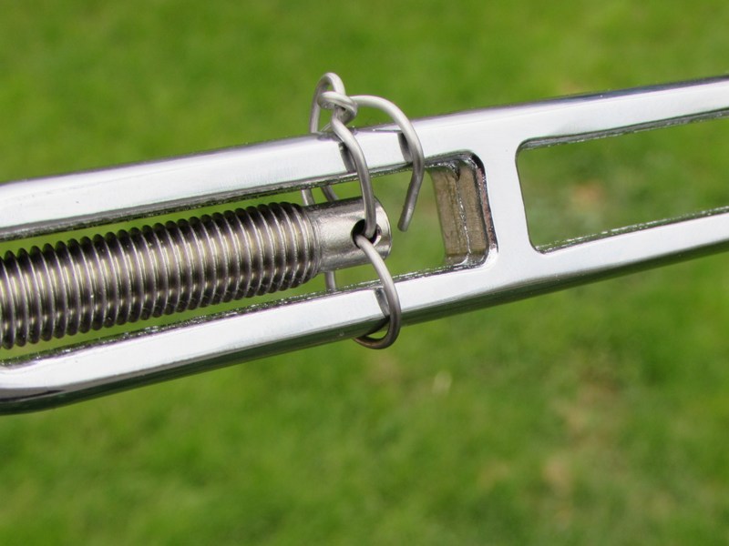

I bought some 19 gauge SS wire and tried a "figure 8" where the wire loops through the hole twice and this looks good/ rigid.
The bottom picture is a split ring and as was already mentioned, this probably would have issues inside the furling drum.

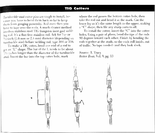

You might like this - it is a bit more skookum
i am glad you posted this i have been looking for it in roger longs post and was going to post it ...that's how he does it and it is a good setup thanks Charles

Cool! I think the text says about the rod:
Stainless Steel TIG welding rod (flux free) heliarc welding rod 304 or 316
1.6mm or 2.4 mm
Note that the 19 guage SS wire in the picture I posted a couple back is 1.016 mm diameter.
