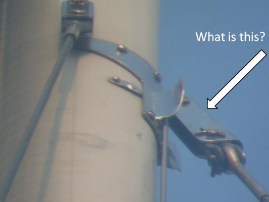

Keep Original or go with double joint toggle in its place?
Apr 22, 2009
342
Pearson P-31 Quantico
This is from my 1978 Pearson 31', hull #14, GOOD TRADE. Her forestay was halyard wrapped and I am now replacing it, as well as fixing the furler.
Referencing the large stainless steel mass to the right of the mast as you view it in the picture, what is the purpose of the mass and can I or should I replace it with a double jointed toggle?
Thank you!

Re: Keep Original or go with double joint toggle in its plac
my guess is its a toggle extention...maybe the stay was to short...but then i am just guessing......
regards
woody
10,254
I agree Woody.. It may have been made to accomodate a short stay.. A double jointed toggle would be OK to replace it or you could re use that part after making sure there are no cracks in it .. Look very closely at the saddle shaped part that the stay pins into.. and the pare that piins onto the mast for wear and oblong holes and cracks.. If it isn't broken, don't fix it..
Alot of boats would have two separate 'tangs' instead of the piece you have. Yours, being one piece, is stronger. Plus, it spaces the toggles away from the othe mast fitting. I agree, it is probably OEM, so don't mess with what works. IF you take it apart in the future, I'd swap it end-for-end.
Thank you, Ron, Kloudie, and Woodster.
I do appreciate the advice, "If it isn't broken, don't fix it." From 35 feet below it is hard to see all the parts involved but I think that this may actually drop over the upper pulley. Maybe on a bright day we can get a good shot with the camera.
Thanks again.
