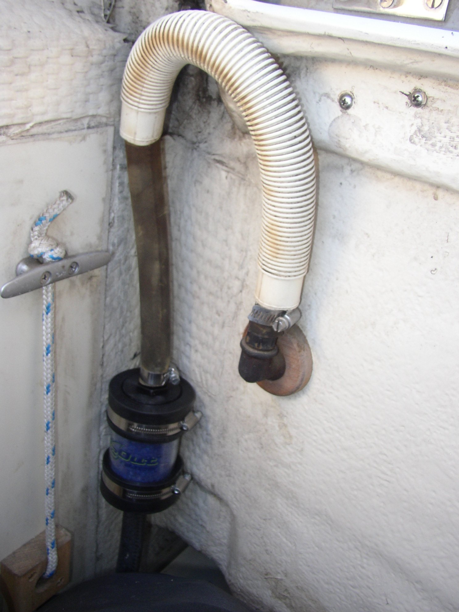

I never fill up my tank all the way. Besides adding stabilizer and Biocide, I added an H2Out fuel vent desiccant dryer. I can see that it works. Over time the (reusable) crystals turn pink.
