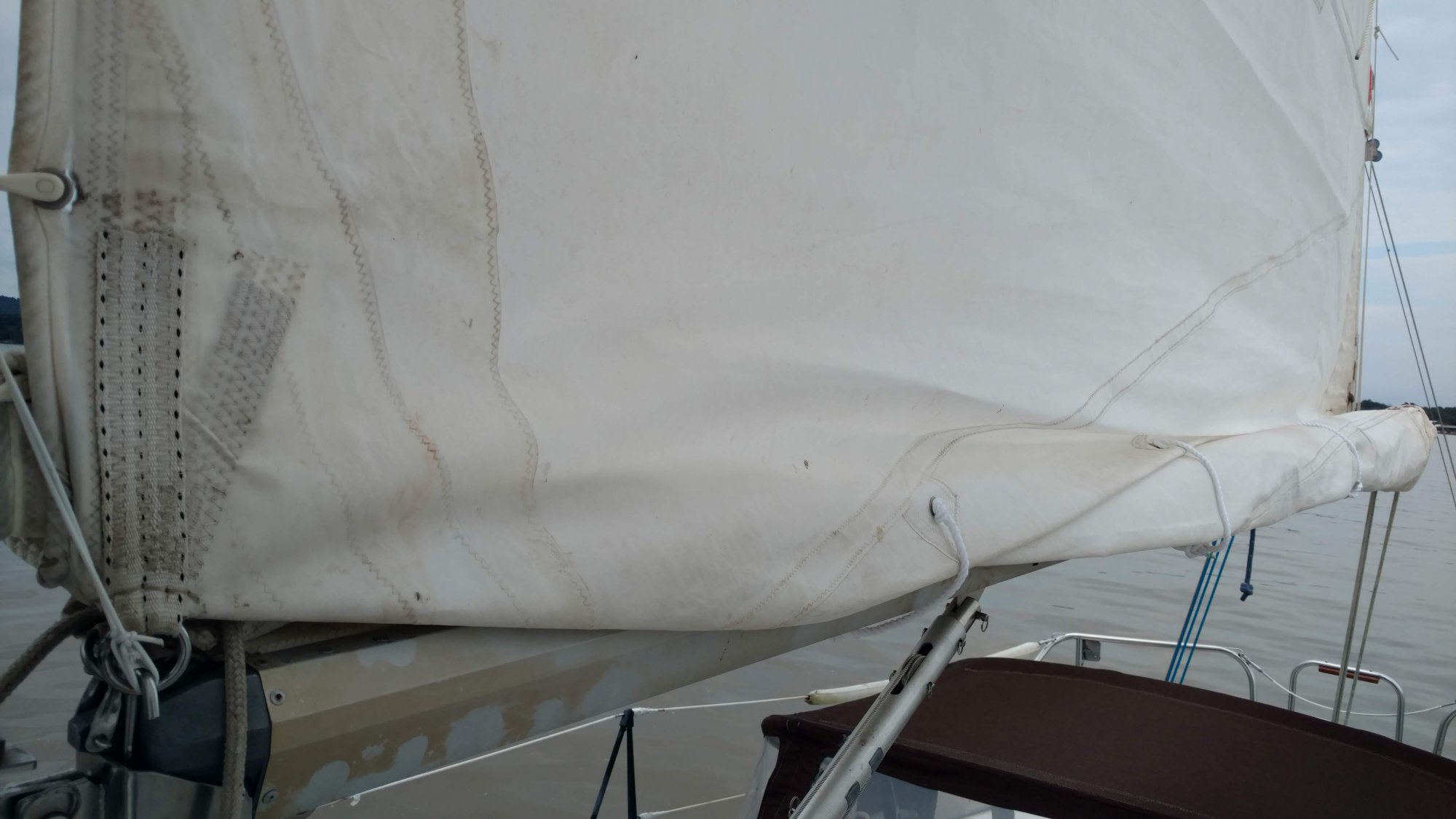

When reefed, my boom is low enough to scrape the Bimini when gybing. I have adjusted the topping lift to keep the boom off the Bimini when sheeted, but this then interferes with my ability to properly sheet the main when not reefed. It also puts opposing tension on the boom at the end and middle sections, which doesn’t seem ideal.
I do not want to rely on easing the topping lift and then re-tightening, as this is bound to be overlooked at some point and potentially cause permanent damage to the Bimini.
Does anybody have any suggestions here? I’d like to be able to trim my main without worrying about the boom hitting the Bimini.

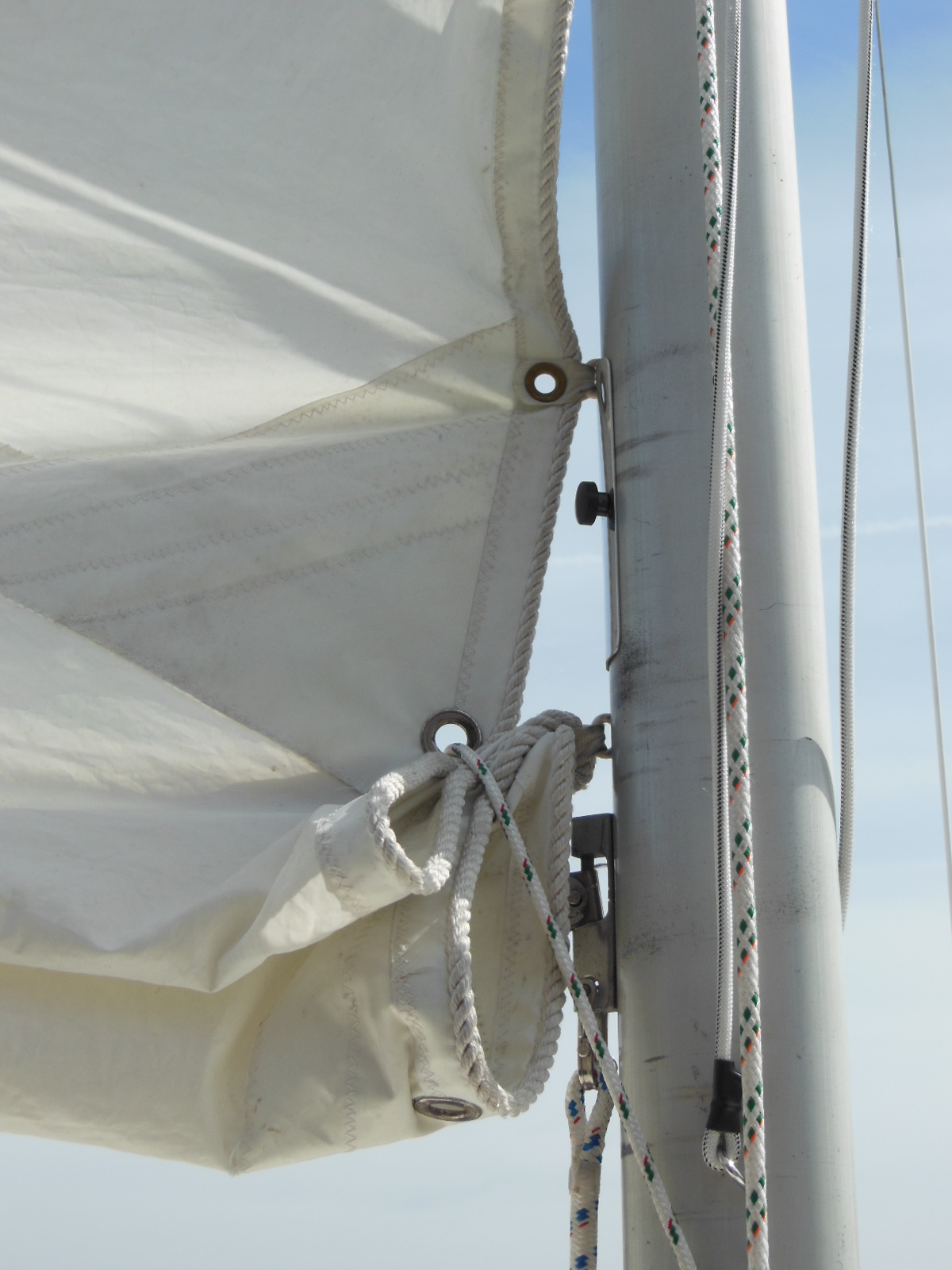

Obvious, really. Don't pull the sail down that far when reefing. The tack does not need to reach the gooseneck. The clew does not need to be tight on the boom. They can float. No modifications needed. (Note: if the tack is no longer secure with a rams horn or similar, you will need to make some provision to pull the reefing tack forward to the mast. A simple lashing around the mast will do, or perhaps locating the single line reefing run so that it pulls the tack forward, like it should. If you do not secure the reefing tack forward, you can pull the slugs out of the sail.)
The reefing clew is wherever YOU put it. Don't put it so low.
This will solve the problem for the 2nd and 3rd reefs as well.
A rigid vang won't help, because he still won't be able to trim the sail hard upwind. The whole sail needs to go up. Limiting trim is not a solution; it's a patch.

... That might depend on the boat. Our previous boat had a reefing cringle that got pulled down to horns on the gooseneck, and no Cunningham. If you didn’t pull the cringle all the way down there’d be no way to tension the luff.
Not really true. My current boat, for example, does not have horns. The prior boat was single line--you could vary the height.
If you do have horns, thread a short sling(~ 4") and loop that over the horns. Many sails come with rings through the grommet, connected with webbing, to make hooking the horns easier. Lengthen the webbing a few inches.
That said, there must be enough forward pull to avoid damaging the sail. A lashing or forward routing of the downhaul or reefing lines can supply the pull.

Adjust the reefing points on the sail.
I agree with Kappy. Thinwater's tack strap would raise the end of the boom, but it could overload the lowest luff slide when the reef tightens the foot.
I have the opposite problem where the boom end is higher than I'd like when reefed. I plan to ask my sailmaker to move the forward cringle up slightly.
