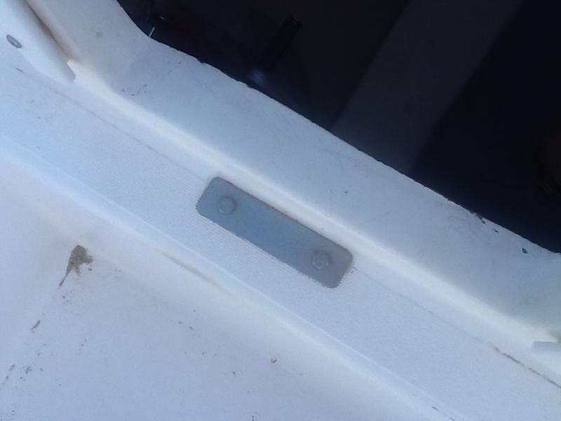

Thanks for the maintenance discussion and information. I notice the winch is a little lose at one of the mounting bolts and the entire winch seems to flex the fiberglass at the mounting point when cranking up the keel weight. I consider taking the winch down cleaning and servicing it per the manual.
** Should I install a back plate of plywood or metal between the winch and the fiberglass when remounting?
thanks James
Yes, a backing plate should be there, but outside, as in the photo.
Additionally, the fibreglass there is fairly thick, and also supported by the bulkhead.
I'd inspect both of those possible issues, too.
