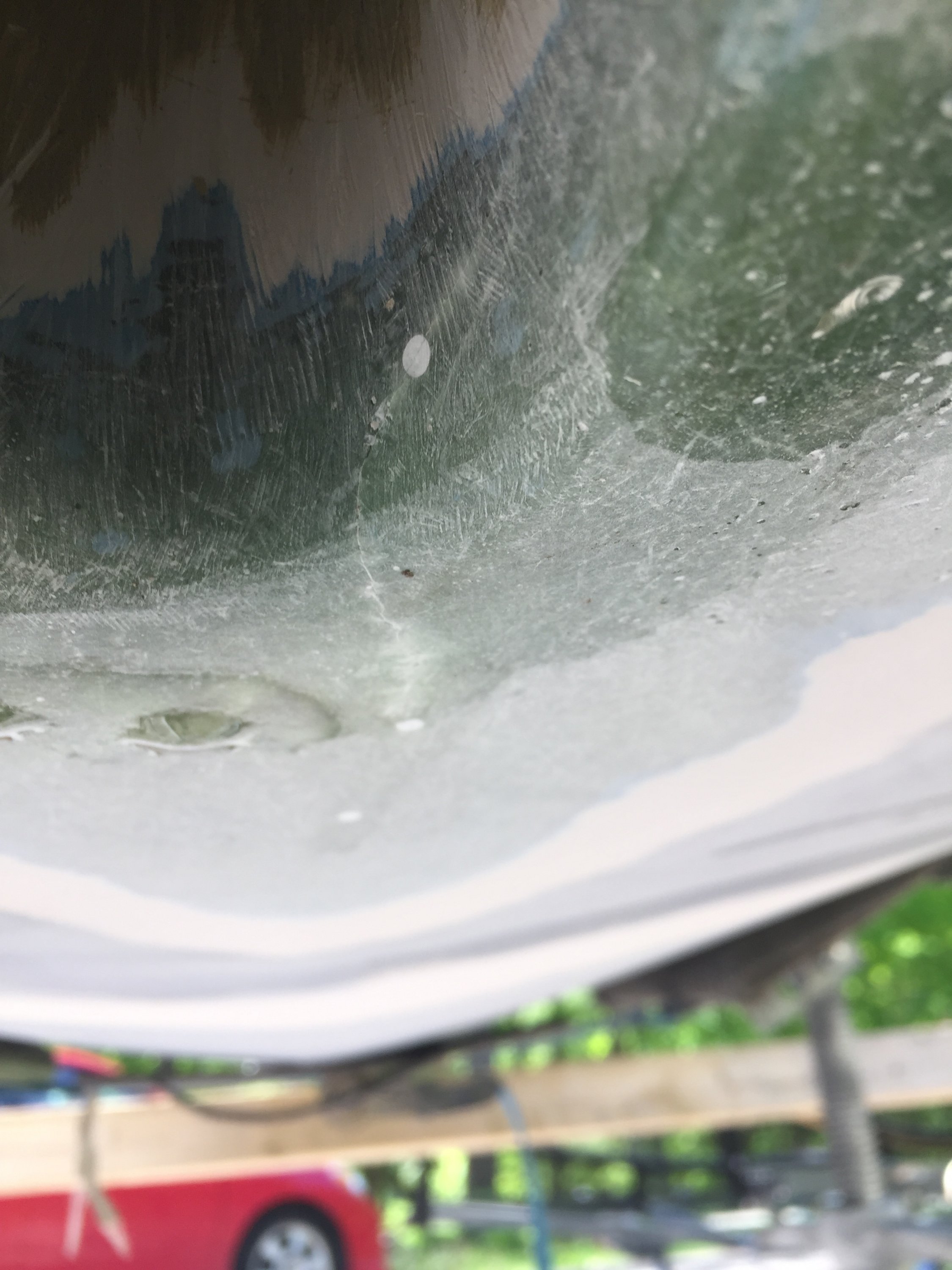

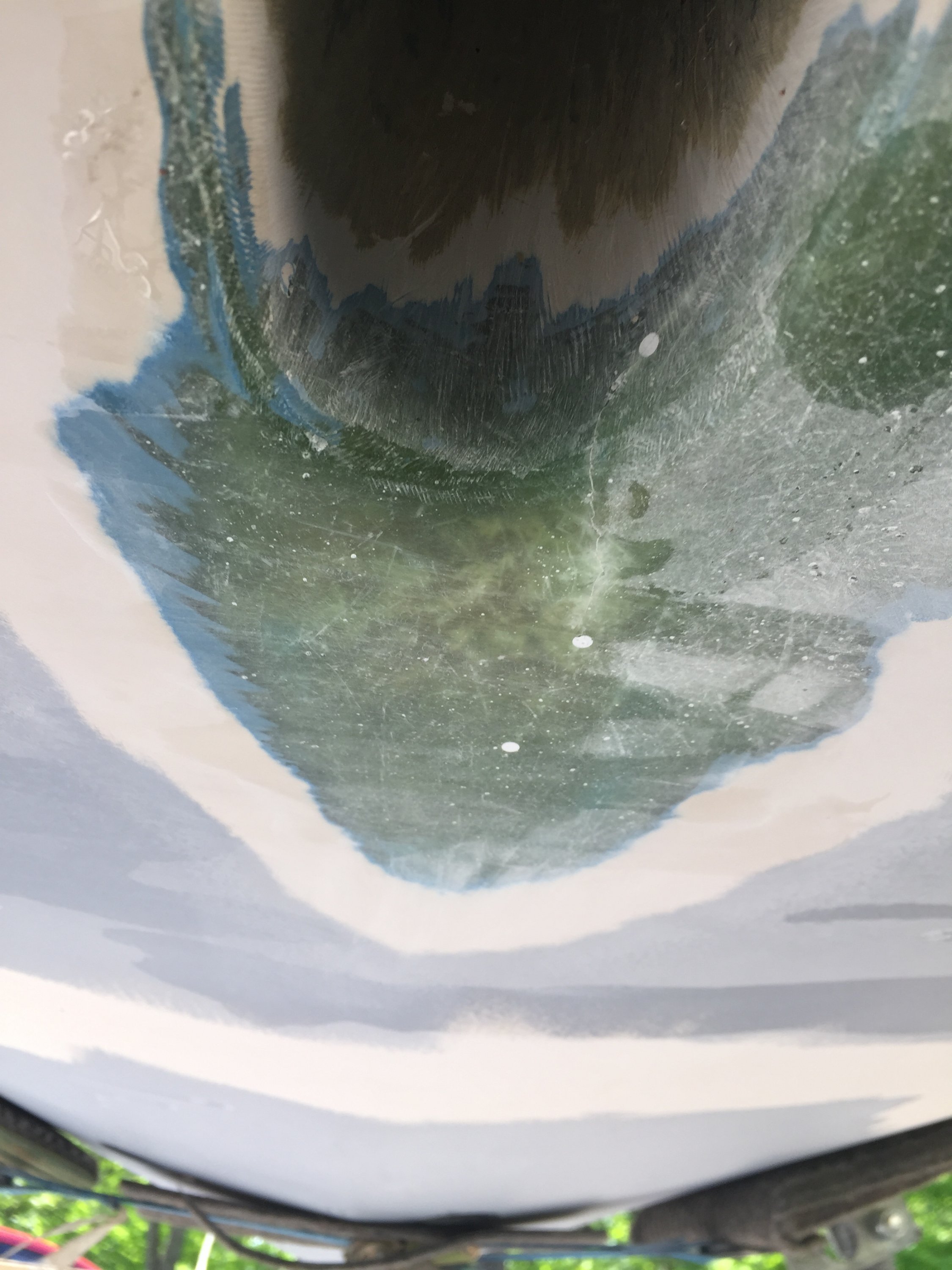

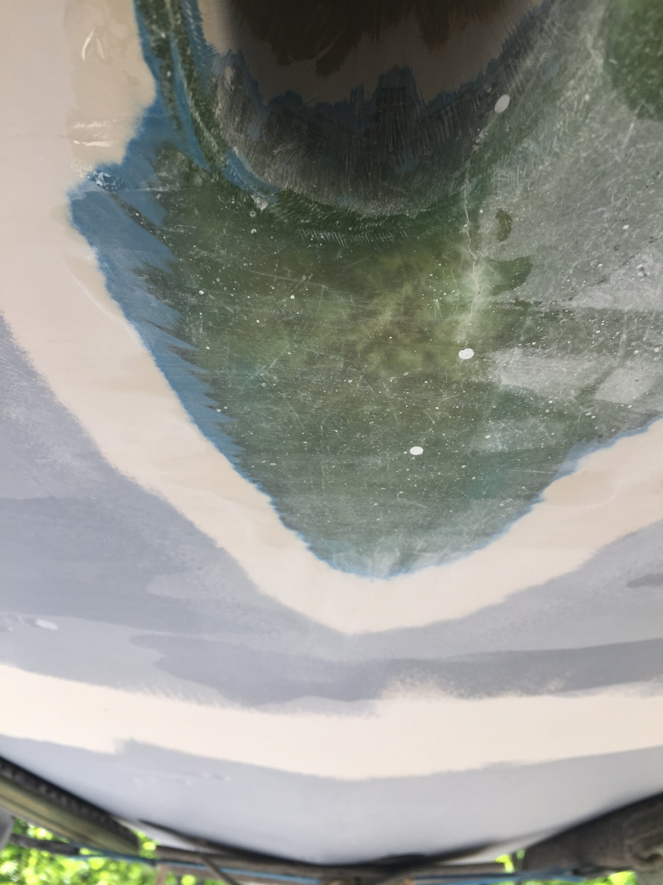

Figured this was important enough to get its own thread for others easier reference.
As I was restoring my 1987 C22 I found this crack that ended up being larger than it first appeared.
I got the boat with a broken keel cable but this crack appears to be from before this incident as the drill holes imply it was poorly fixed the first time. I don't think it would be a good idea to ignore this at this point.
You can also see "bruising" where there is delamination internally from impact.
Here are some pictures:
I have done a great deal of work on the boat to this point but am running out of time with my work space and am not sure I am capable of this big a job. There is a wood bulkhead for the sink area in front of the keel pocket so access would need to be cut for a proper repair being as it's on a corner and a fairly high stress area.

Grind out the entire crack, and fill the void with West Systems epoxy, thickened with West 404 filler.
Easy peasy. I'd invest in a respirator and a disposable suit for the grinding is all. Or maybe @ilance can loan you his. :biggrin:

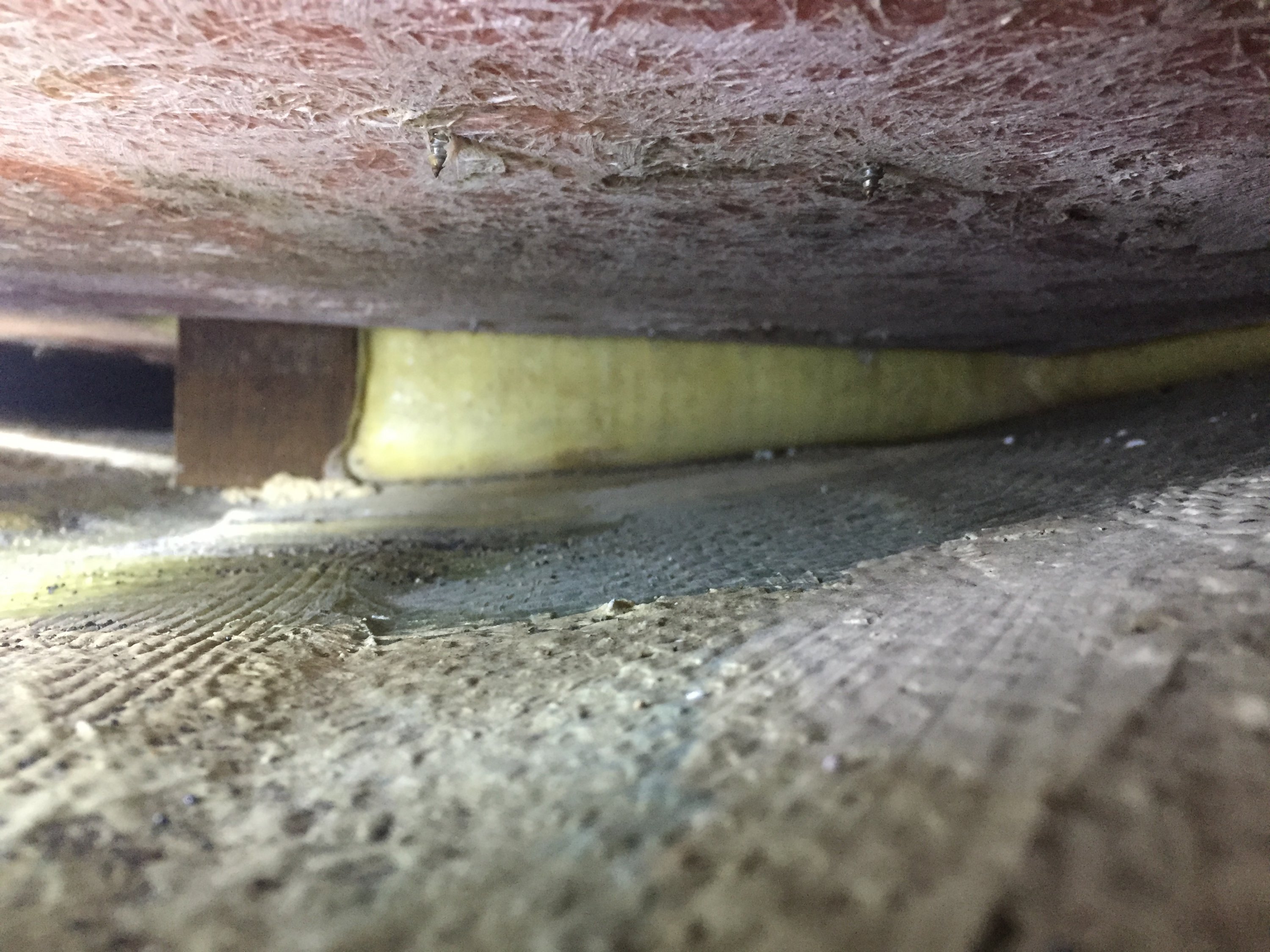

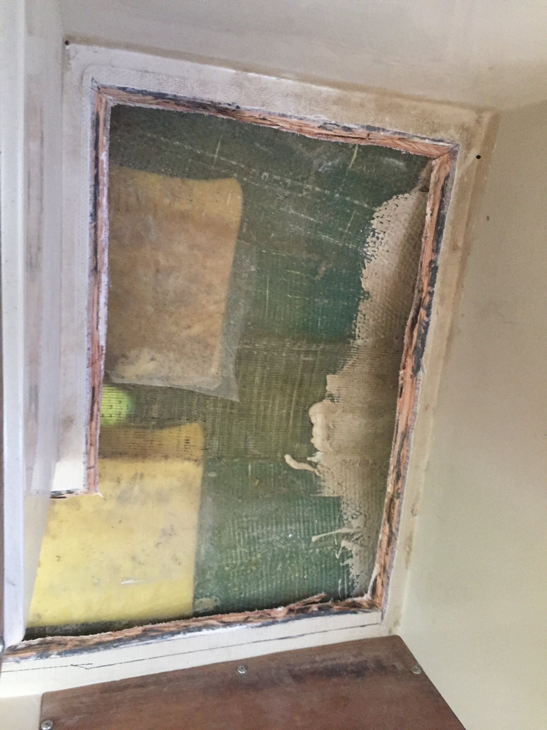

Thanks for the advice, I have ended up cutting out the floor to access the inside. I installed the old bulkheads and locker fronts first for support. When I did I found the mast support extremely soft and wet. I'm not sure how important this is because it's not very big and not very bonded to the hull. Also the keel pocket support in the area under the sink is worse than I thought and needs to be replaced.

"Mast support".....as in the compression post, the teak one, visible in the center of the cabin, or the wood block between the liner and the hull?
Neither should really be that big a deal. The compression post is on eBay for around $20, needing varnish. The blocking can just be epoxy saturated wood. Bust it out, epoxy it's replacement, and tab it back in.
