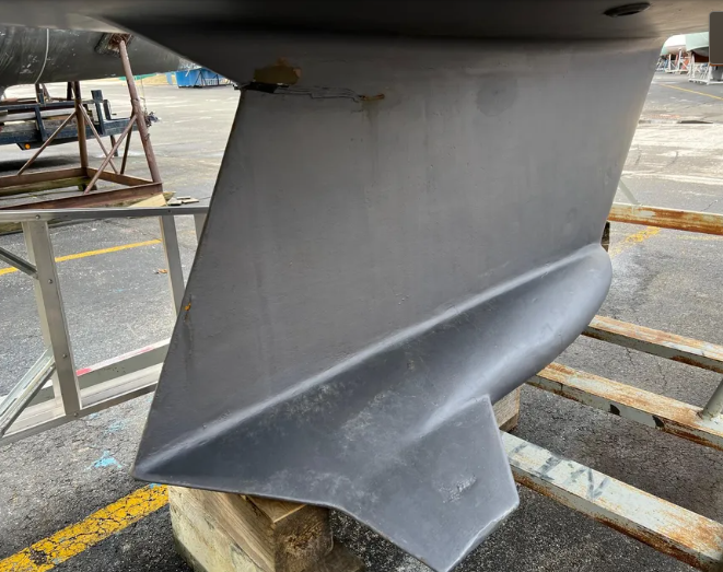

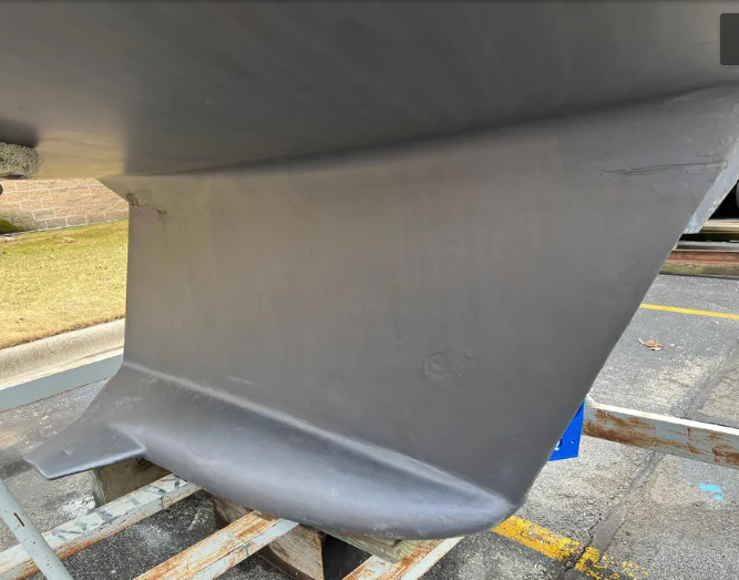

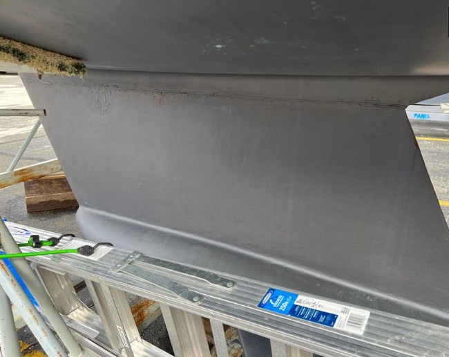

I'm considering the purchase of a Hunter 30 with a Shoal Keel (currently own Catalina 30T with fin keel). Pictures of the boat show a crack in the fairing and the keel/hull connection. I'm familiar with the "catalina smile" on my current boat. Is this a common problem with a Hunter I can perform a simple repair or should I be concerned about a bigger issue.

Almost all boats with a bolted-on keel will have some cracking at the joint.
Some photos would be helpful, but if the faring has some cracks, but overall pretty tight (no gaping cracks), I would consider it fairly normal, especially on an older boat (you didn’t mention the year).
My own O’Day 322 was some cracking in the faring. A few years ago, I ground out a bit and found the joint tight. I refaired the area and went sailing.

The first photo looks a bit concerning, but it is dark so I can’t really see what is in that dark spot. The other photos don’t look bad.
You could ask the seller to have that area ground out and if nothing more concerning in there, refair and move forward.
