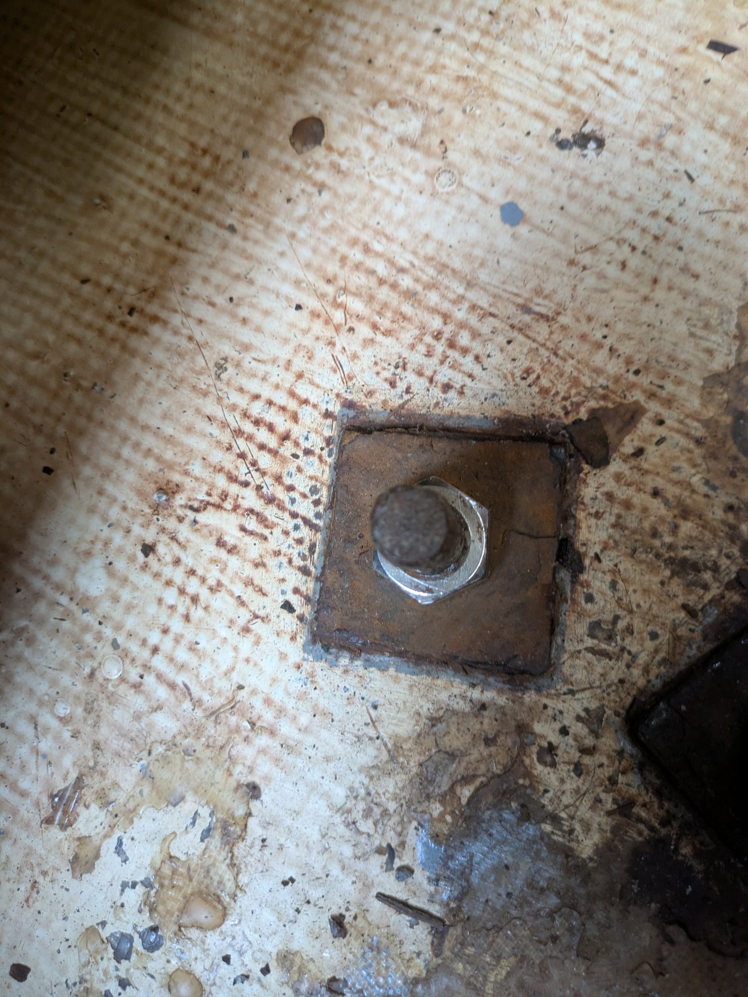

Boat's on the hard now, just following up. For this season I've picked the 2 worst studs to remove and replace. Not coincidentally, I guess, they are in the deepest part of the bilge.
The PO slathered anti-rust paint on them. (I could write a book, right?) I've brushed most of it off with heat and a wire brush. I'll do the same with the other studs later.

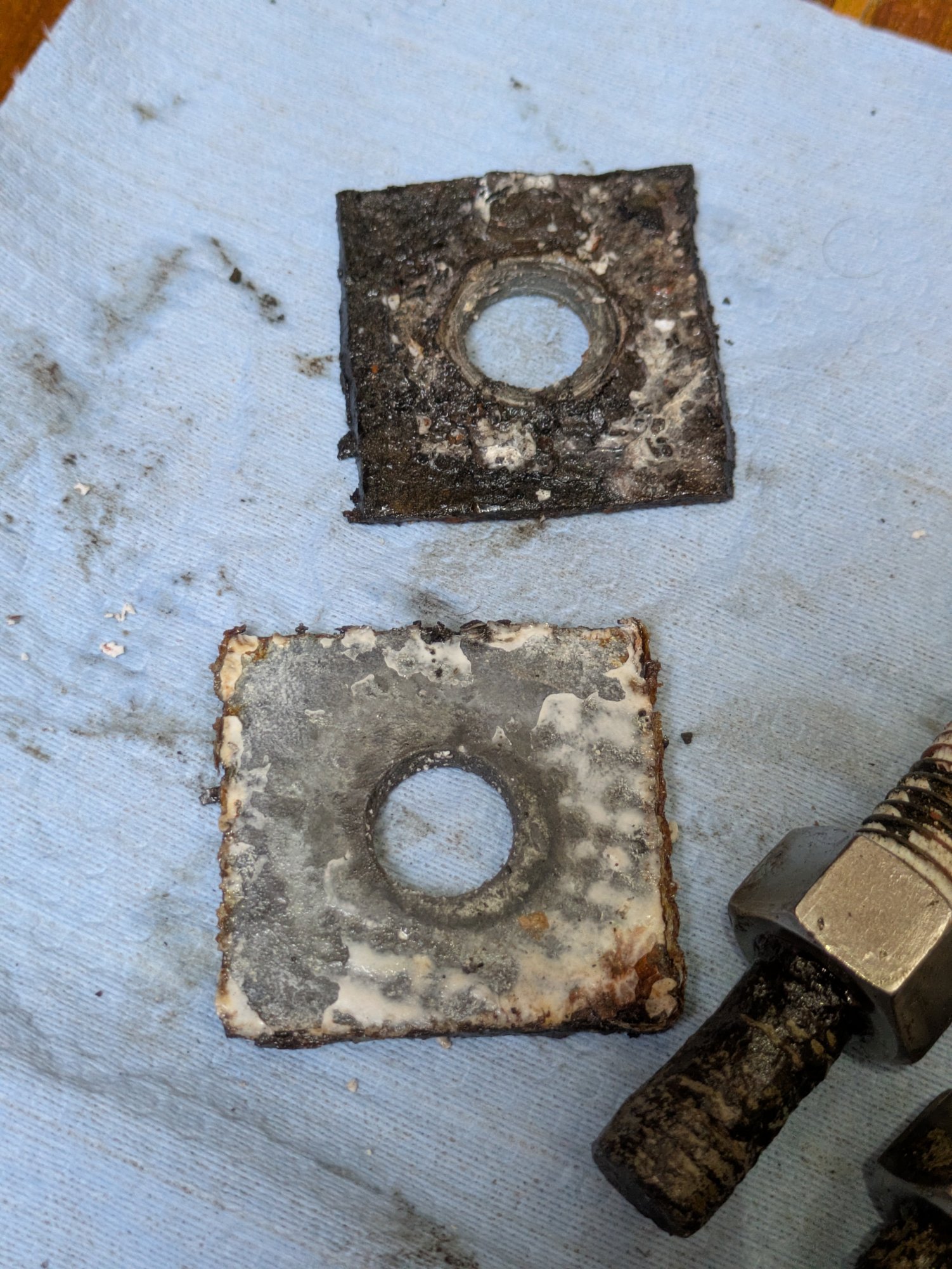

See the photos. The washers and exposed studs are corroded. What's left of the exposed studs' threads are pretty much useless, there's not enough to clean up with a die.
But the nuts are still shiny and, from what I can see, they still grab onto intact thread on the studs.
The other 7 studs are not this far gone, so I'm crossing that bridge next season. This is already nerve-wracking enough.
Next step for these 2 studs: 3-4 hourly doses of heat then penetrating oil. Then drown them overnight in a cozy moat of penetrating oil overnight surrounded by butyl.
Tomorrow will be my first, and ideally successful, attempt to remove the 2 studs.
Plan A: After a hearty breakfast, bite down onto each stud with the biggest vice grip I can fit in this space.
Plan B: Suggestions?
Questions, opinions, and encouragement are welcome.

I would take a look at the threads under those nuts. The threaded part projecting above the nut does nothing for strength.
If the threads under that nut are in good shape - I'd replace that square washer with a better material, and reassemble.
If the threads under that nut are also compromised - then I'd replace the whole stud.

A: If it still has any of the mystery oil on it, it's gonna be too slippery to grap even if you're as strong as Paul Bunyan.
B: Get rid of the round. Grind two sides to get two opposite sides flat(ter). Shouldn't need to take much off to get something better to grip.
Good luck.

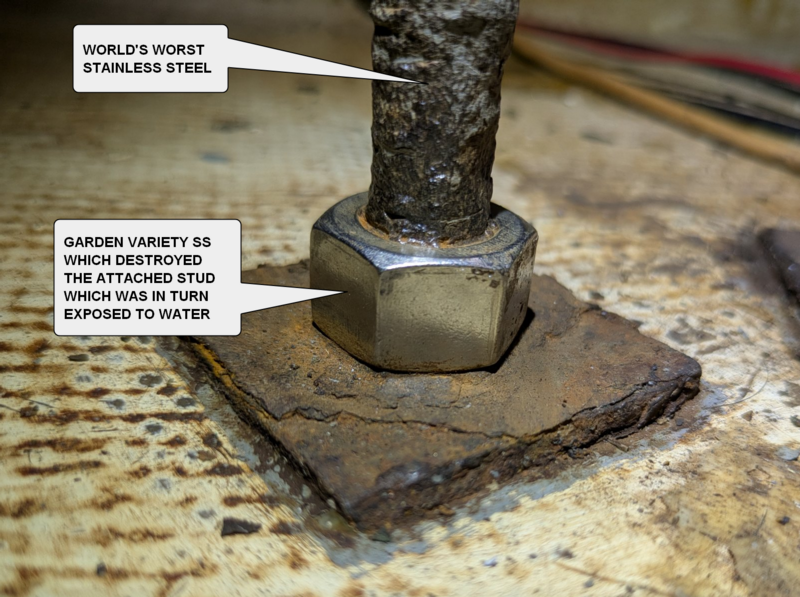

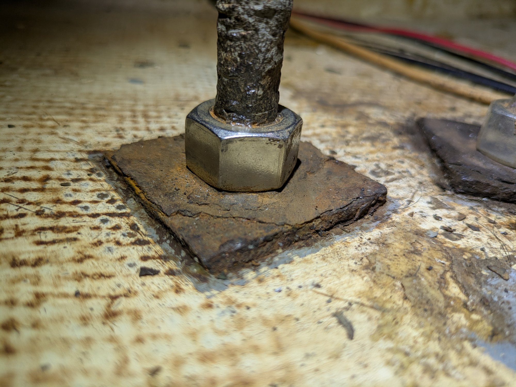

Can you remove the nice shiny SS nut that the PO f _ _ _ ed up the stud. That was an absolute NO, NO which caused all of that corrosion. Better to use a galvanized nut and replace it every few years as it corrodes.
If possible, use a 8" pipe wrench (and a possible snipe if space permits) as it tightens the grip on the bolt as you torque it. Use the pipe wrench on the solid threads of the studs if you get the SS nuts off.
I'd say once you are finished with the studs and they are installed with plenty of release compound, that sounds like a maintenance job every couple of years when things start to look rusty. Remember, no SS anywhere on this job. If you are replacing studs, make the new ones good and long to get a hold on the stud at the top of the bilge.

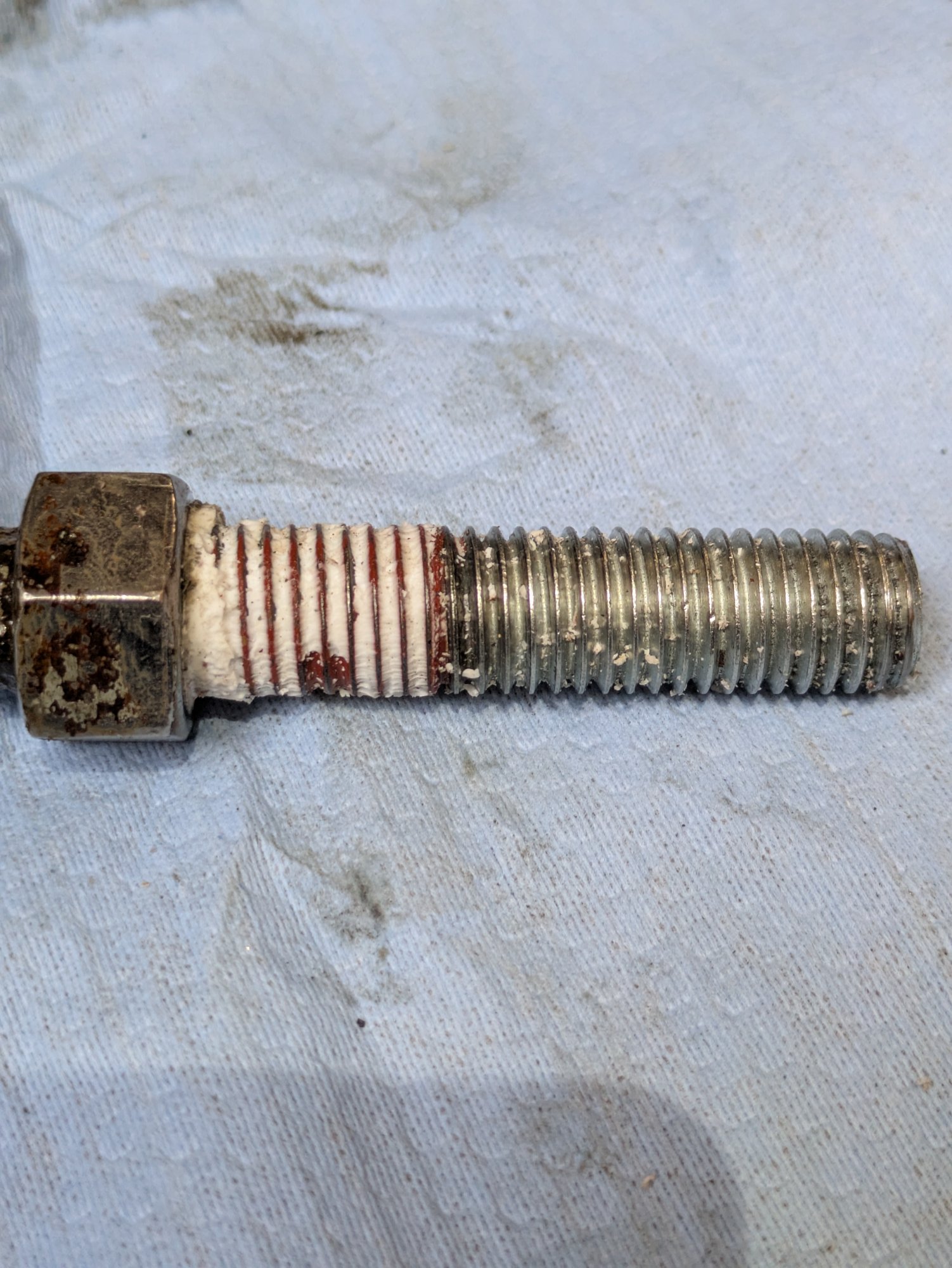

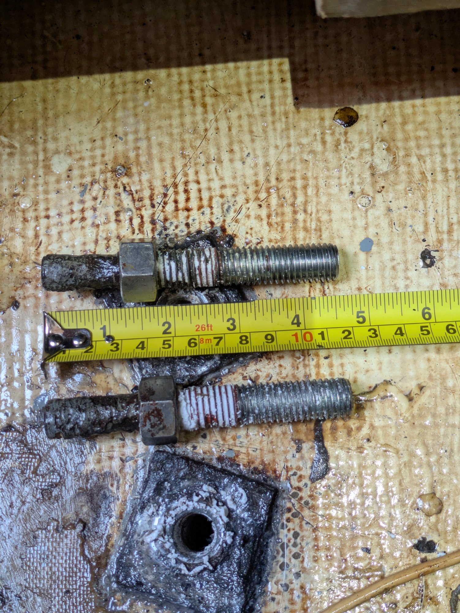

Following @Ralph Johnstone and others' advice, I started with the nut using a socket wrench and a 15-in flex handle. With less leverage than I expected to need from my feet against a bulkhead, the studs came out with no fuss. Overnight penetrating oil and heat ftw.
Lucky me, the nuts had enough thread to keep the keel on, and enough corrosion to overcome the friction of removing the stud.
The photos show that the corrosion was entirely where it didn't affect the integrity of the keel-hull fastening. The threads on the 2 posts that went through the hull and into the keel are pristine. There's some kind of white sealant that covers what looks like red thread loc-like material. Even the washers are fine underneath. The hull's fibreglass around the stud holes is hard and makes a satisfying thunk when tapped with a mallet.
Lucky, lucky, lucky me.
Lucky me, I guess. Yeah, 40 years is way too long but it's evidently a good setup that worked perfectly. I'm expecting the rest of the studs are in similar shape, if not better.
But I'm definitely replacing the whole kit: nuts, washers, studs, and sealant. And I'll be inspecting and re-tightening every couple of years from now on. I'll post comments and photos when that happens.
You can't argue with what's worked for some 40 odd years. Looks like the white goop formed an excellent seal against the intrusion of water into the keel threads.
I'd still suggest that you avoid any SS material like the plague when re-assembliing the studs into the keel.

Are you sure about the stud being SS ? ? ? ? ? ?
If it is, it's the world's worst SS with that much corrosion. My guess would be galvanized steel.
At the risk of repeating myself, no SS within a 10 ft. pole of the studs this time around. Galvanized steel only, keep it dry, and inspect every few years for corrosion.
