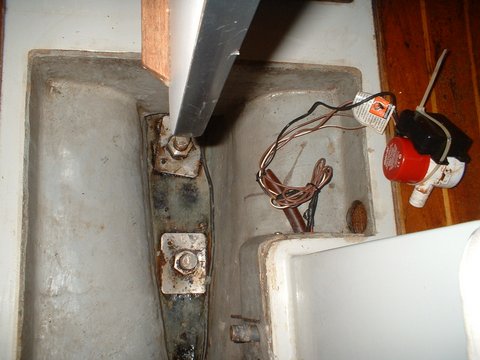

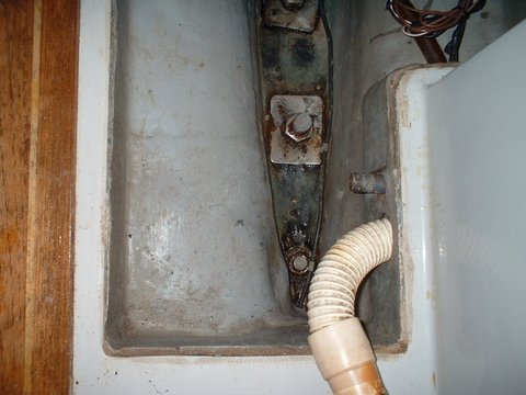

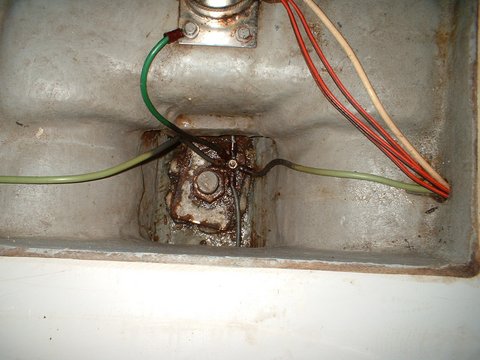

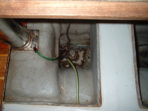

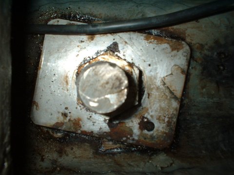

Hi all,
Posting this on behalf of and at the request of Gary, who is now well underway with the reinforcements to the keel sump of his 322 that we’ve been discussing. Attached to this message are the “before” photos of the keel sump on his 322.
I’m sure that owners of 302’s and 322’s will be relieved to hear his report that his sump is at least ¾ of solid glass on bottom. From Gary:
“I think this was the first time ever that the keel sump was degreased
and scrubed. I'm very pleased that there are no cracks or any signs of
pervious damage. ALSO, the fact the bottom is at least 3/4 inch thick
gives me much more confidence.
I will make templates today and order the G-10.

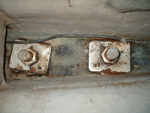

The current plates are 3 inches by 4 inches except the aft 3/4 inch
bolt and that is just 2 washers under the bolt. Also looks like there
is only room to add one more cross member but having taken a good
look, I don't know if it would add much strength because the built
looks quite robust.”
Photos attached...

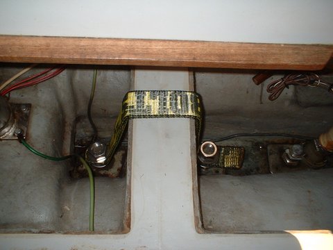

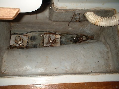

Here is a photo of the keel strap Gary added as a further reinforcement.
my Last Keel post:
As the weeks pass (I've owned her for 8 weeks now), I continue to become more impressed with the build quality of the 322.
The finish inside "hidden" compartments is much better than expected. So what was hidden and no longer is?
Under the v-berth there are two areas that you can't access. I put access doors into them and found about 6 cubic feet of storage space on the starboard side and 2 ft on the port side. Both already very handy.
I will still replace the 3x4 SS plates under the keel bolts with much larger (foot print) 3/4 inch G-10 but that will do it for the keel.

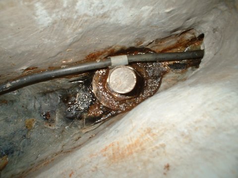

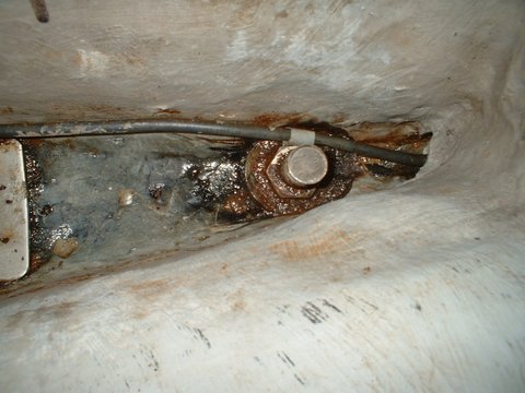

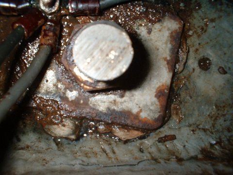

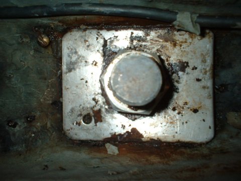

I would still urge owners to use caution. The 322 I physically measured, that lost its keel, was approx 1/4" - 5/16" thick at the keel stub. This means guys on the factory floor either ignored lamination schedules or the specs changed. It is scary to me that there is/was this much variability in these boats... 3/4" is a LONG way from the 1/4" to 5/16" I touched, prodded and physically measured in person.......
Here are a few of the pics I took.. The boat was on blocks and pics were a tad difficult to grab but the bottom line is this particular O'day 322 had a VERY, VERY, VERY thin keel stub. I did not have a tripod and could not take pics with the clamp and tape measure I had. I did my best to physically measure it. I borrowed a long reach shop clamp and clamped it inside and out where the polyurethane was still intact. The keel stub on this particular O'day 322 was a approx 1/4" thick +/- perhaps 1/16"....
O'day 322 - The tiny black wire on the right is a small Datamarine depth cable.
O'Day 322 Keel Stub
O'day 322 Thickness:
I used a long shop clamp to clamp over the thickest remaining part of the stub. I then marked it with a Sharpie, loosened it slightly, and carefully removed it. I then found some scraps that would fit into the gap. What I found was a 1/4" piece of marine ply. The remaining gap is approx 1/16" thick making this keel stucb, where measured approx 5/16" thick but this was on-top of polyurethane sealant.. Safe to say this stub was 1/4" to 5/16" thick.
This was from the O'day 302:
O'Day 322 Keel Stub
It was these pictures that created my concern in the first place. It's why I started thinking about how to keep the keel on. Even if I'm only going a few hundred miles, I'd prefer a good book, good music and cheap Italian red wine to my thoughts drifting (pun intended) to the keel.
There must be a huge difference boat by boat in construction quality and layup thickness. I removed my rule bilge pump and it was screwed into the keel sump bottom by a 1 inch SS screw. I measured the thickness of the pump mount bottom and the washer under the screw so my layup is at least 5/8 to 3/4 think. I was considering drilling right down to the top of keel but decided to wait until I haul her late next spring.
I measured everything with a good quality swiss vernier caliper. jibes138 has also given some good and valid input regards shear strength. One of the issues is the aft 3/4 inch bolt.
It's in a spot where all that is under it is 2 washers. I want to use the G-10 to spread the load more evenly across the entire keel bottom (or as much as possible) It 's certain that a large SS plate would have more shear strength so I'll consider that but don't know if the shear is the most important thing. I want to spread the load of a 3500 pound keel across as much keel sump area as possible. I will still use the 3x4 SS plates on top of the G-10 BUT, I welcome, ask for and want input. This is a great boat with one issue BUT have you ever owned a boat with no issues. (OK, I have a NorSea 27)
