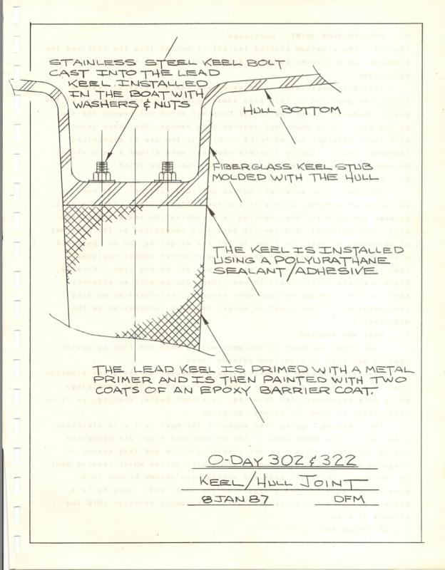

ORIGINAL KEEL SUMP DRAWING from O'Day
Yesterday I received the Owners Manual for the 322. In the manual there is an engineering drawing dated Jan 8, 1987 of the keel / hull joint for the 302 and 322.
My boat was built in Oct 86 and is different from the drawing - the drawing is by a person or company noted as DFM.
It shows the lower section of the keel sump as being about 5/8 inch thick and also shows 2 rows of keel bolts. My boat has one row 3 x 1 inch and 1 x 3/4 inch. I will also measure the thickness of my layup this coming week. But from pictures I've seen of keel sump damage on other boats doubt that it's 5/8 inch thick.
Maybe there was a design change on boats built after Jan 87. If anyone wants a copy of the drawing (I don't know how to post it here) contact me
bahamasailing at Gm^#L dot com

I'd be very interested to see that drawing, Gary. I'll email you. Also looking forward to what you learn about the sump layup thickness.

This is the same drawing that is in my 272 manual. I have one row of keel bolts. I have always wondered this: who designed the keel sump.?...I seriously doubt O'Day had an engineer on their staff in Fall River (but I could be wrong). Could this design and thickness layup have been designed by C. Raymond Hunt? And if the thicknesses & design are adequate as shown, were the boats actually built with an adherence to the original design intent ? On our 272 everything has been fine since we bought the boat
new in 1987, although I do look it over each fall when pulling it out for the winter...Pat
