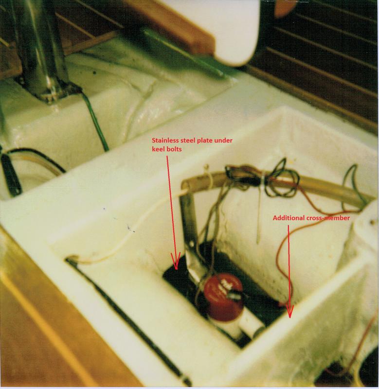

The owner has kindly sent picture’s that show the modification and additional cross beam.

This year happens to be the 20th anniversary of our near disaster when the wing keel ripped through the hull.
Looking for the drawing of the replacement support plate I found other documents, invoices, etc., in other words nearly everything but the drawing. I remember it was shaped to the area of the four keel bolts and nuts.
I couldn't locate any response from the Hunt company but I still recall their reaction to my criticism of the keel support design. Vogel Marina, at the time in Fairlee Creek, recommended the additional glassed layers and the cross member support. I insisted on the full metal plate to replace the “washer” style backing plates on each individual bolt. Hunt’s, later, vehemently defended their system. Honestly, I can’t recall if I communicated with them or if they replied to my comments on the Internet.
I attached 3 photos. One is from a Polaroid taken by Vogel in 1994 after the completed work and the similar one was taken recently with my iPhone. The third offers a poor glimpse of the full backing plate just below the water in the bilge.
Hope this helps.
I’m going to revert to remarks I made in the post “322 Keel Retention” from about 4-weeks ago. I think (but can’t) confirm, that the 322’s built after the Leveraged Buyout may have used a different layup schedule in the keel sump than earlier boats that probably followed the C. Raymond Hunt design.
My keel sump bottom is 3/4 inch so I feel reasonably comfortable. I am going to make the full plate instead of individual plates at each bolt. I’ll also add the additional cross member.
I think the extra layers of glass aren't beyond the skills of the average owner and that should keep these great boats going for other 30-years. I agree with everything that is in the Boat Review above. This is a fabulous boat. If you aren't out in big water, it’s probably a matter of keeping the keel bolts properly torqued (not over torqued). I bought a torque wrench and sockets so that’s now part of twice a year check.
Hope this helps.
