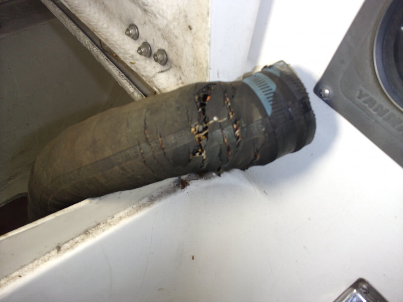

Sep 25, 2018
10
hunter 27 tall menominee marina Michigan
MAJOR leak found!!!! it's was the exhaust hose as shown, split out on the backside,,so it wasn't until I grabbed the hose, that I found out quick what the problem was,,,

That’s great news. Way easier to replace an exhaust hose, than to deal with some of the initial scenarios. It looks pretty old and rotten, maybe original.
24,844
It is again an example of careful examination is better than guessing and trying to solve the worst imaginary problem.
Congratulations.
Thanks for the picture and the update.
Good thing you found that. Exhaust gas could be fatal.
