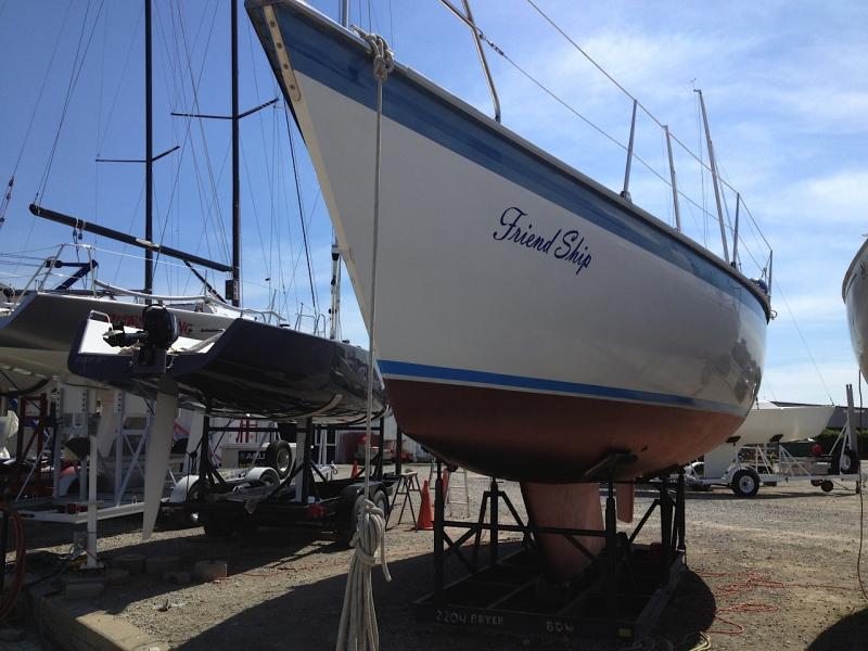

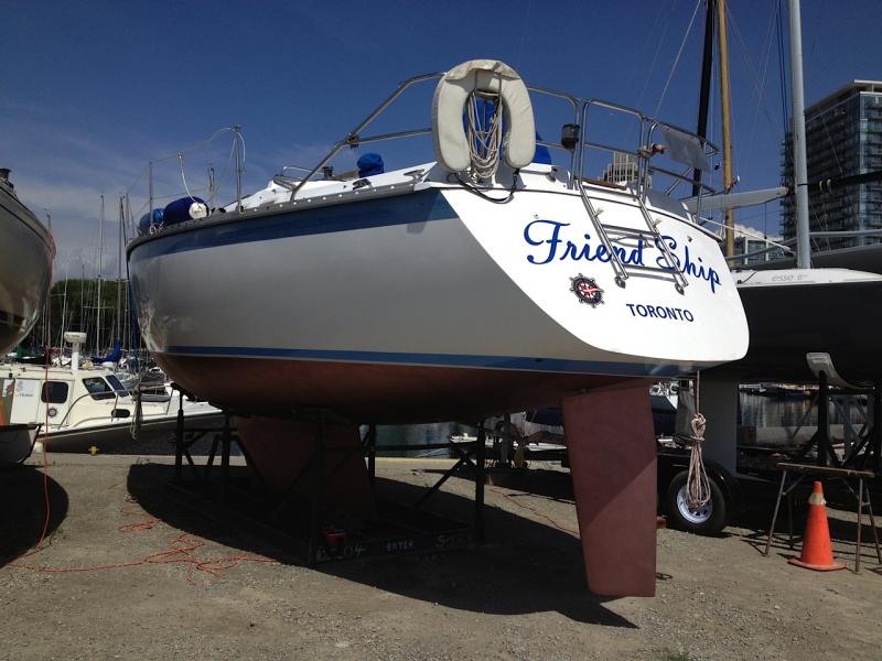

I set out to do this job including the whole hull ,a year ago this past summer. Initial plan was to soda blast the whole thing. Splax is right, soda blasting is not the best choice. My contractor turned out not to have a big enough compressor to do the job. We went to a needle gun. Did the job but took a while. I immediately coated it with a rust converter, then a coat of IP 2000. Then faired with an epoxy fairing compound then 4 more coats of IP2000. Use different colours if you can as it is easier to tell where you have been.
Keel had a couple of very small spots when I hauled out fall before last- dremeled them out and filled with the fairing compound. No spots this year when hauled out in Oct. This is what it looked like when launched after the work.
