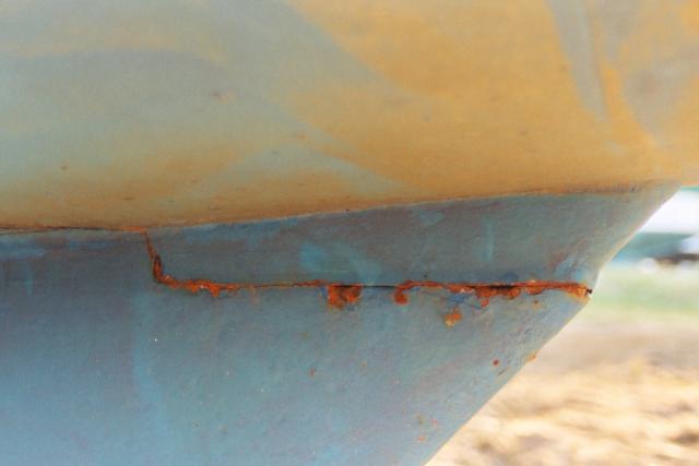

Keel prep before bottom paint
Dubo
Oct 26, 2010
86
Hunter 340 Deltaville Va

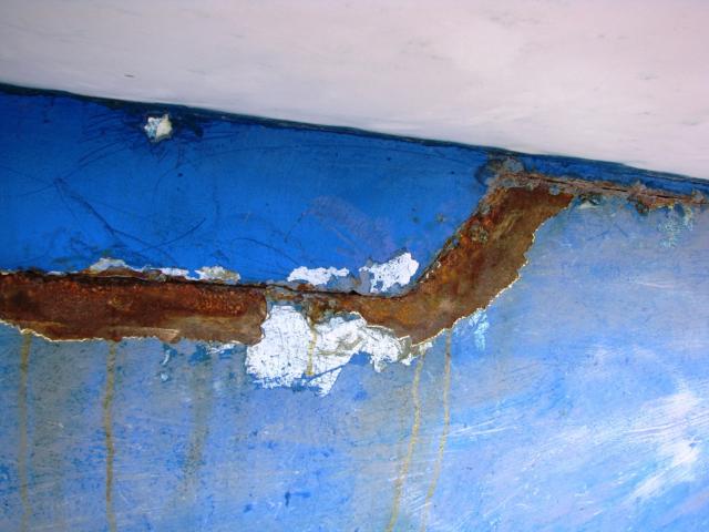

I have finished stripping the bottom paint down to the gelcoat on my 87 31' Hunter. When I got to where the hull meets the keel rust appears to have occurred. I chipped some of the gelcoat on the keel away to remove most of the lose stuff. I will grind the exposed iron and the gelcoat a bit so they have a good tooth for an epoxy coating. There seems to be metal on metal where the keel meets the hull (see pic). My question is, what is the best way to prep the exposed keel, especially where there is a slight channel at the seam? Do I excavate the rust or apply something like naval jell? Also is 4200 or epoxy best to fill the seam?
I will be fairing epoxy where I chipped the gelcoat away to build it up again.
TIA,
JD

Hey Dion, you had one of these H31s. What do you make of JD's keel? I have never seen anything like this keel to hull joint. Is that 'S' curve metal to metal?

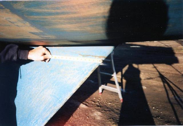

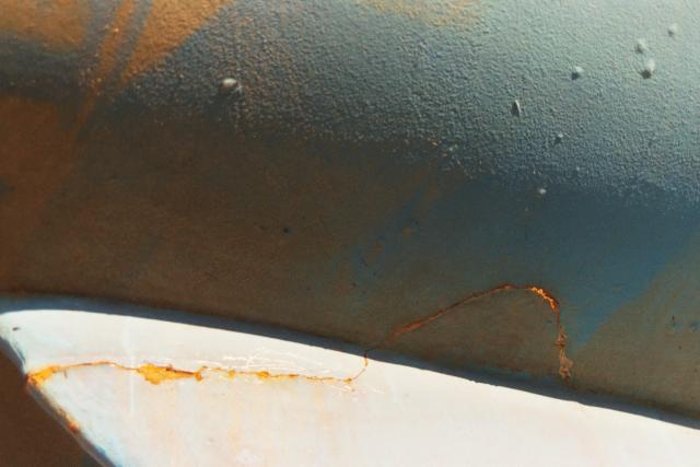

On our Hunter '93 30T we have rust--actually a six or seven inch line of rust--where the keel meets the hull. Every year I scrape it off and repaint, and it always comes back. My question is: Is this just a cosmetic issue or is there the possibility of damage, like the keel falling off or something like that? We're in fresh water--Lake Ontario. (Too much fresh water this year!)

Hey Ed S...

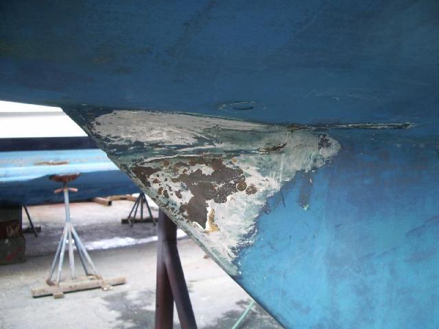

Attached pic is what the forward edge of my hull/keel joint on my H34 looked like when I bought the boat.
It's not as advanced a condition or as wide a gap as Dubo's, but is quite common in the early to mid 80's H31/H34 models with the steel keels that Hunter used.
Clean out, fill with epoxy filler, smooth, seal, and paint was what I was told to do to resolve the issue.

You have the ol Hunter "smile". I use POR-15 on my keel iron. It has worked out well and each year I have less and less of it to deal with. Google it- comes in a small kit- a Marine wash, a primer prep and the paint -n finish coat(grey) which dries and hermetically seals the area. But you need to paint over the top coat as It doesn't do well in long UV exposure.

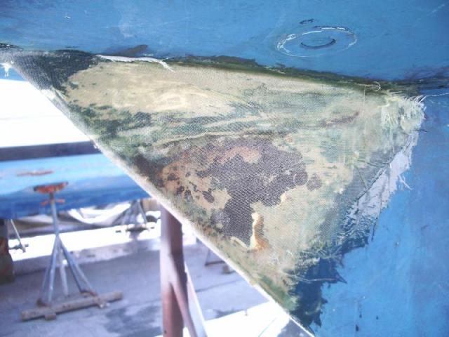

1,715
Hunter 34 Alameda CA
Four Years Later

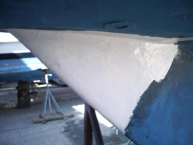

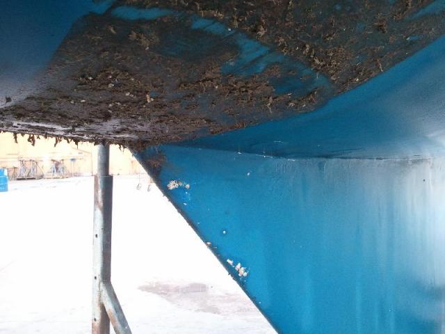

We just finished our haul out. This was one of the easier ones...just took from Friday to Monday.
Back in 2007 we decided to address the "smile" on the leading edge of the keel once again and hopefully for good. We ground everything off the keel to bare metal around the crack feathering into existing barrier coat and stripped the paint off the fiberglass adjacent to the junction. After allowing a clear coat of West Systems epoxy to get a bit tacky, we applied two layers of glass cloth, followed with more resin to just saturate the cloth. We used a plastic scraper to squeegee the excess. After curing overnight we applied two coats of Interlux 3000 barrier coat (allowing 3 hours between coats). This was followed with our usual 2 coats of bottom paint.
The final analysis was when we hauled out Friday May 20, 2011.....that is the last picture. For the first time ever, no crack. It looks like our repair held. What a relief.
Allan
Oct 14, 2005
2,191
Allan...
Nice repair job! I'm letting the paint slough off the keel again this year by not painting it so that I can have an easier job of taking it down to bare metal to refinish it next season. Your solution's pics will help with next year's work. Thanks for sharing...
